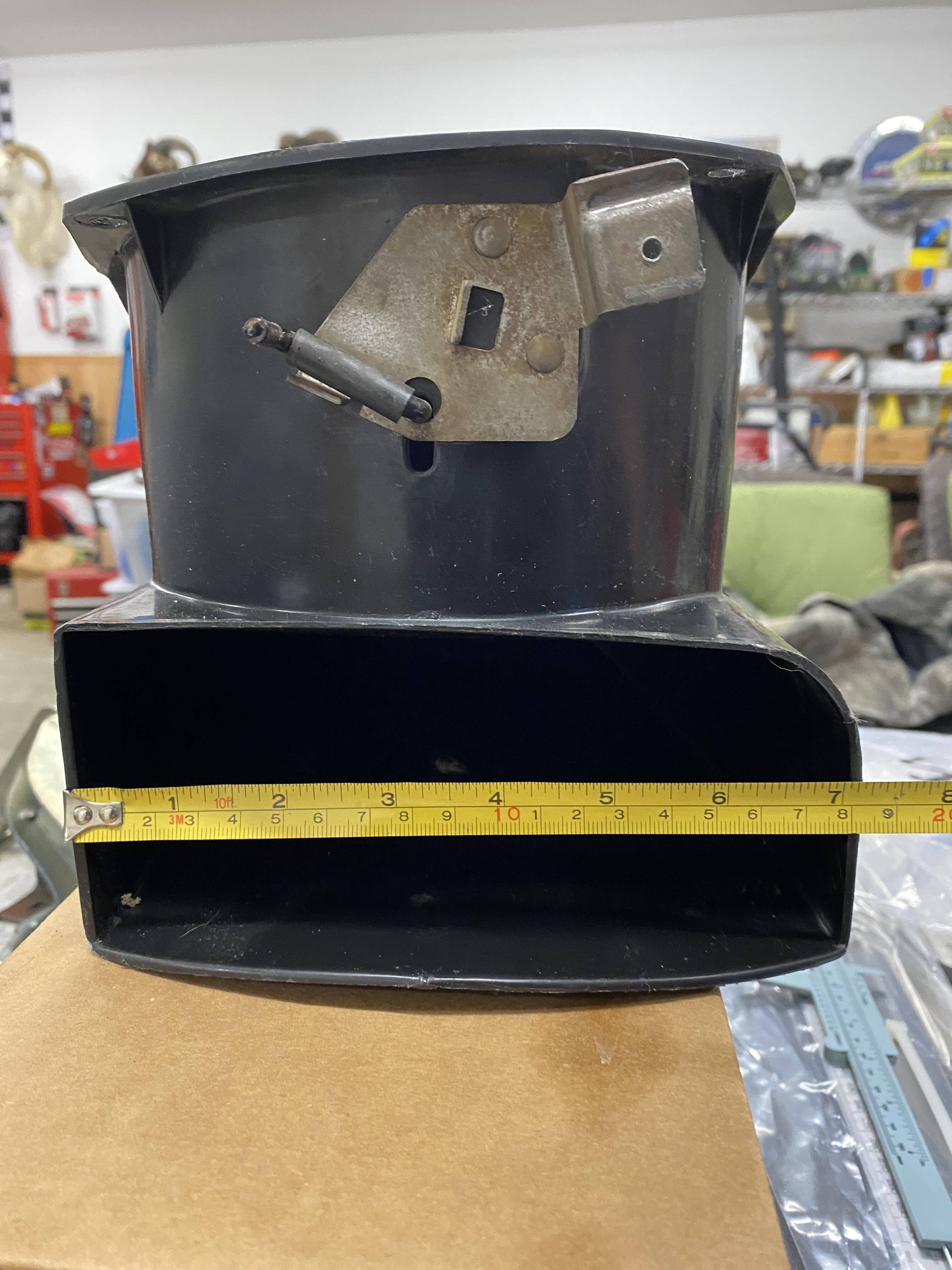

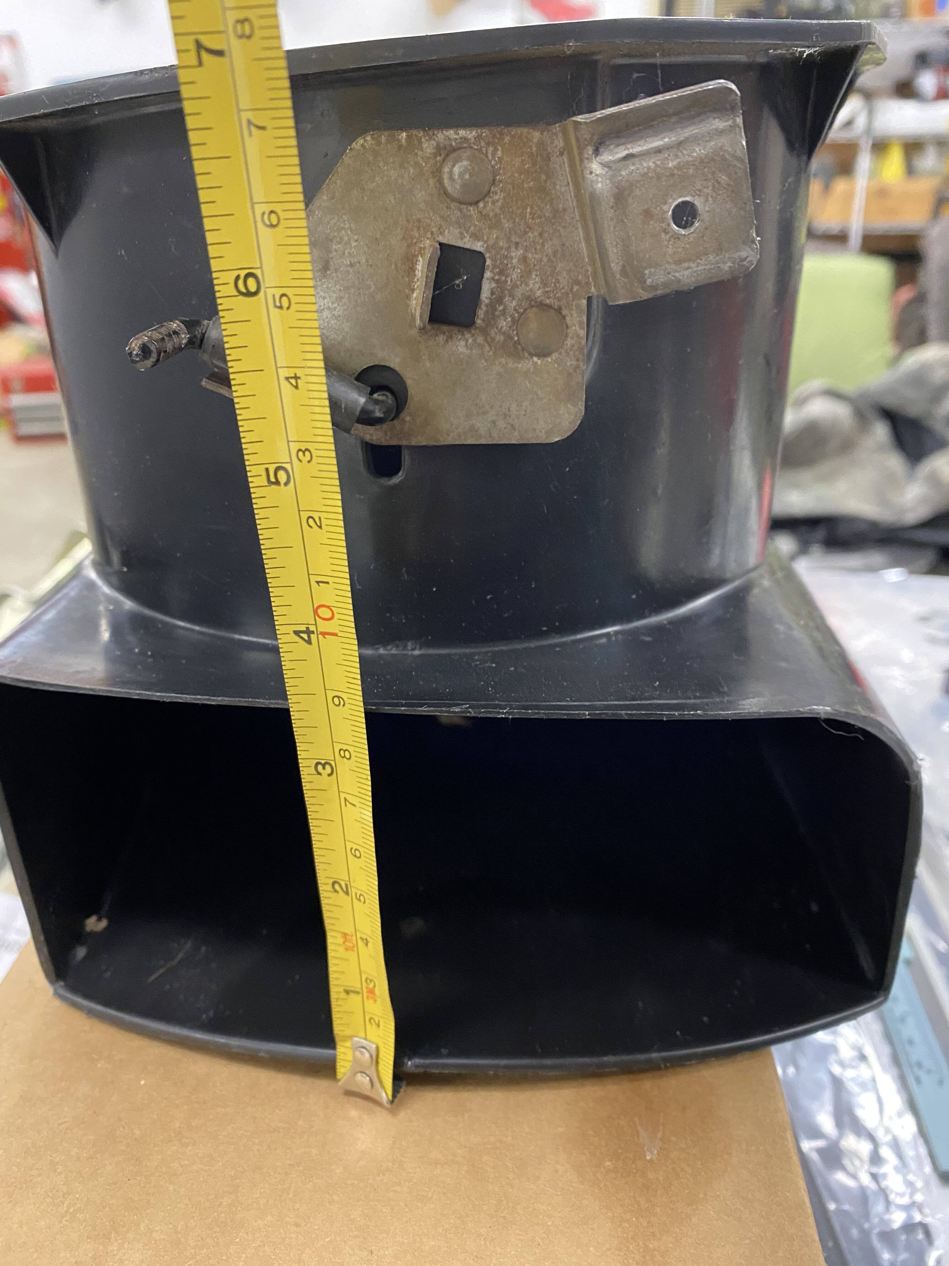

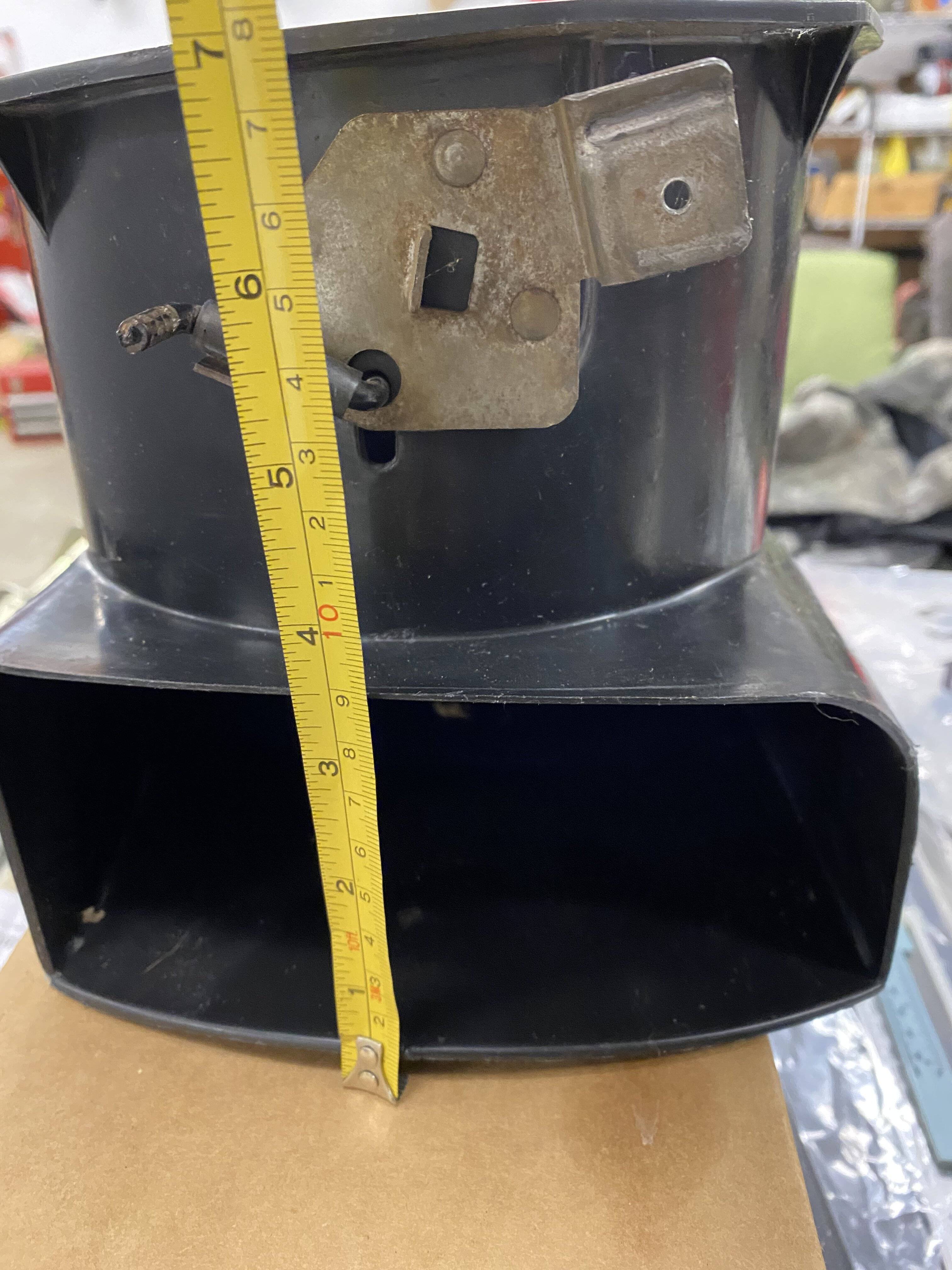

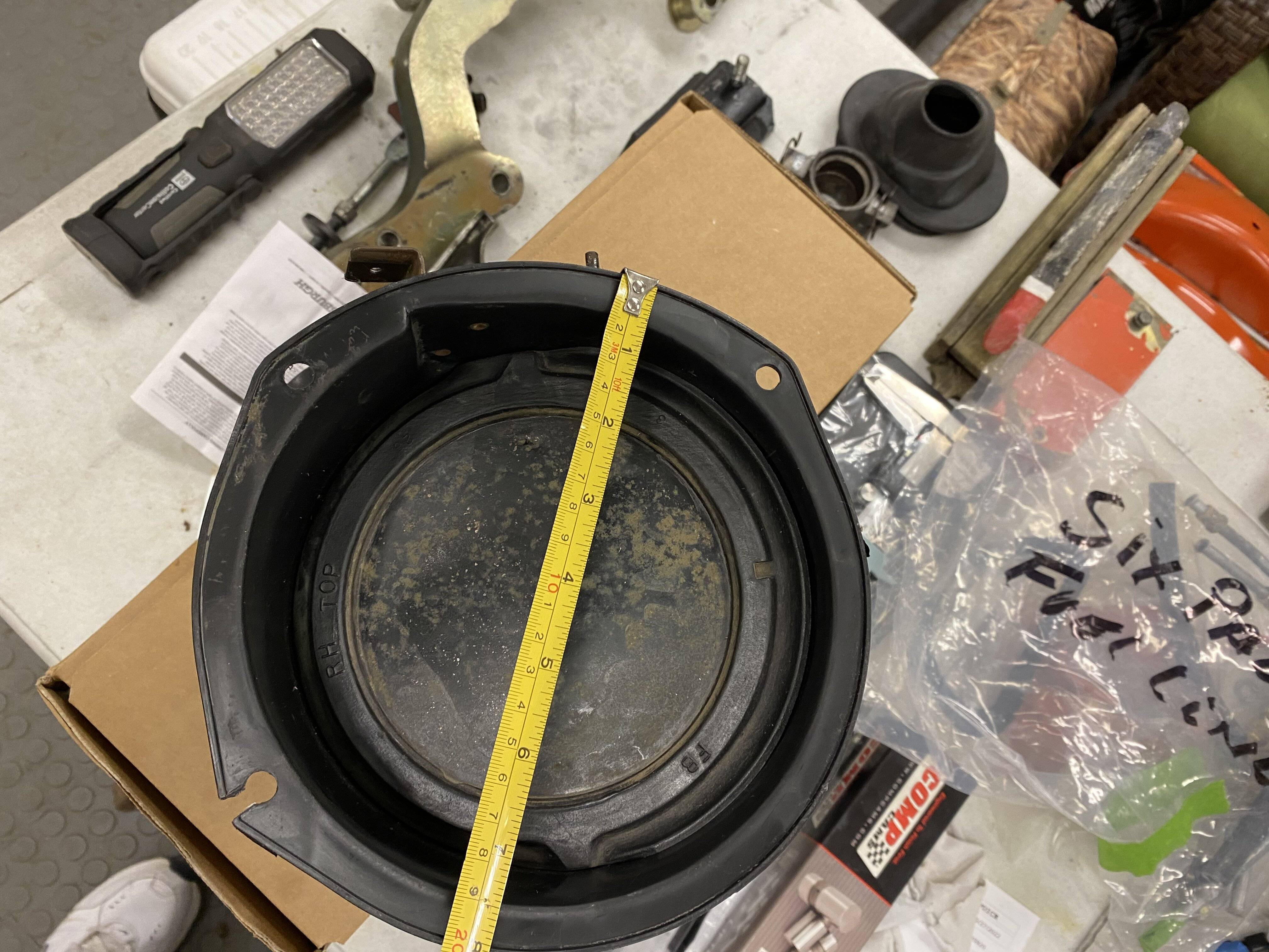

Here’s some pics of one I had in the shop.
The part# is 2936644 also, has 68579 under the part#.
Might help?
