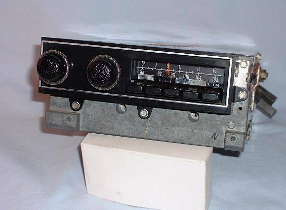

This should really help you identify radios
The one on e bay is definately a 72-74 radio but NOT an e-body radio
The e-body radio would have two "studs" on the bottom/ front of the radio
How To Identify E Body Radios

The 72-74 am-fm radio would have black buttons.
The 70-71 radio am-fm would be the thumb wheel.
Look at the bottom of the correct radio; showing the "studs" in front bottom of the unit.

C bodies have the studs also. You need to have the rectangle and then the square on the bottom.
