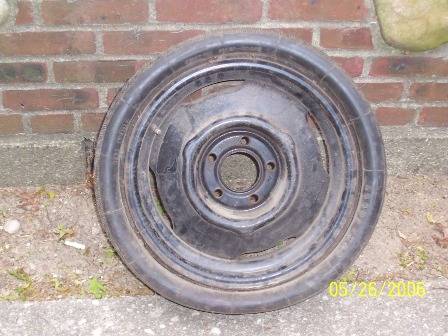

"Space Saver" I have one from a 79 Dodge Magnum, different rubber tread, same idea.
no, you can not purchase them new as far as I know.

OH, my spare is a 15 inch rim and the stock tires are kind of big/tall. Currently, I'm running 245/15/60's on the Magnum. Speedometer didn't need a correction. That would be a tire diameter of approx. 26.6 according to the BFGoodrich site.
rim width --section width--daimeter---------revs @ 45mph--max load
7 - 8.5---- 9.8 on 7-------- 26.611-- ----------782 ----- 1753 @ 35 psi

Below, from my B body. 1979 Dodge Magnum.
