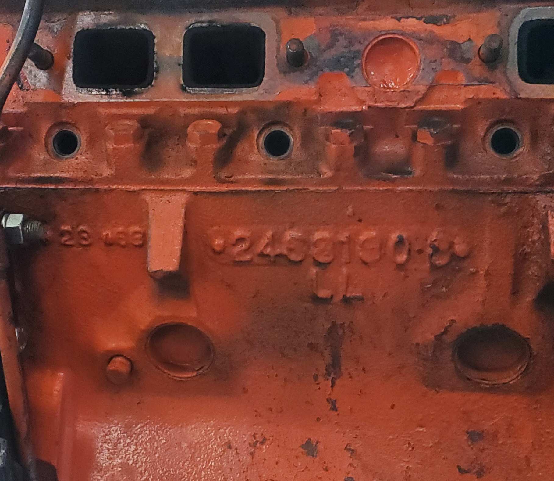

7DCUDA383A
I know what the main casting # and LL mean but the 4 numbers to the left not sure .
Thanks PsychoDate , XX.23.69

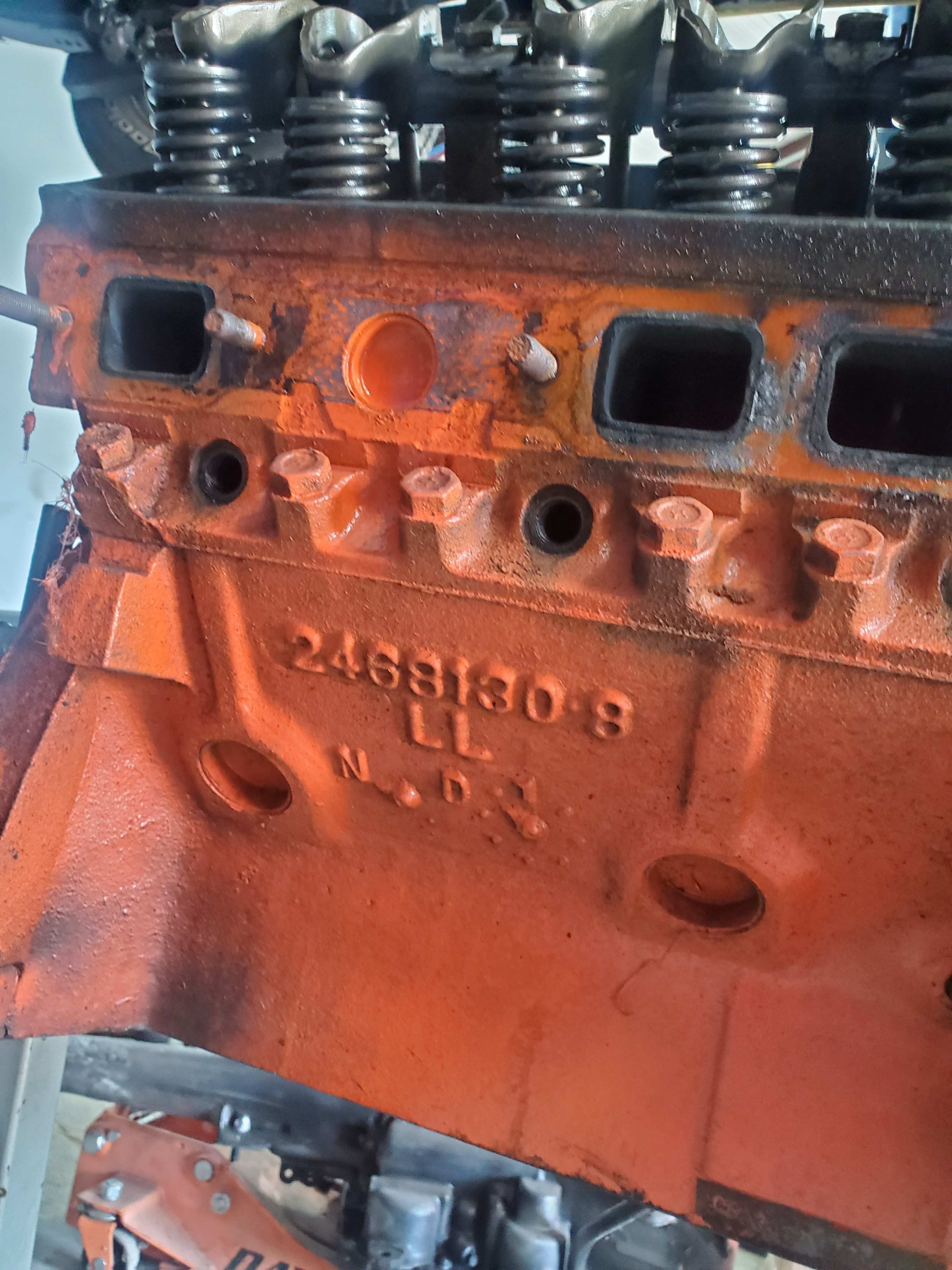

That's the actual date it was casted. There should be another cast in showing D for day shift and N for night shift with a little arrow pointing to the D or N.
