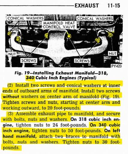

Great ill use the moroso and ill use the oil with the zinc 2 things I can cross off the list. Does anyone have a right side and left side pictures of the exhaust manifolds installed on a engine im putting my original exhaust back on and not sure of the placement of all the bolts and washers I think the kit I have gave me 10 washers? Also what should the torque be on them ? is there a sequence?

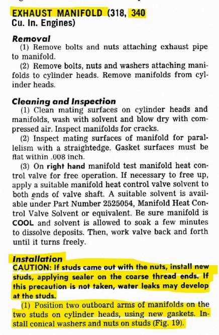

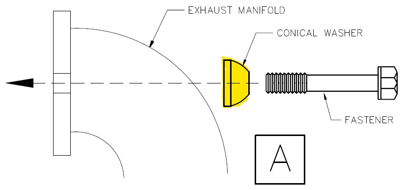

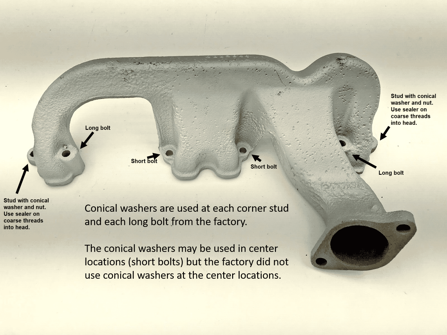

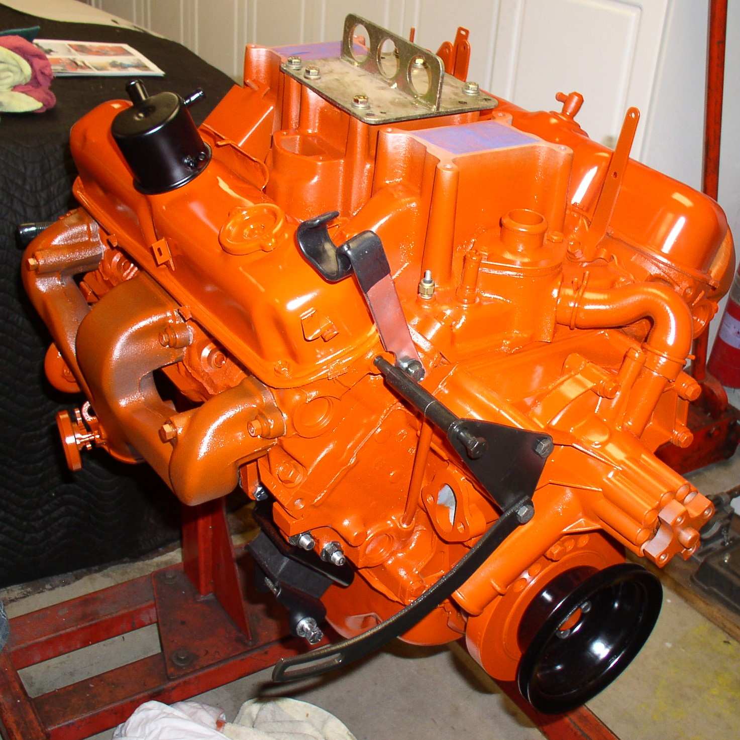

Kenny,
The 340 exhaust manifold hardware kit comes with ten (10) conical washers but the factory did not use the conical washers at the center short bolt locations. You can use conical washers at the center locations if you want to spread the load. The six (6) studs are used at all four corners plus the two sleeve bolt locations. That is why you have six studs in the kit. The coarse thread goes into the cylinder head. Use some sealer at the stud locations to prevent coolant leaks.
You will not need conical washers at the two factory sleeve bolt locations on the passenger side manifold.
You will install four (4) short bolts in the center locations, two (2) on each side (and use conical washers if you want).
The factory service manual info is below. The bolts and nuts are tightened from center outward and are 20 foot-pounds.
***Do not get confused by the service manual's step 3 as it is talking about the manifold-to-head pipe bolts which are a higher torque value.***
I added the last two pictures with stud/bolt locations for reference.

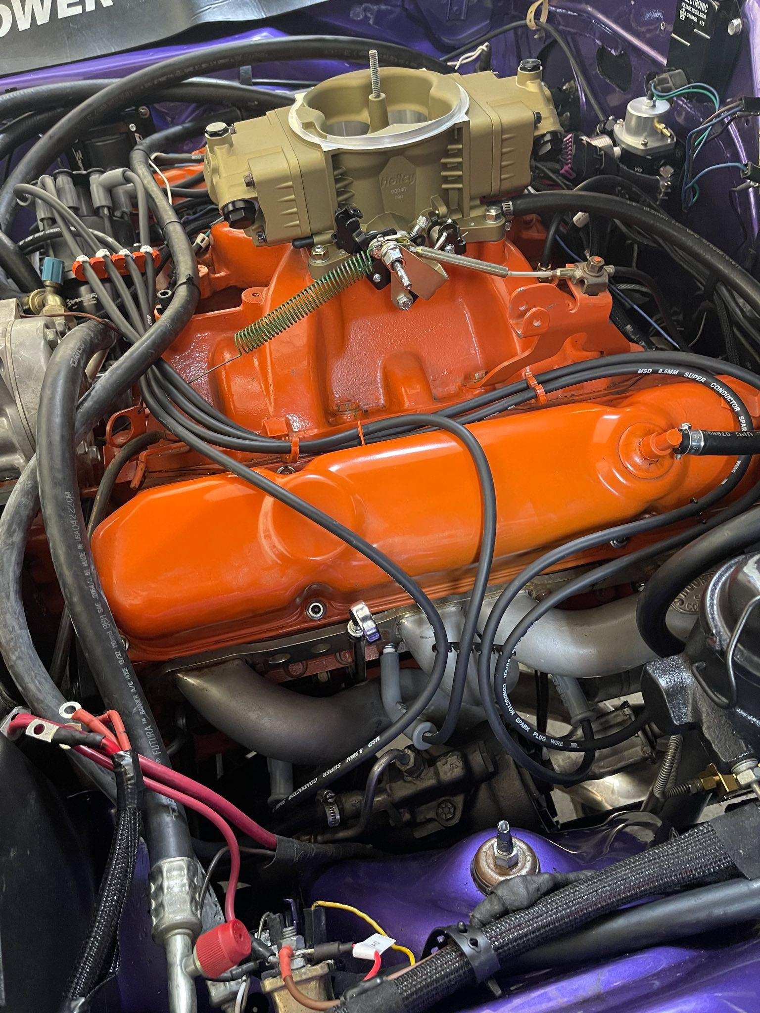

Note that the blue Moroso valve cover gaskets are designed for installations having a flat surface on both sides. Heads have a flat surface, but original valve covers do not. If you have aftermarket valve covers that have a flat surface where it comes into contact with the gaskets, you're golden. Anyone tried the blue gaskets with stock valve covers? I have a set of these gaskets, but didn't use them because of this. The really nice thing about the blue Moroso ones are that then can be reused over and over again.
I have used the blue Moroso gaskets on my 440 stock valve covers for years. No leaks or issues. Highly recommend them.
