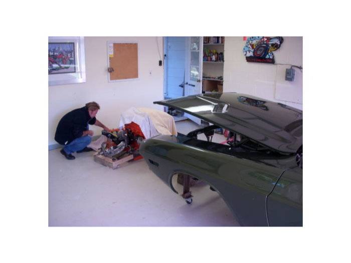

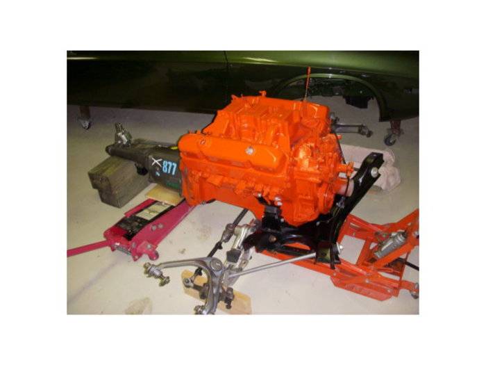

This video shows the process on a B-body but the same principle applies for the E-body. Rollers for the rear attached to the forward rear leaf spring mounts and an extension mounted to where the front bumper bolts on to the frame for an engine hoist to lift from. Having at least one extra person on hand is helpful but not impossible to do solo...

Thanks much guys.....I have to get creative and figure how to build/buy the engine/trans dolly and the cherry picker lifting frame.

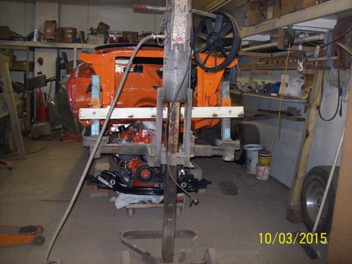

Here's what I used to do mine, floor jack and motorcycle jack only plus 4 guys total. 2 sat in the trunk to make the front light and my friend and I lifted the front of the body over. It was surprisingly easy.

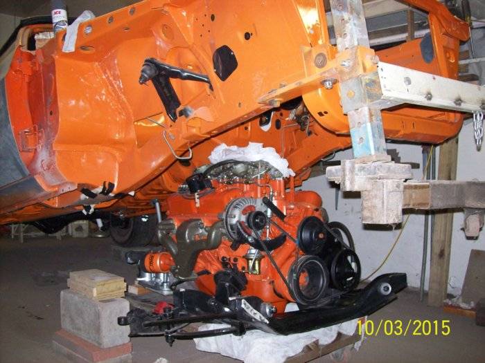

An easy way to align the k-frame holes is to just use strings with preferably plumb bobs or any small weights attached to the ends about a foot long and align the weighted string ends with the K-frame holes when lowering the body over the K-frame.

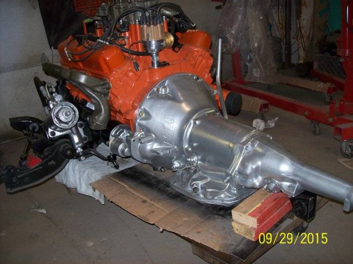

I built a dolly out of 2x4's and 2x6's scrap lumber, I was given a old pneumatic frame/bumper jack along time ago, I used that to lift the car off my blocks, I could have used my engine hoist also. I also left the rotisserie front mount on the car If your drive train is on a dolly it is not too difficult to line up the k frame bolts, and adding the string with a weight dangled near the bolt holes make it a little easier.
