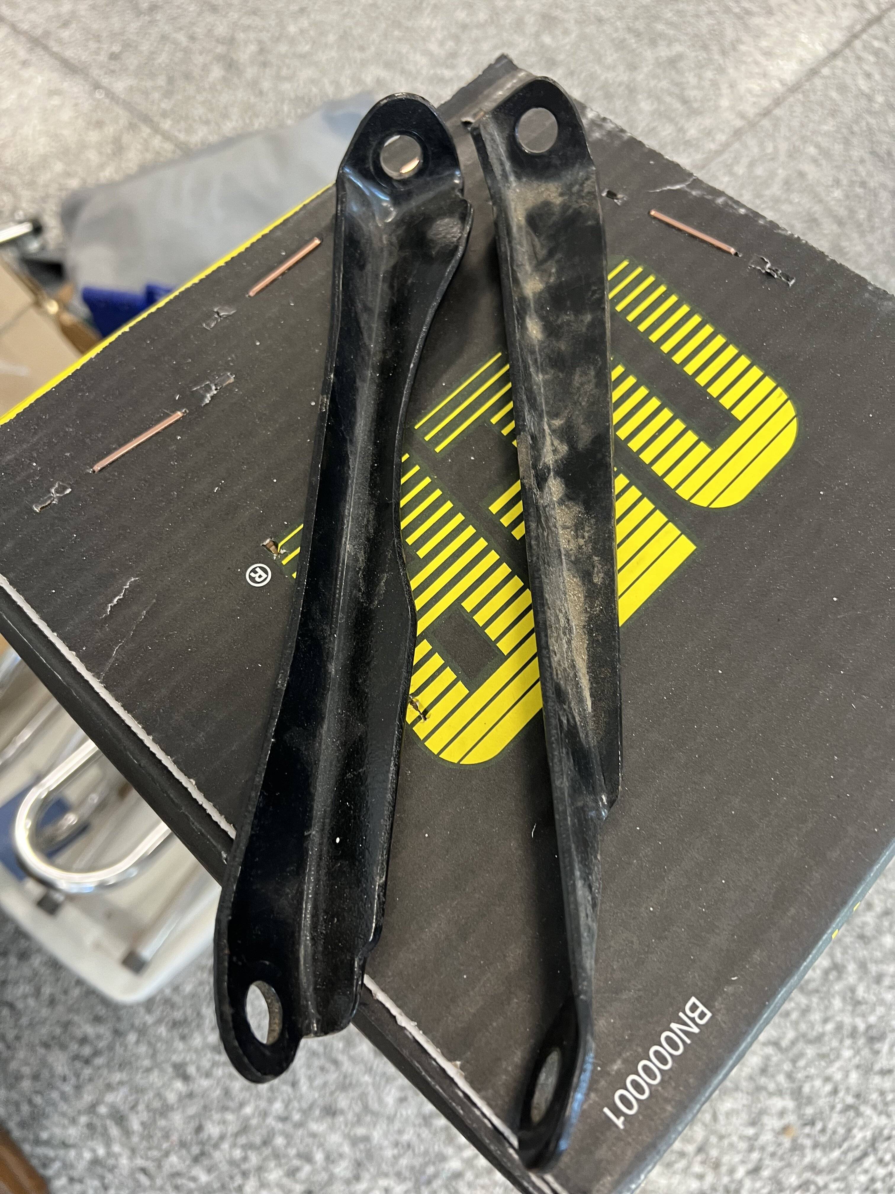

Can anyone share a pic on where/how these are installed 72 Barracuda.
Thanks

The end with the 90* bend goes to the auto trans bell housing and the flat end goes to the side of the block, there is a threaded flat boss on the block one on each side they act as a brace from the motor to the auto transmission.
If you put the flat side up to the block it should be reasonably obvious how they attach to the bell housing thru the threaded holes in the bell housing

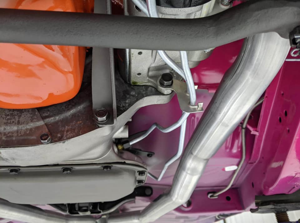

Left-hand side (Driver's side) Automatic Transmission Support bracket.

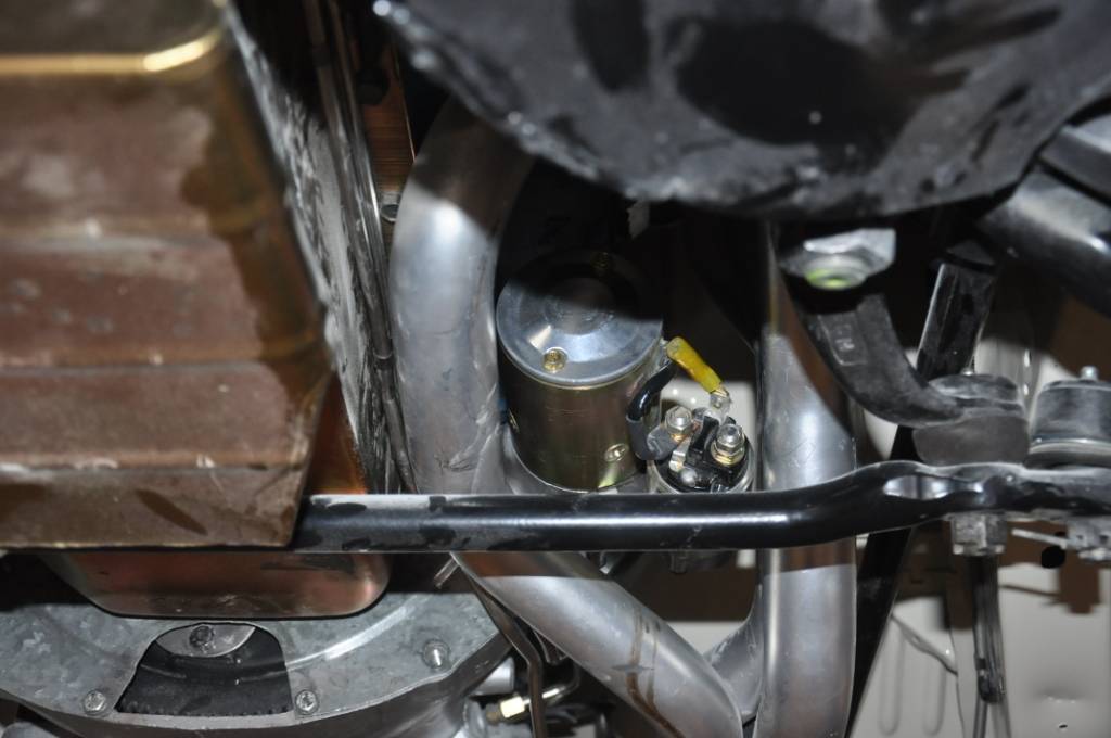

TTI headers use that space between the starter and the block for one primary tube.
