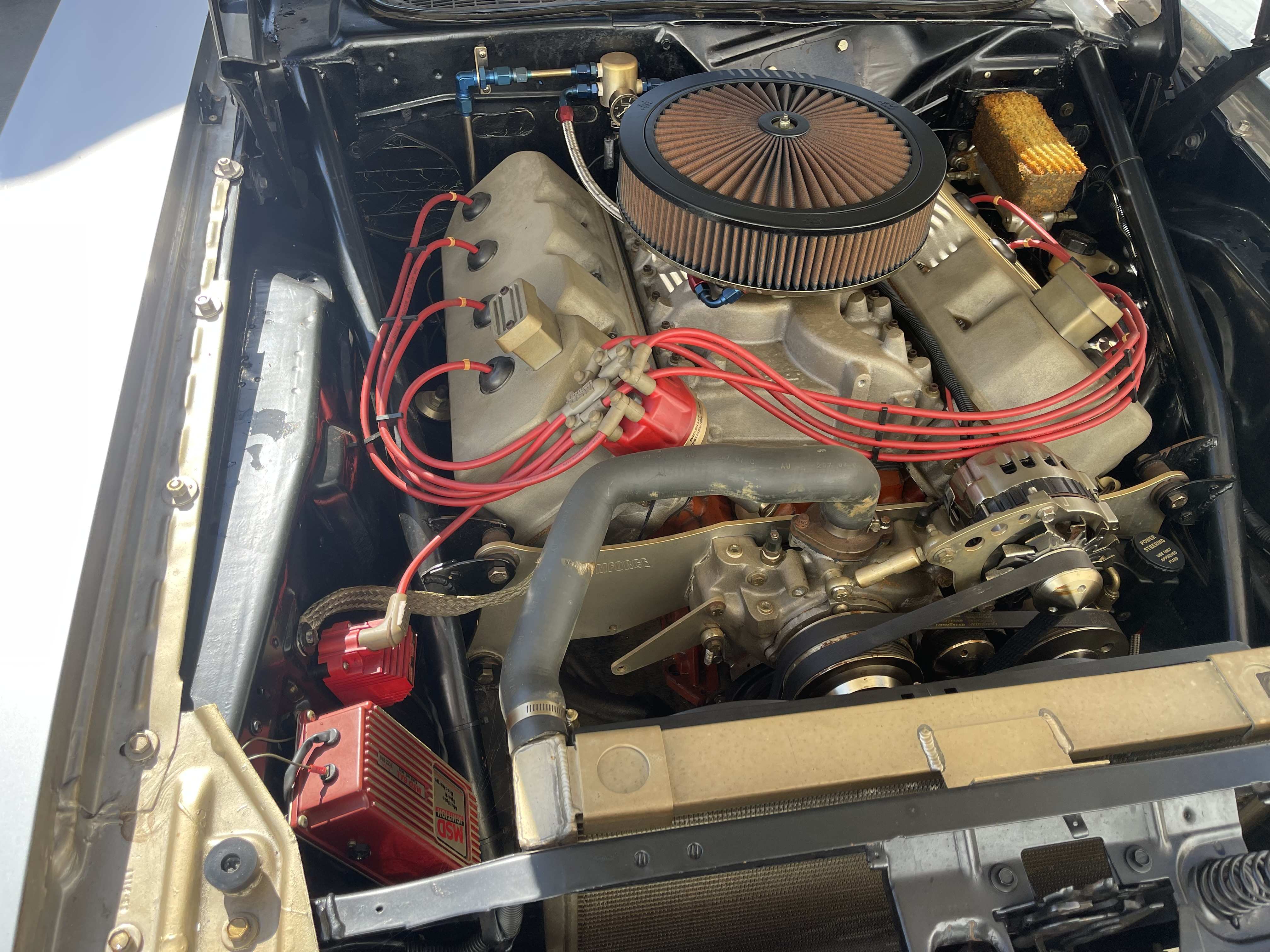

I love my TTI headers on the hemi, they flow so nice and easy to service.
Check out my video on the sound.
