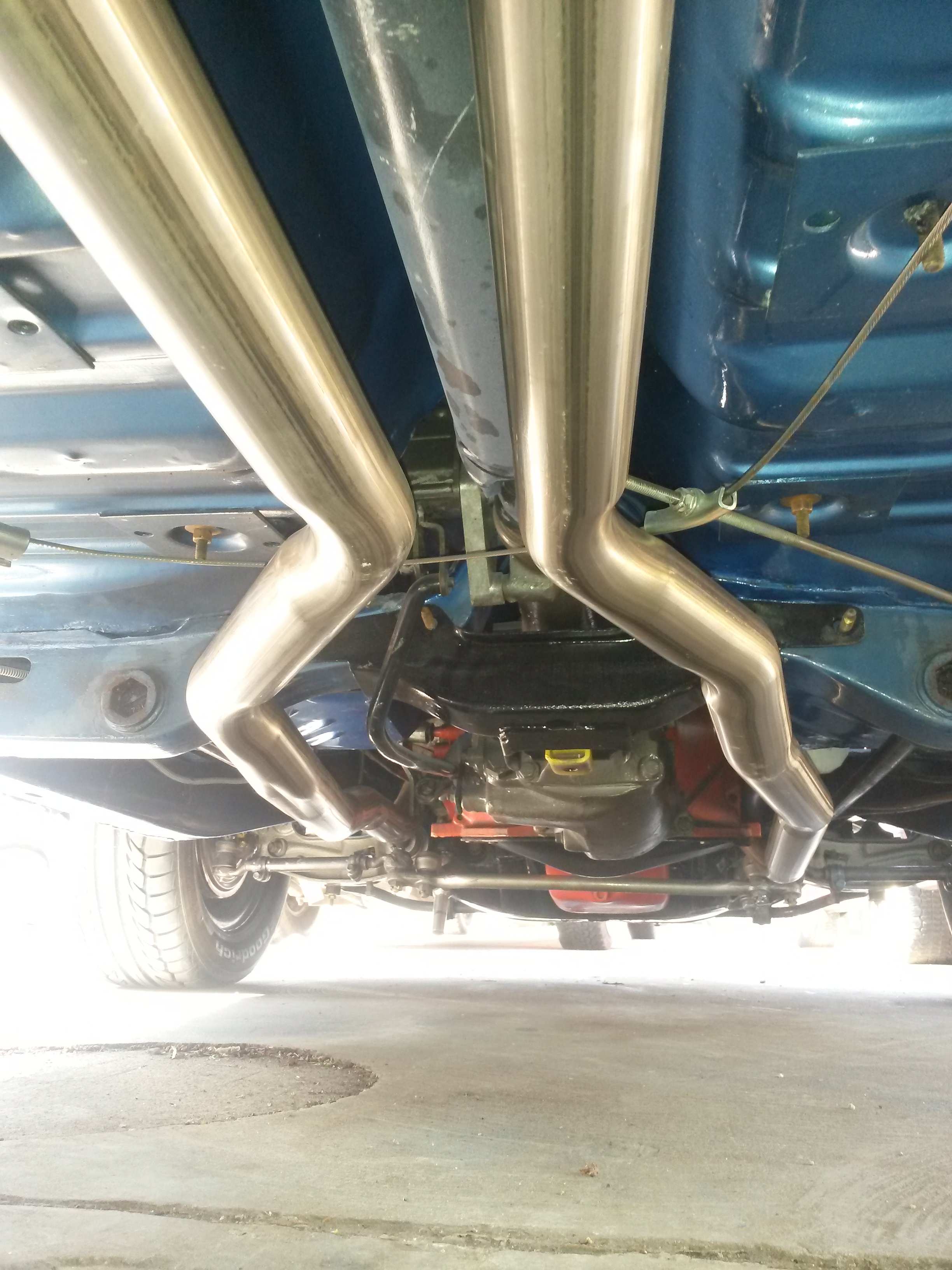

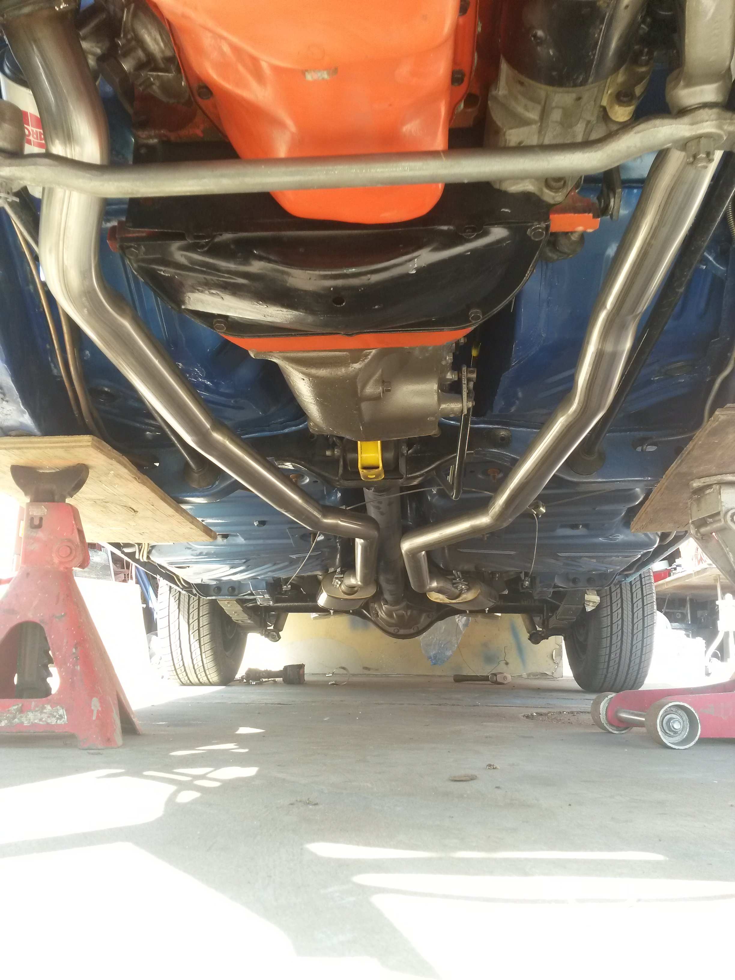

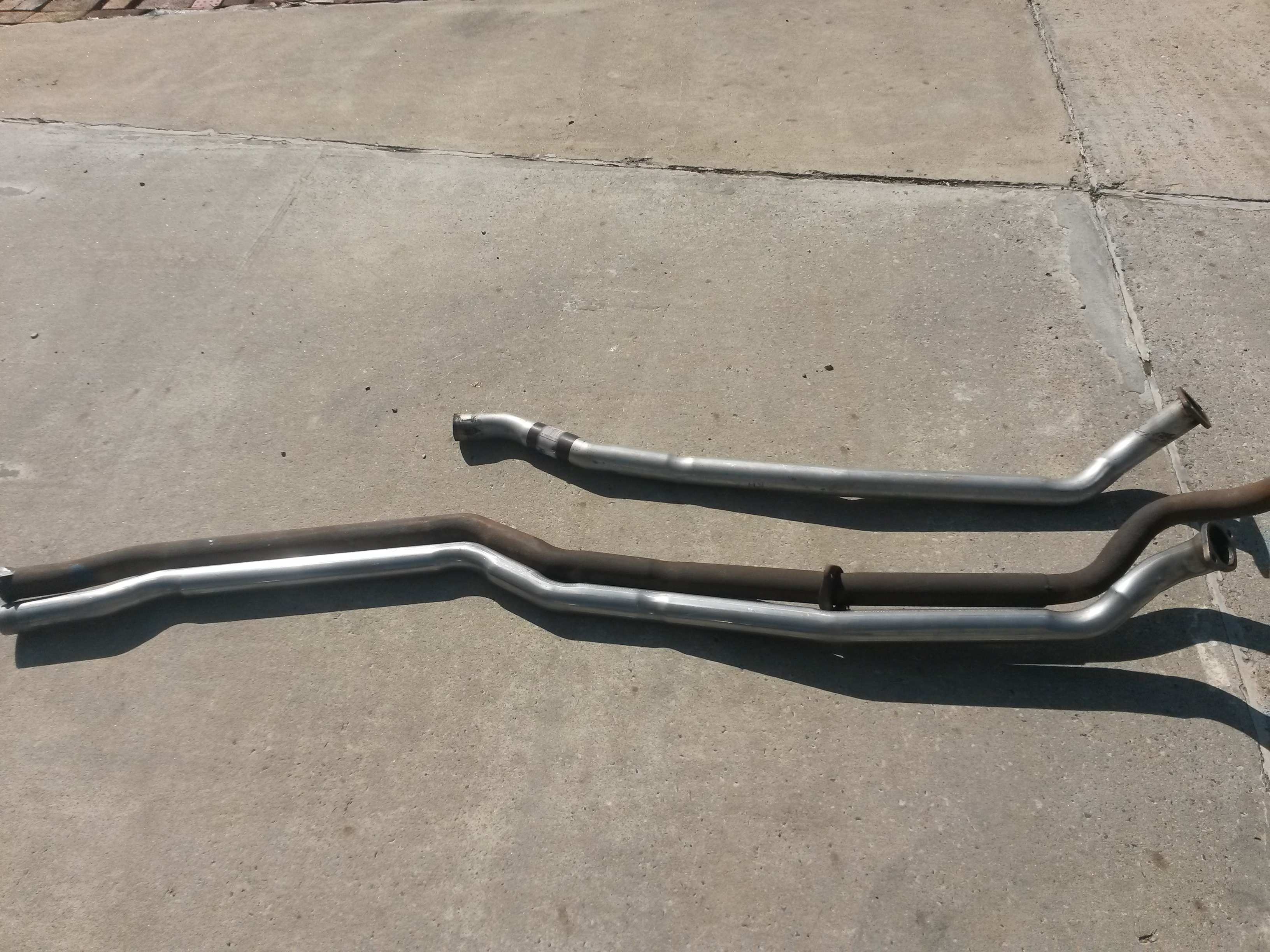

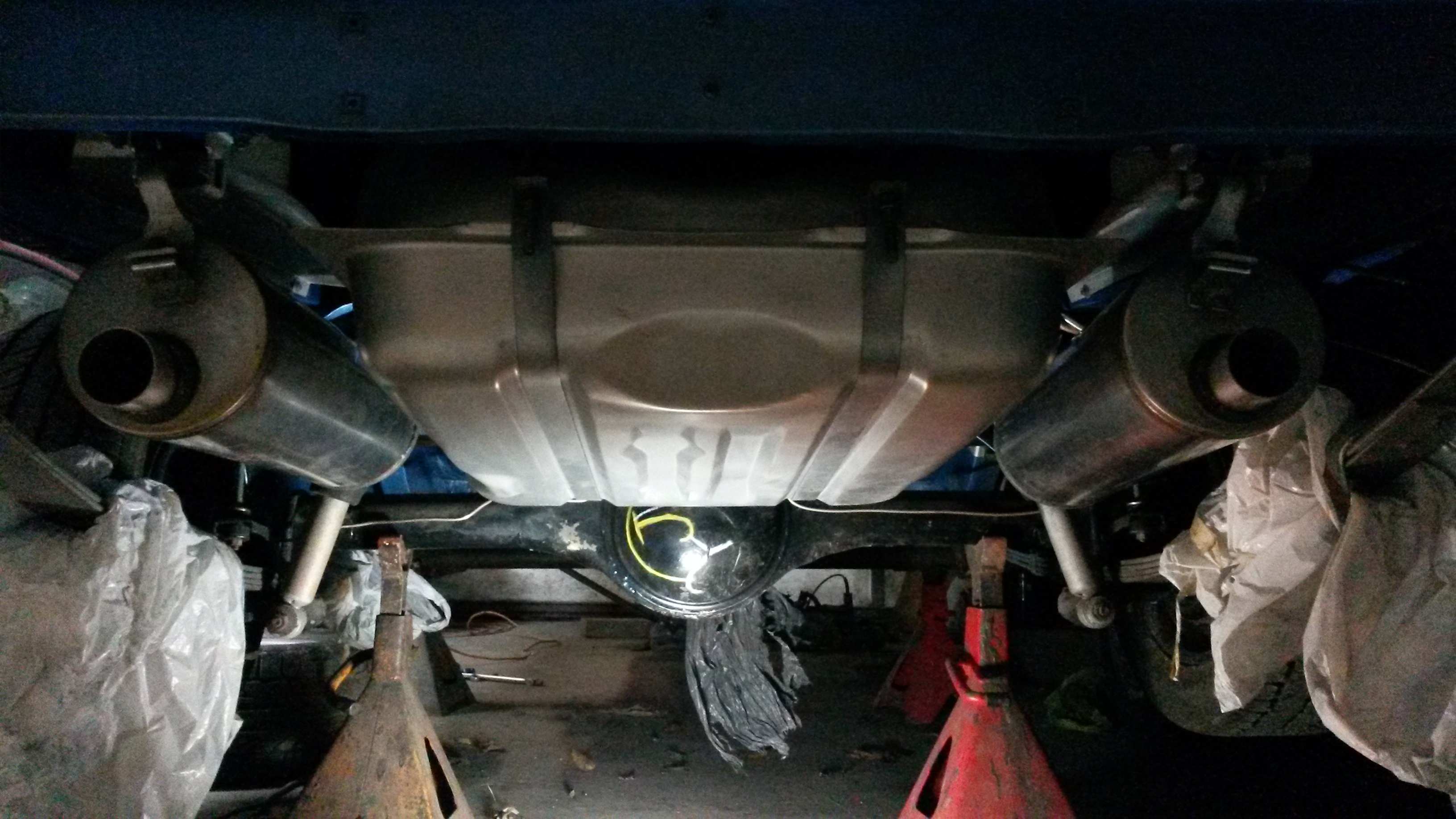

I used ECS for the head pipes. SS $550. Give them your manifold number and they make the pipes to fit. Bend for bend on the money as the picture shows. Accurate for the muffles and resonators magnum series SS $600. Over axle pipe I found aluminized. $150 Prices approximate 4-5 years ago. Today I think your looking at $1500. Yes.

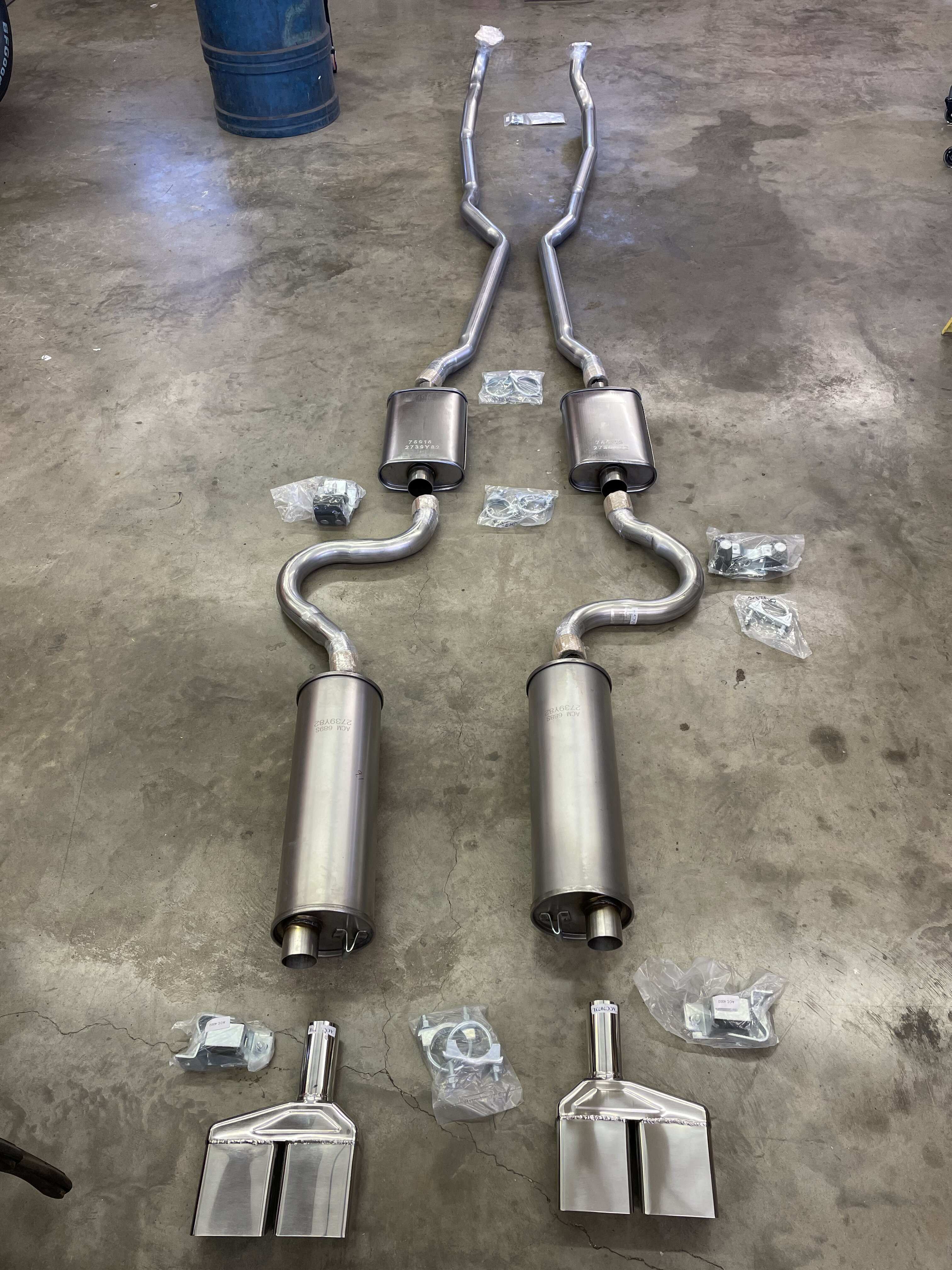

I used Accurate Exhaust complete OE correct system on my Challenger. Exact fit complete with oe correct numbers on mufflers and resonators. Shipped right to the shop ready to install. Very happy with the results.
