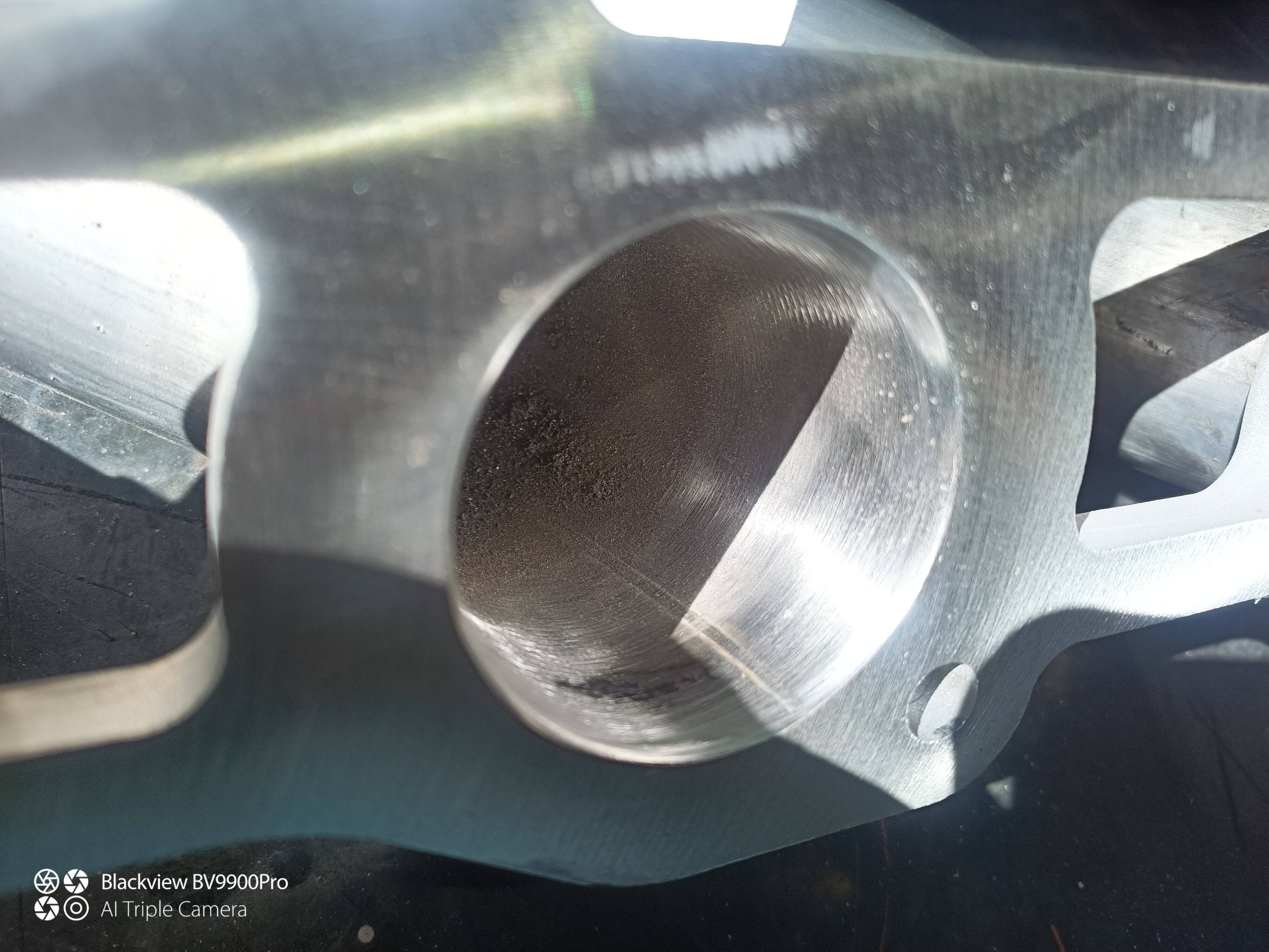

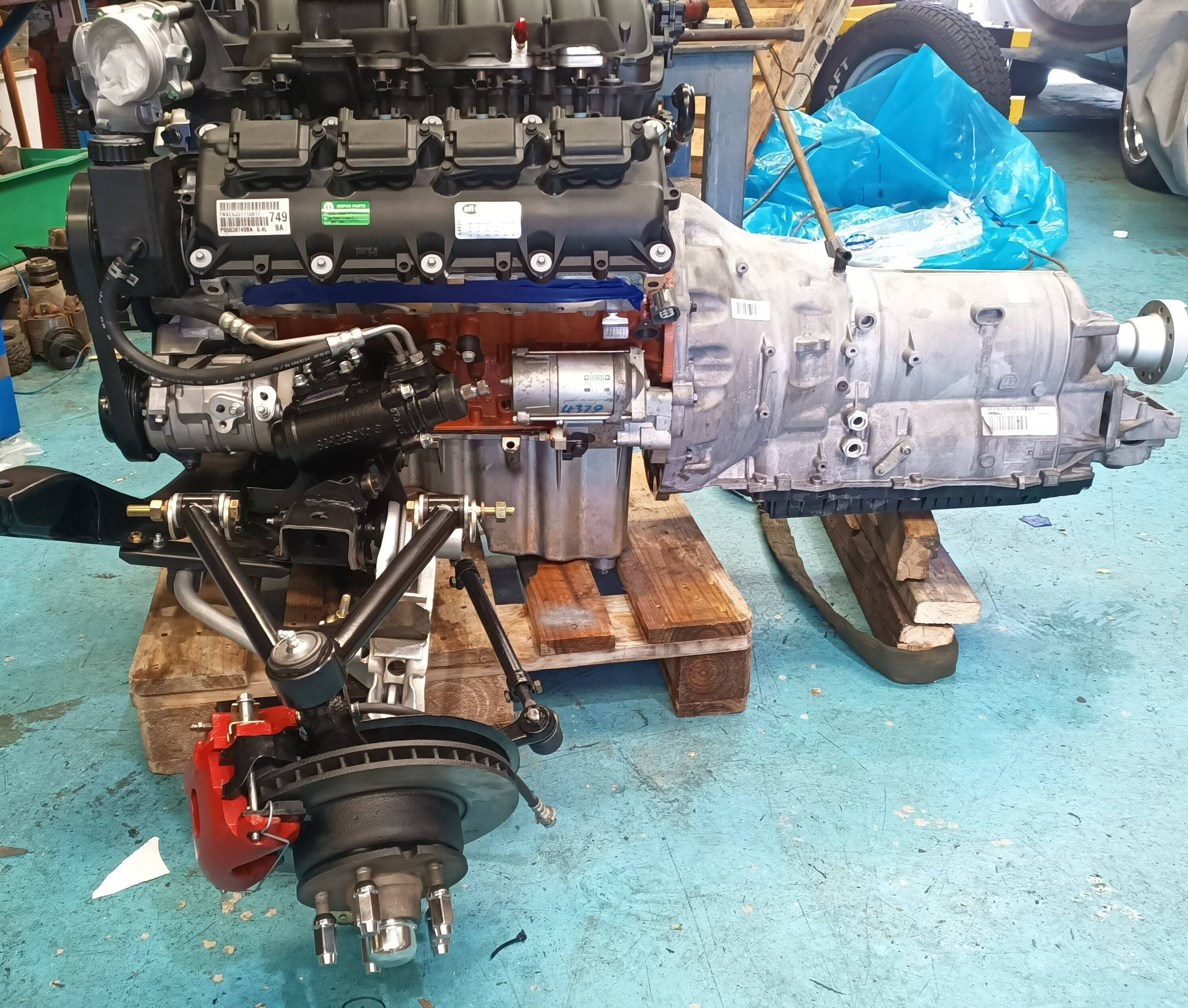

AUSTA
Apr 16, 2015
937
503
PERTH WA
Holley have jumped the gun on the Terminator X Max for the 6.4 are doing all the marketing now no stock said it will be ready Christmas now they have added another month to the delivery date also on the E-body cast sump i have ordered a HTG GCU it looks pretty bare bones you must pay extra for the harness.The Hooker header are a good fit & well finished on the weld the pipes are 304 stainless but the collectors are steel with the O2 sensors sticking straight up.The tailshaft coupler ends up in the middle of the trans the floor cross member it could be good if a CNC guy could make up a smaller yoke to fit the 8HP70 it may save having to cut the cross member support
