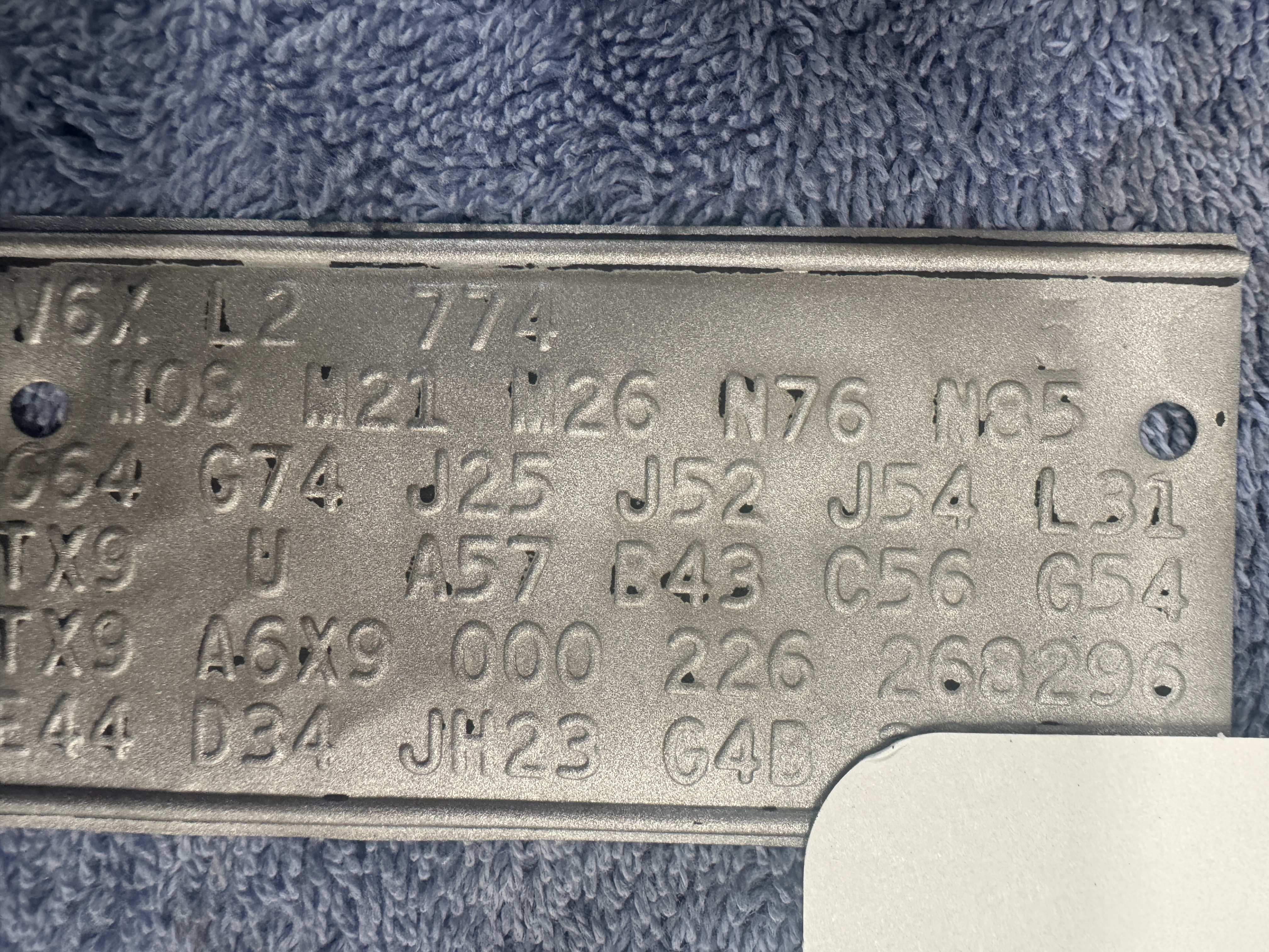

Here is a 1974 Fender tag.
Could someone decode it.

JH23:
Dodge Challenger
High
2 Door Hardtop
G4B: 318 150HP(net) or 170HP(net) 1-2BBL 8 CYL
1974
Dodge Main, Hamtramck, MI, USA
: Sequence number
E44: 318 cid 2 barrel V8 230hp
D34: Light Duty Automatic Transmission
TX9: Black (Dodge) Exterior Color
A6X9: Trim - Basic, Vinyl Bucket Seats, Black
000: Full Door Panels
226: Build Date: February 26
268296: Order number
TX9: Black (Dodge) Top Color
U: USA Specifications
A57: 72-74 Rallye Package
B43: Manual Brakes
C56: Bucket Seats
G54: Outside LH Remote Chrome Racing Mirror
G64: Outside RH Manual Chrome Racing Mirror
G74: Dual Chrome Racing Mirrors
J25: 3 Speed Wipers
J52: Inside Hood Release
J54: Sport Hood
L31: Hood/Fender Mounted Turn Signals
M08: Simulated Louvers
M21: Roof drip rail moldings
M26 : Unknown
N76: Coolant Recovery System
N85: Tachometer
V6X: Longitudinal Stripes, Black
L2: Unknown
774: Unknown
PPIHCracer
Jun 23, 2021
17
12
Colorado Springs
Bottom Row:
E44 = Engine – 318, 1-2bbl, 8 cyl, 150hp, G VIN Code, LA Engine Family, Blue Color
D34 = Transmission – Torqueflite Automatic
JH23 – J = Car Line – Dodge Challenger, H = Price Class – High, 2 = Number of Doors – 2, 3 = Body Style – Hardtop
G4B – G = Engine – 318, 4 = Model Year – 1974, B = Assembly Plant – Hamtramck, Michigan
?????? = Serial Number
2nd Row:
TX9 – T = Model Year Paint Color First Used – 1963, X9 = Body Color – Black
A6X9 – A = Interior Trim Grade – A Class, 6 = Seat Style Material – Vinyl Buckets, X9 = Trim Color – Black
000 = Upper Door Frame Color – None – Full Door Panels
226 = Scheduled Production Date = Tuesday, February 26th, 1974
268296 = Shipping Order Number
3rd Row:
TX9 – T = Model Year Paint Color First Used – 1963, X9 = Roof Color – Black
U = Build to Specs for USA Order
A57 = Rallye Package – Sport Hood, Black Grille, Simulated Fender Louvers, Heavy Duty Suspension, Rallye Instrument Panel – Type 7, Longitudinal Sport (Strolbe) Stripes, F70x14 White Sidewall Tires
B43 = Brakes, Manual, Disc Front/Drum Rear
C56 = Bucket Seats
G54 = Mirror – Left Side Remote, Chrome, Racing
4th Row:
G64 = Mirror, Right Hand Outside, Manual, Chrome, Racing
G74 = Dual Outside Mirrors – Left Hand Remote/Right Hand Manual, Chrome, Racing
J25 = Windshield Wipers - Variable
J52 = Instrument Panel Mounted Hood Release
J54 = Sport Hood
L31 = Turn Signal Lite Hood/Fender
5th Row:
M08 = Simulated Door/Fender Louvers
M21 = Drip Trough Moldings
M26 = Wheel Lip Moldings
N76 = Coolant Recovery System
N85 = Tachometer
6th Row:
V6X – V6 = Sport Stripes Longitudinal Tape, X = Color - Black
L2 = End of Codes
774 = ?????

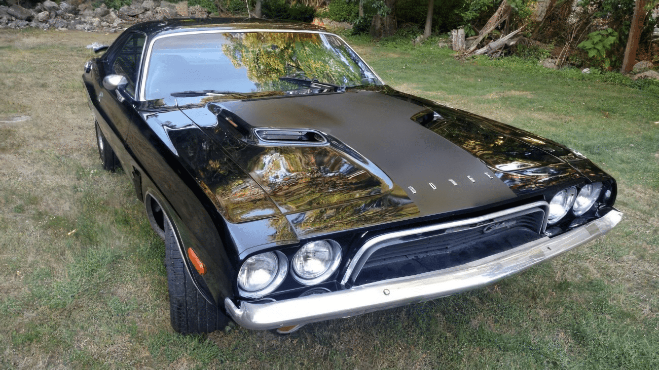

Thanks! Neat when new! Black car with a Black stripe!
PLY478
Jul 26, 2013
40
15
It does although it is not in the original configuration at all.

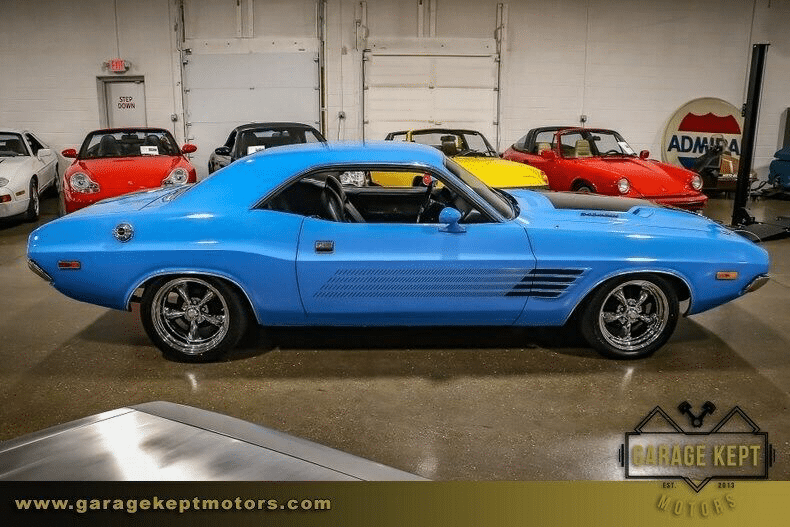

Nope, mine is in my avatar. It will be a month or so before I can start restoring it. I should say "rebuilding" it because I won't be returning it to factory. Some liberties will be taken but not too many!
It will end up pretty close to this. But it will be more along the lines of a 70 look. I will keep the side stripes, kinda like them.
