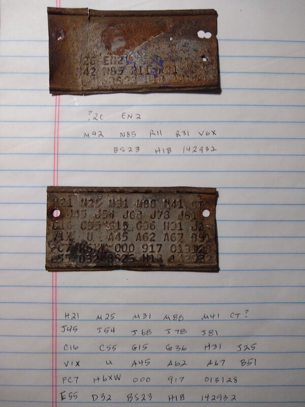

Pulled the tags off my fender, haven't found the broadcast sheet, and looking for some tips on best way to preserve/ refinish the tags - without destroying them. Also used an online decoder at Stock Mopar, posting here if anyone can fill in the missing "not found" options 16129090326299081584261874509422.jpg

The upper right code on bottom tag is "CTD" - codes are ConTinueD on the next tag. The code at upper left of upper tag is "26" calling for a 26-inch radiator opening in the core support as (opposed to the 22-inch cutout).

Thanks! Those were the biggest ?? I had

H6XW is the interior , I don't have the book here to decode it but it would tell you buckets or bench , console or not & color in your case W white

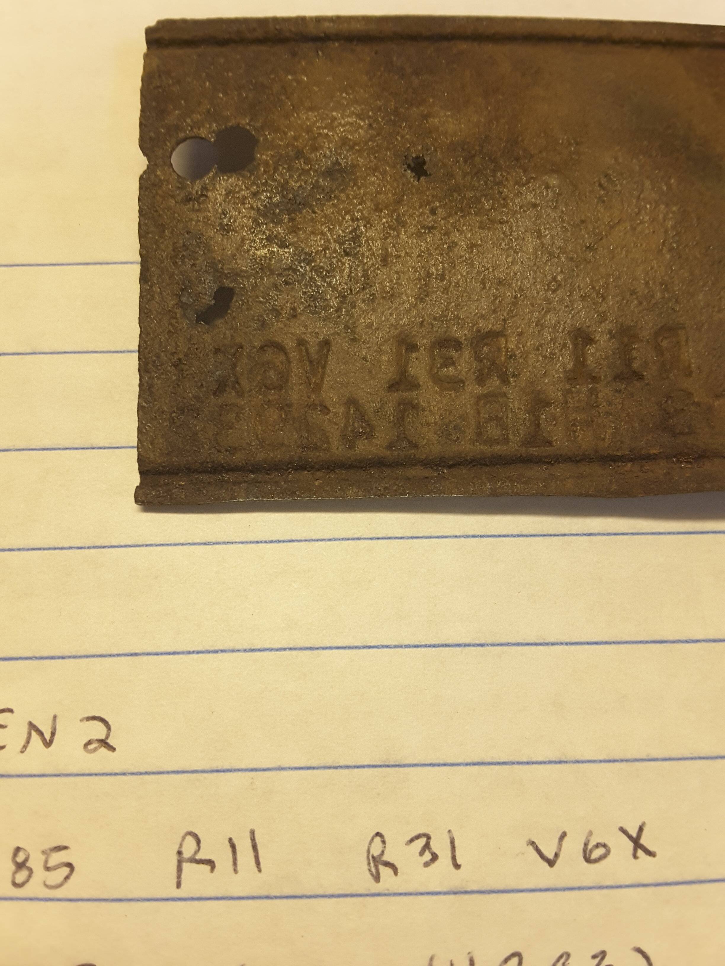

Could you post a photo from the backside. It is hard the read if it is V6X or V5X...

Oooh yeah, haven't pulled either of those yet 🤞

I'm a little confused on the spoiler package, car still has gull wing, but never had rear window louvers or chin spoilers - is that J68 & J78?
Shouldn't it have holes on fenders or roof?

J68-backlite louvers
J78-front spoiler
J81-Rear spoiler wing type
Yes there are a few holes for the louver mounts.
Yes there would be holes for the spoiler mounts.
Easy thing to fill, or does the car have a repaint?

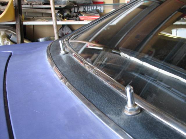

J68 would have always had a vinyl roof.
The fc7 car does not have the correct rear window trim for a backlite louver.
the mopar picture with the pretty woman appears to have the correct window trim under the louvers.
