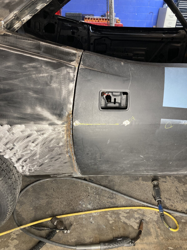

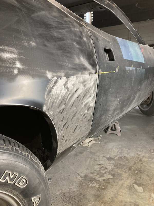

Kind of crazy to cut brand new quarters, but they are not perfect.
DetMatt1
May 13, 2009
7,968
2,146
Metro Detroit
I had to cut new quarters in a similar fashion on my ‘68 RR. One in the same place where it meets the door and the other at the rear of the C pillar next to the back glass.

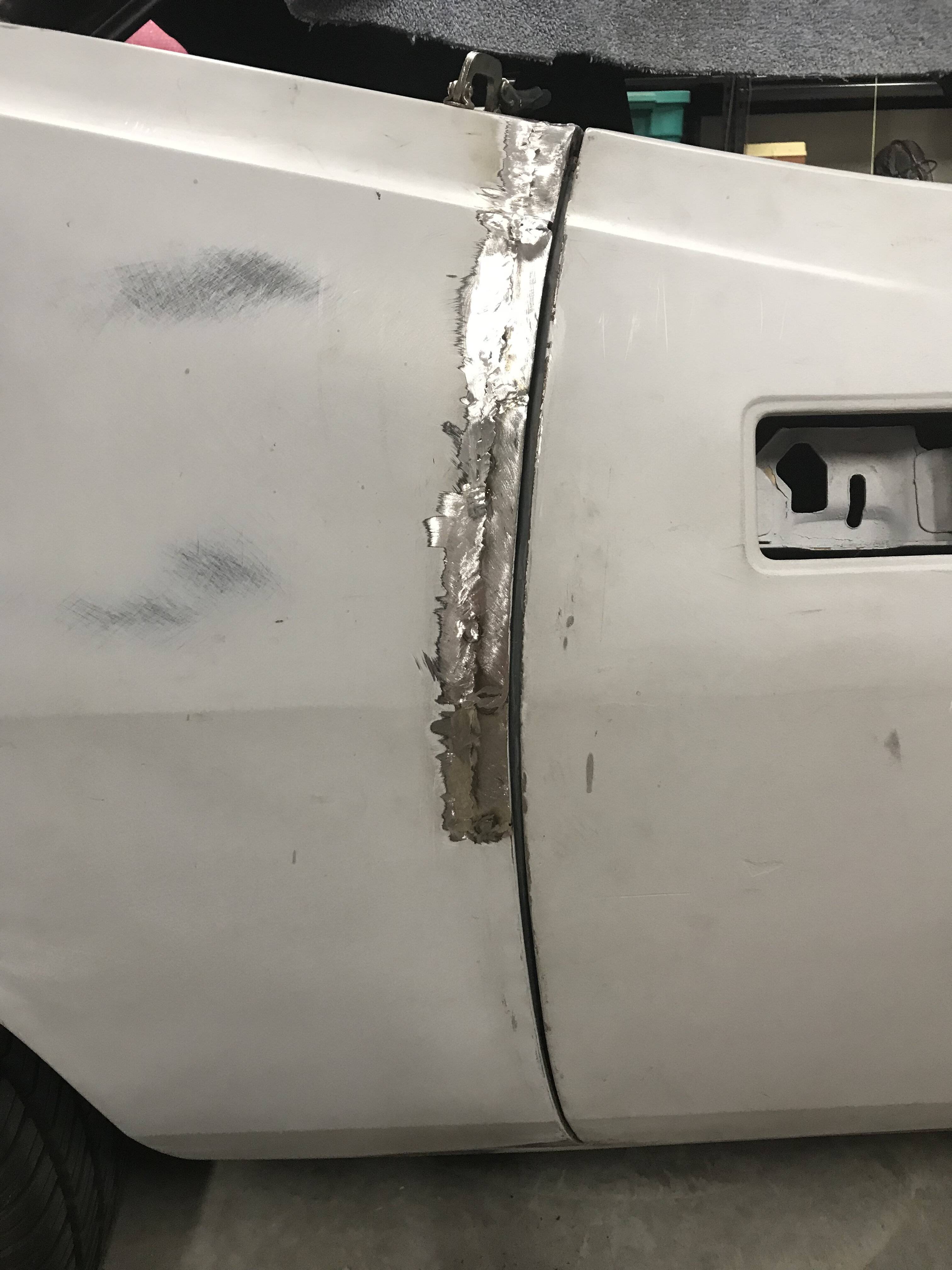

Yea. my gaps were so bad from the way the quarters were installed I had to add a lot of metal
I might add just a smidge of metal at the very edge like you did as it dips down relative to the door in a few inches and although it would not be much filler, I don't know if I really want filler on the edge of the quarter.
