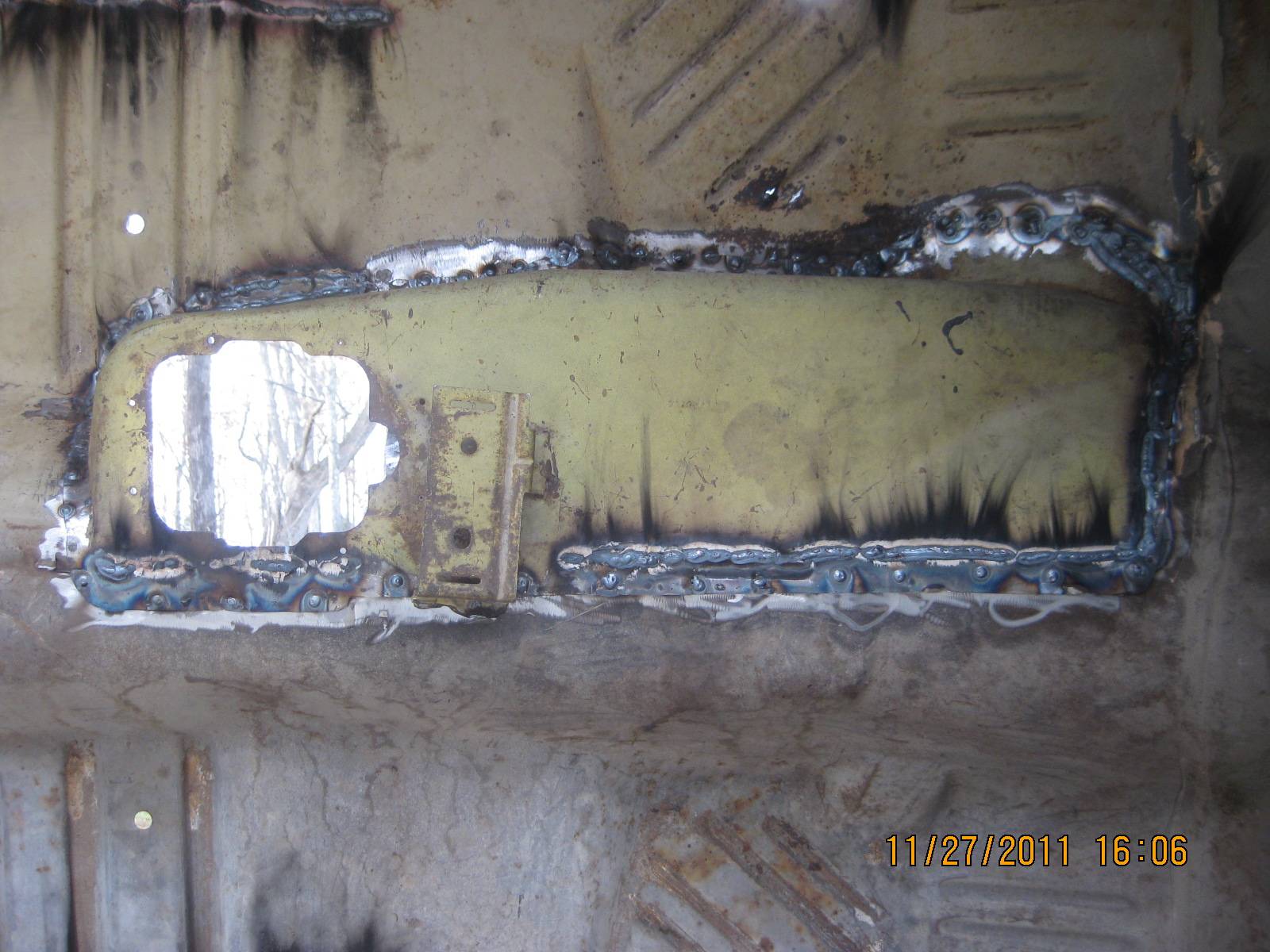

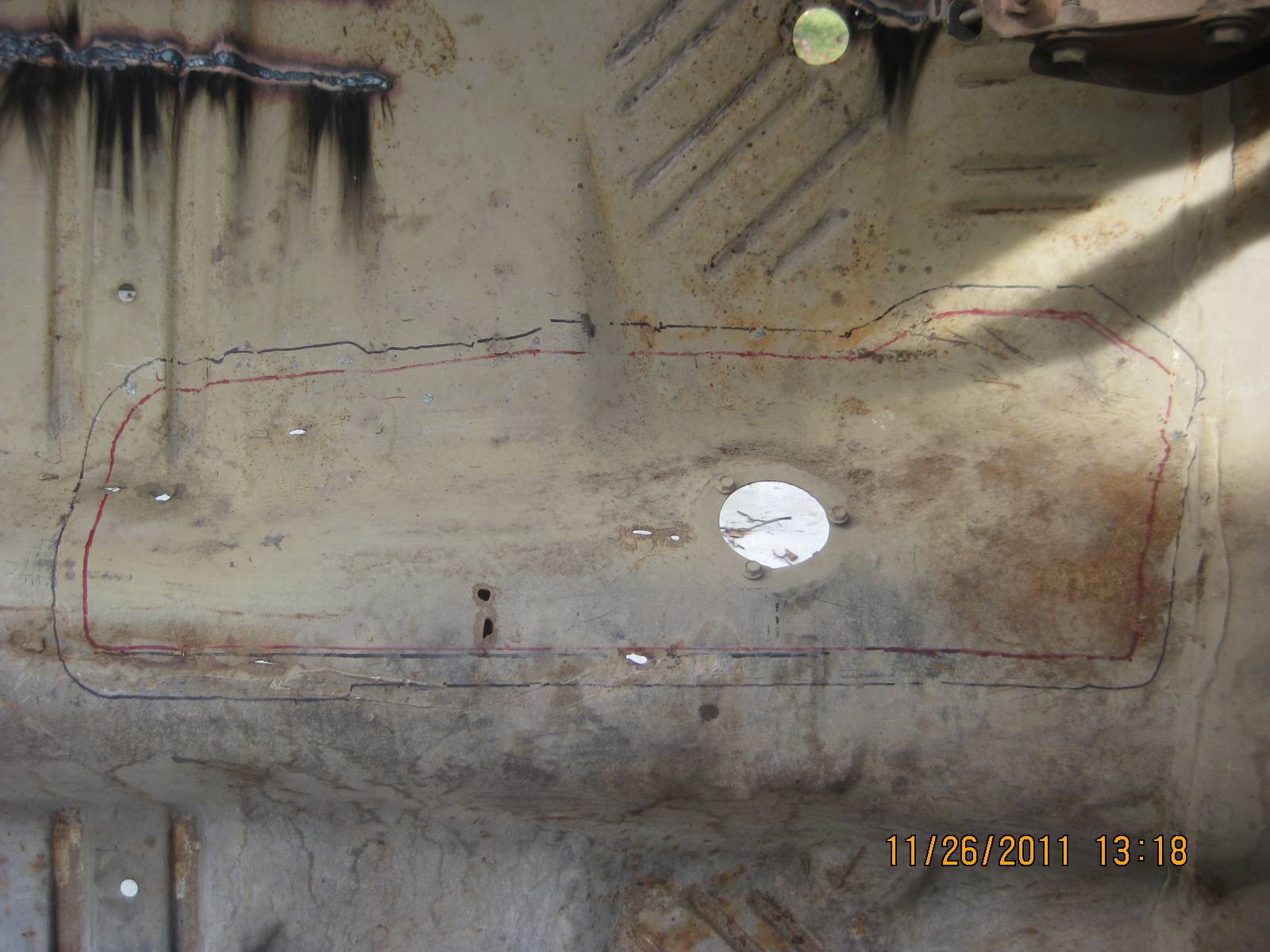

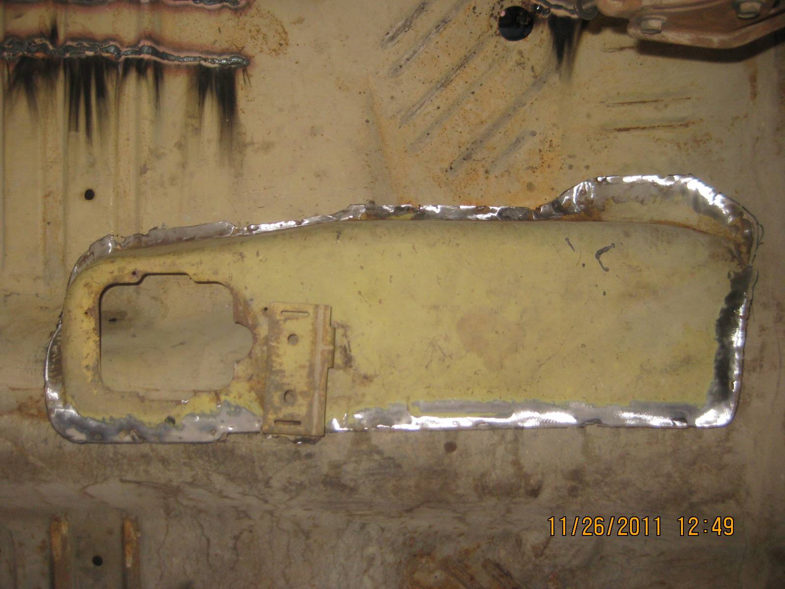

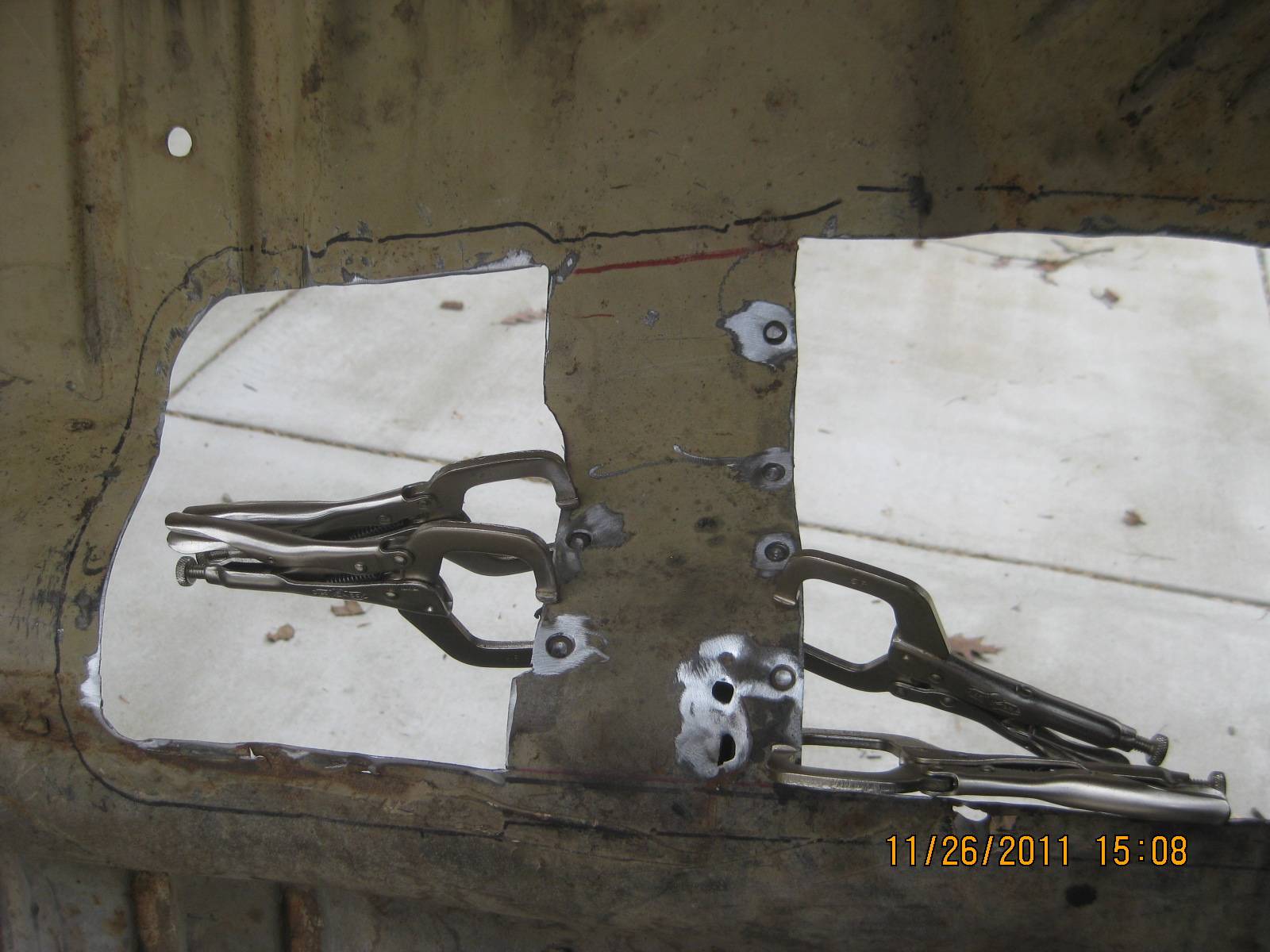

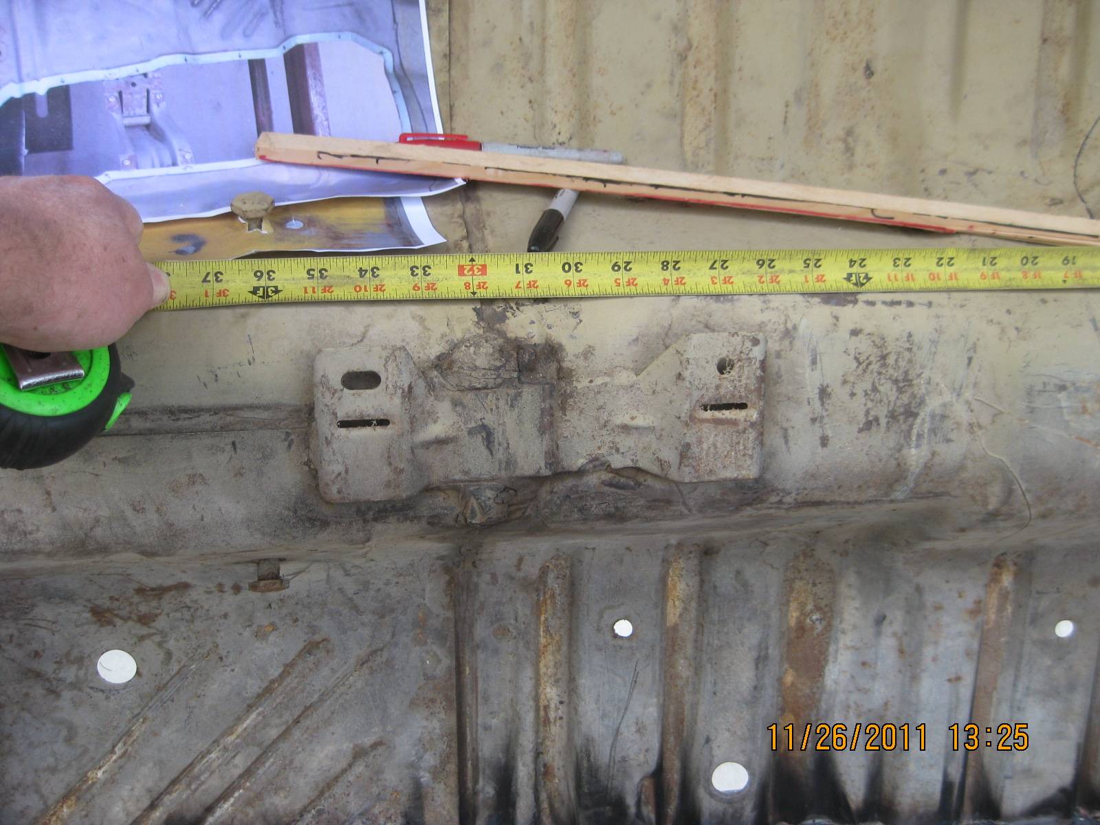

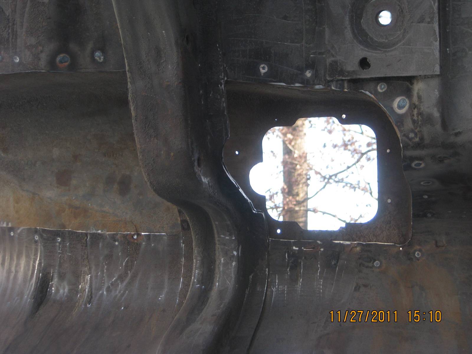

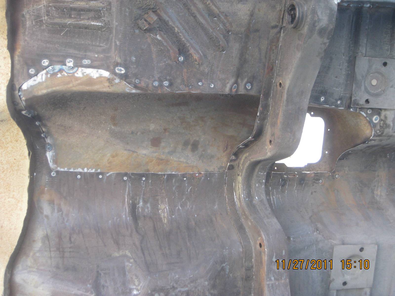

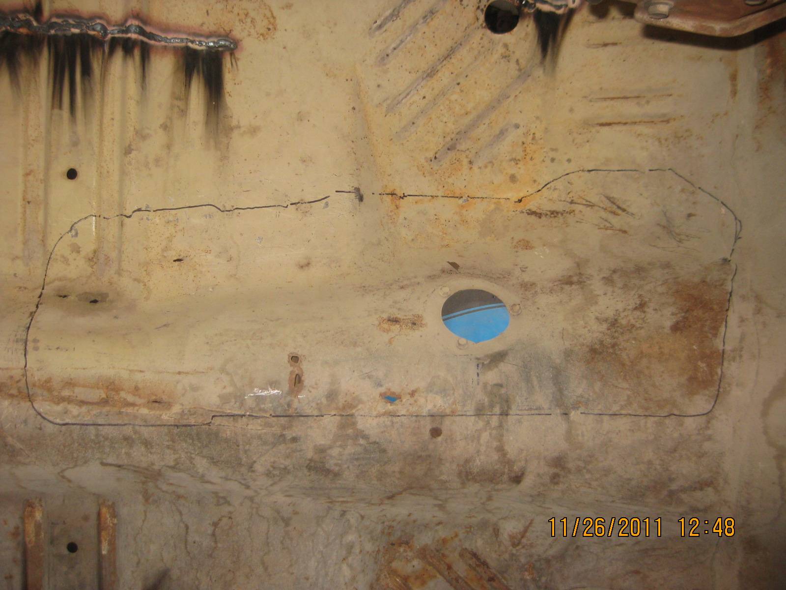

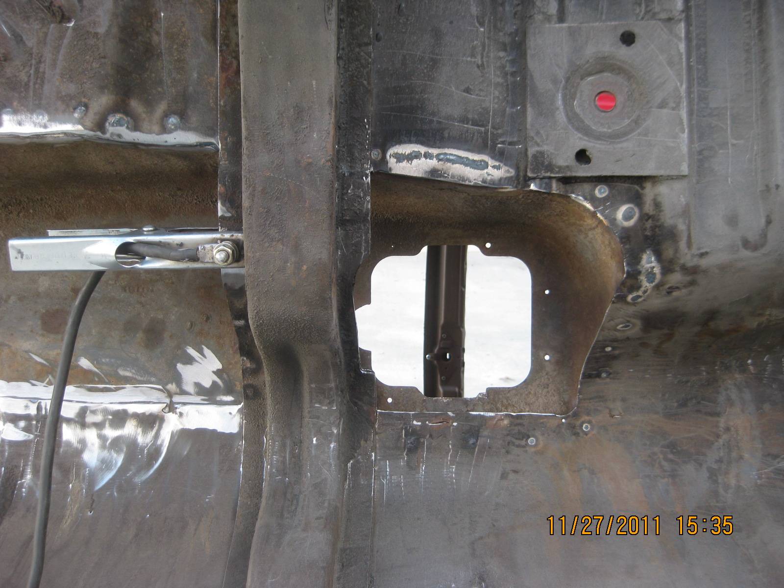

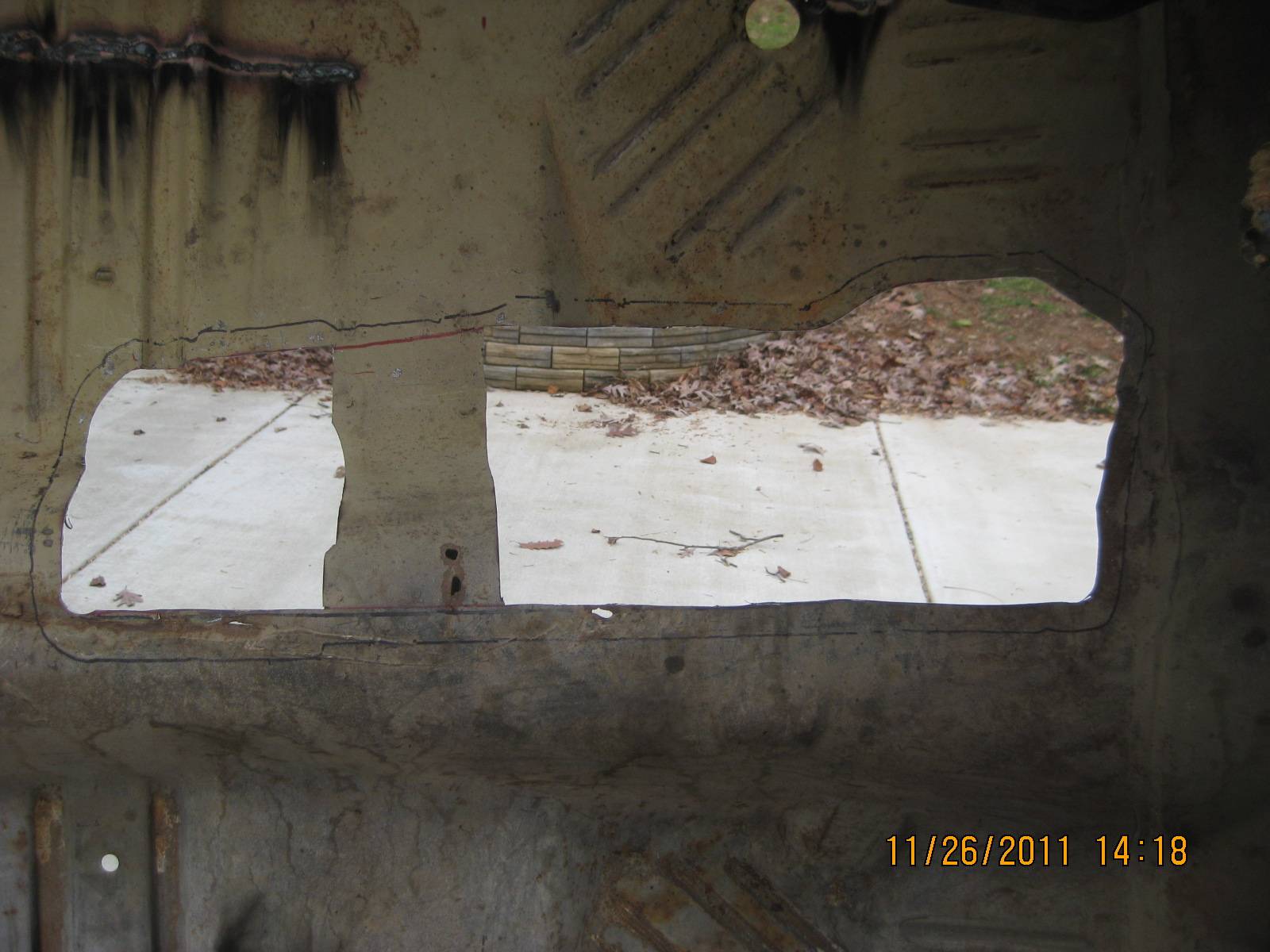

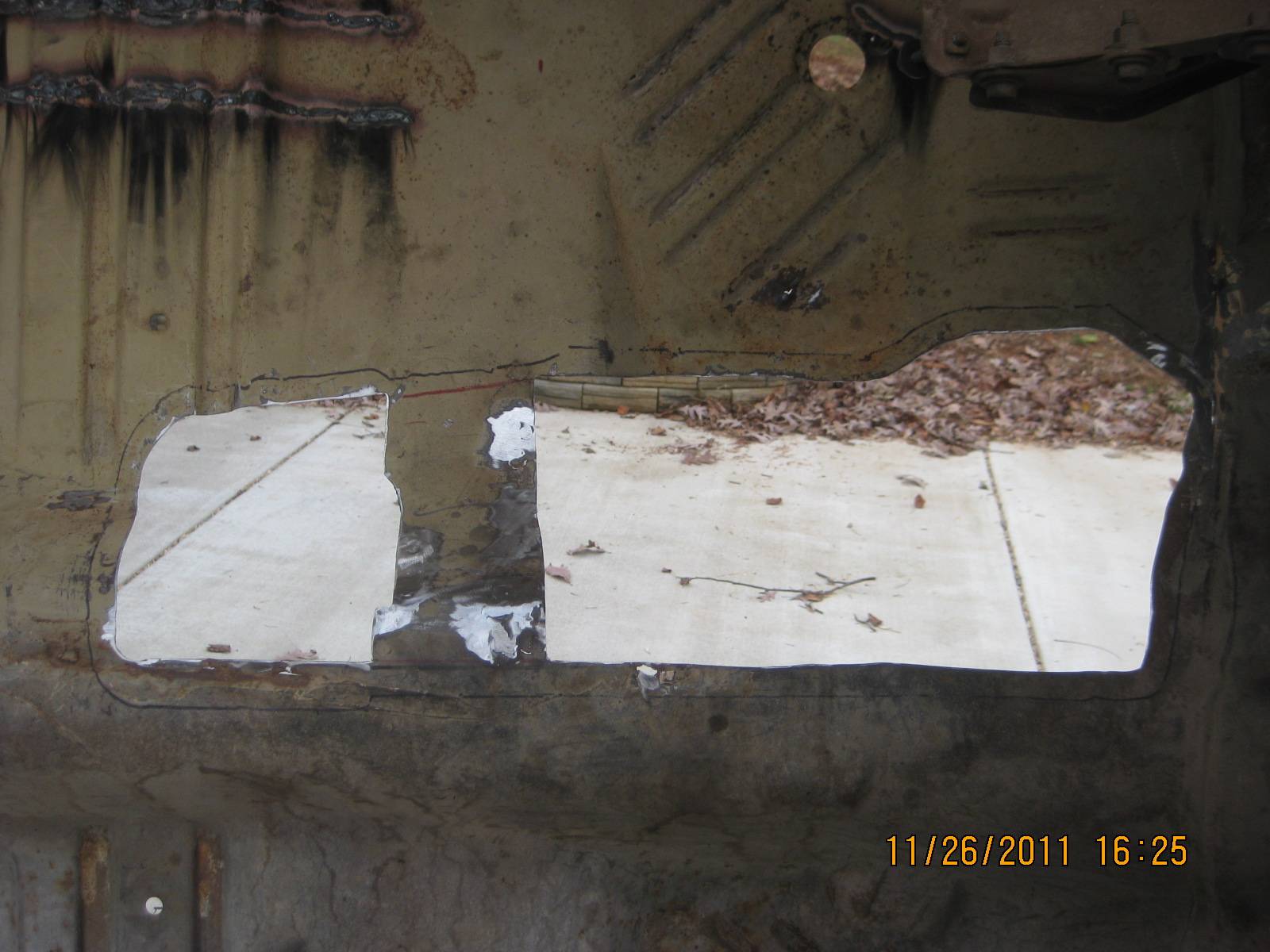

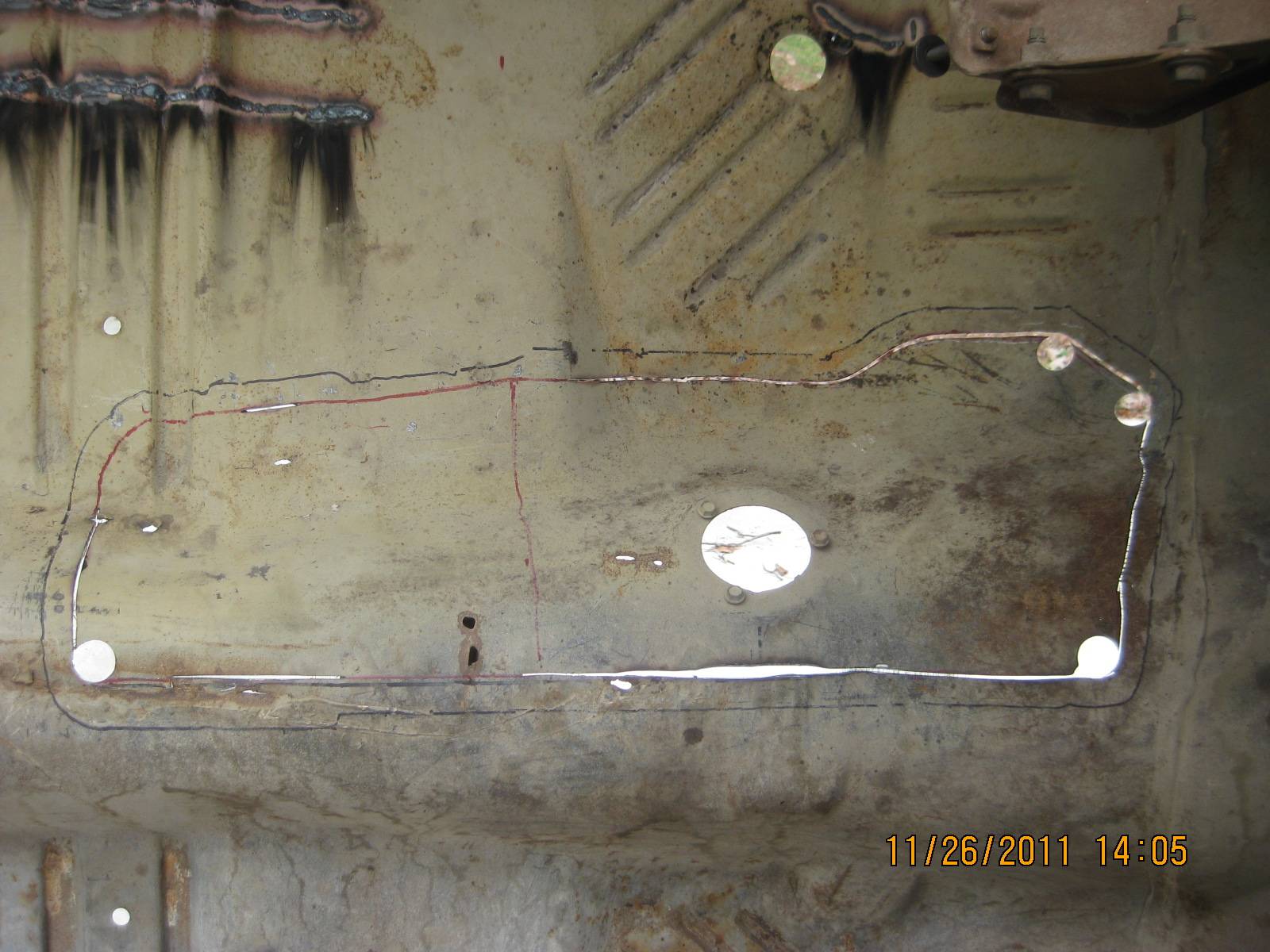

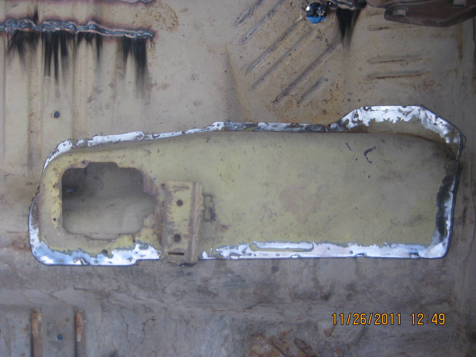

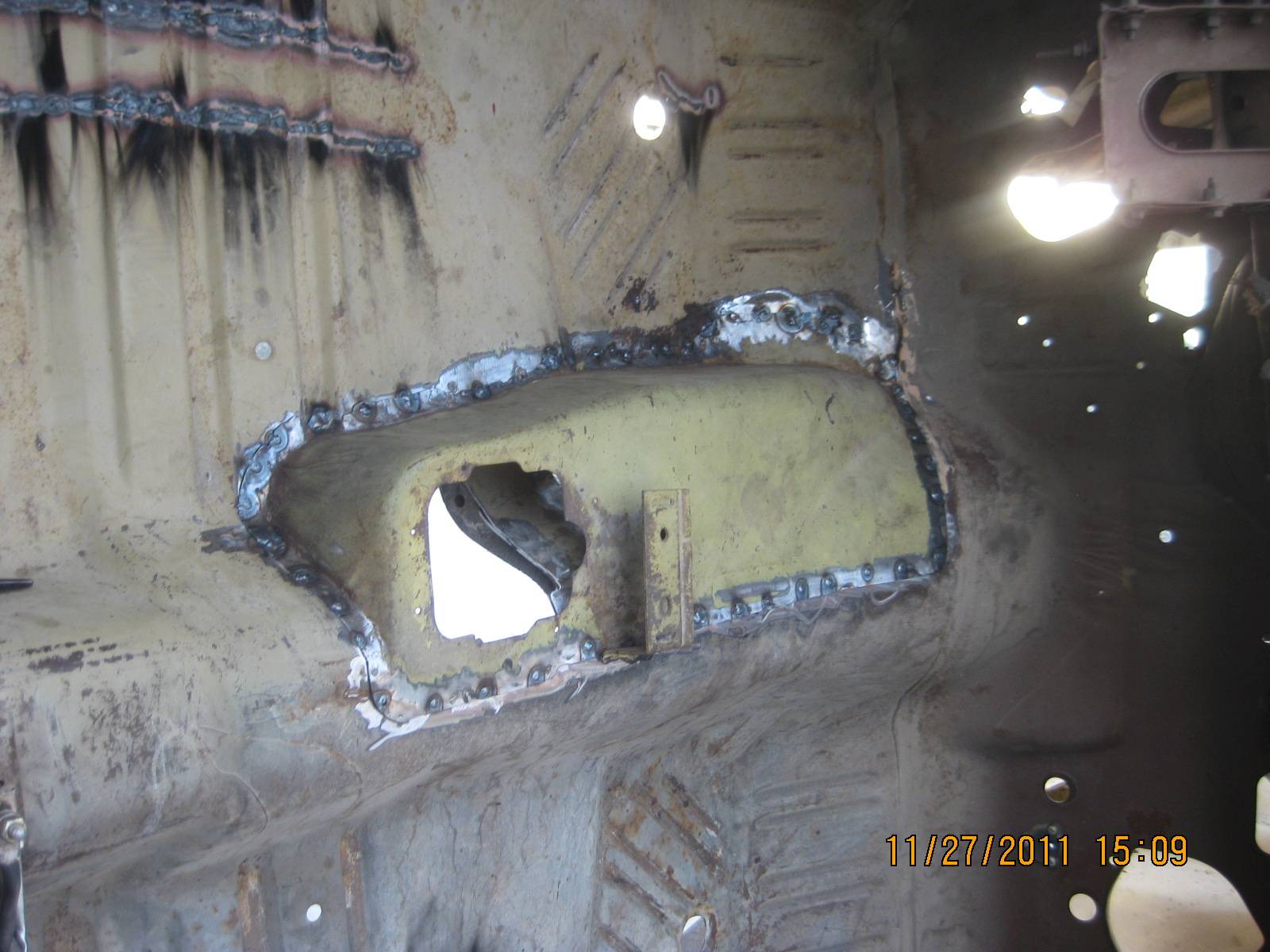

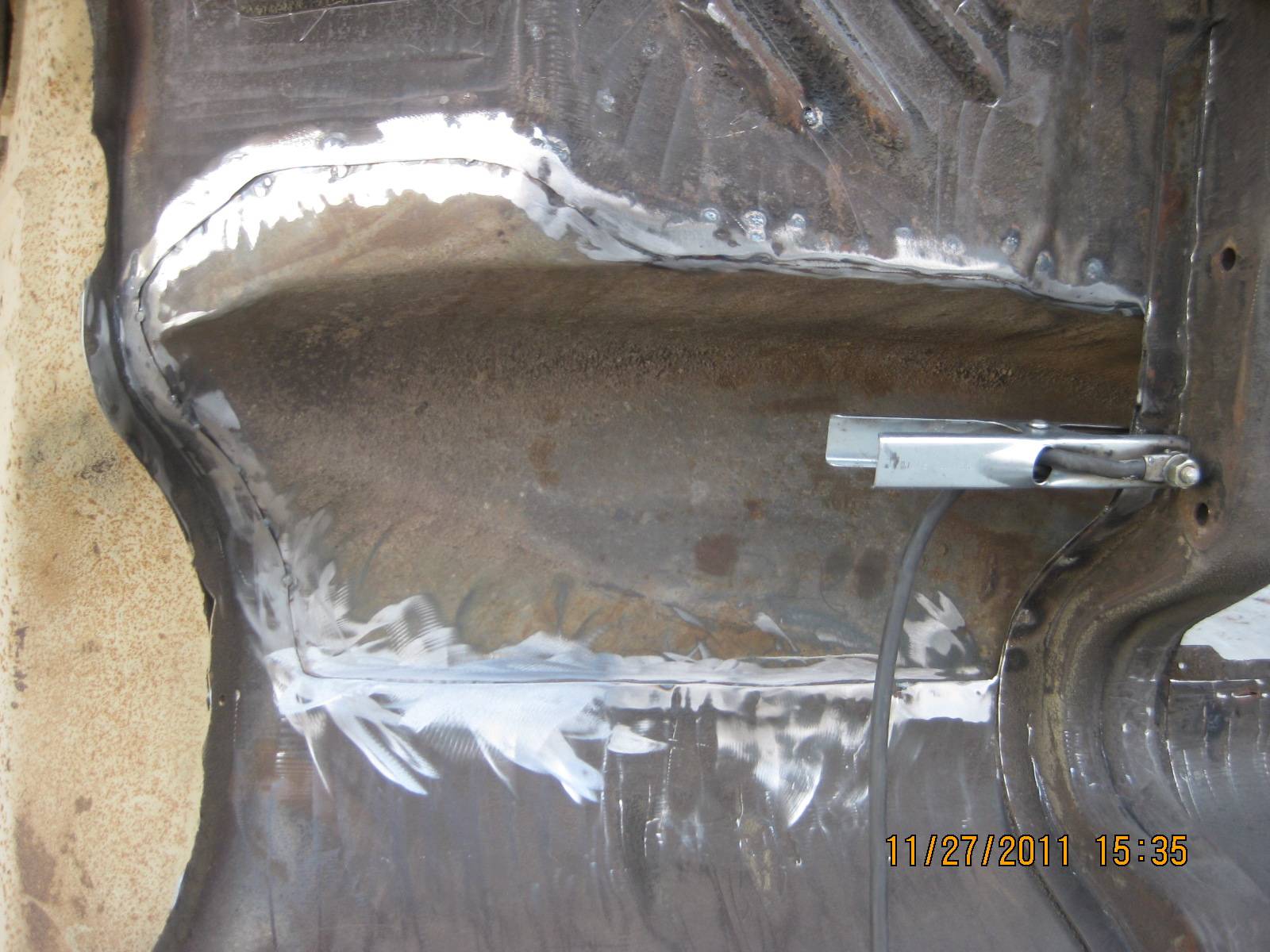

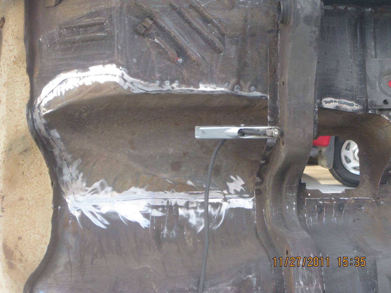

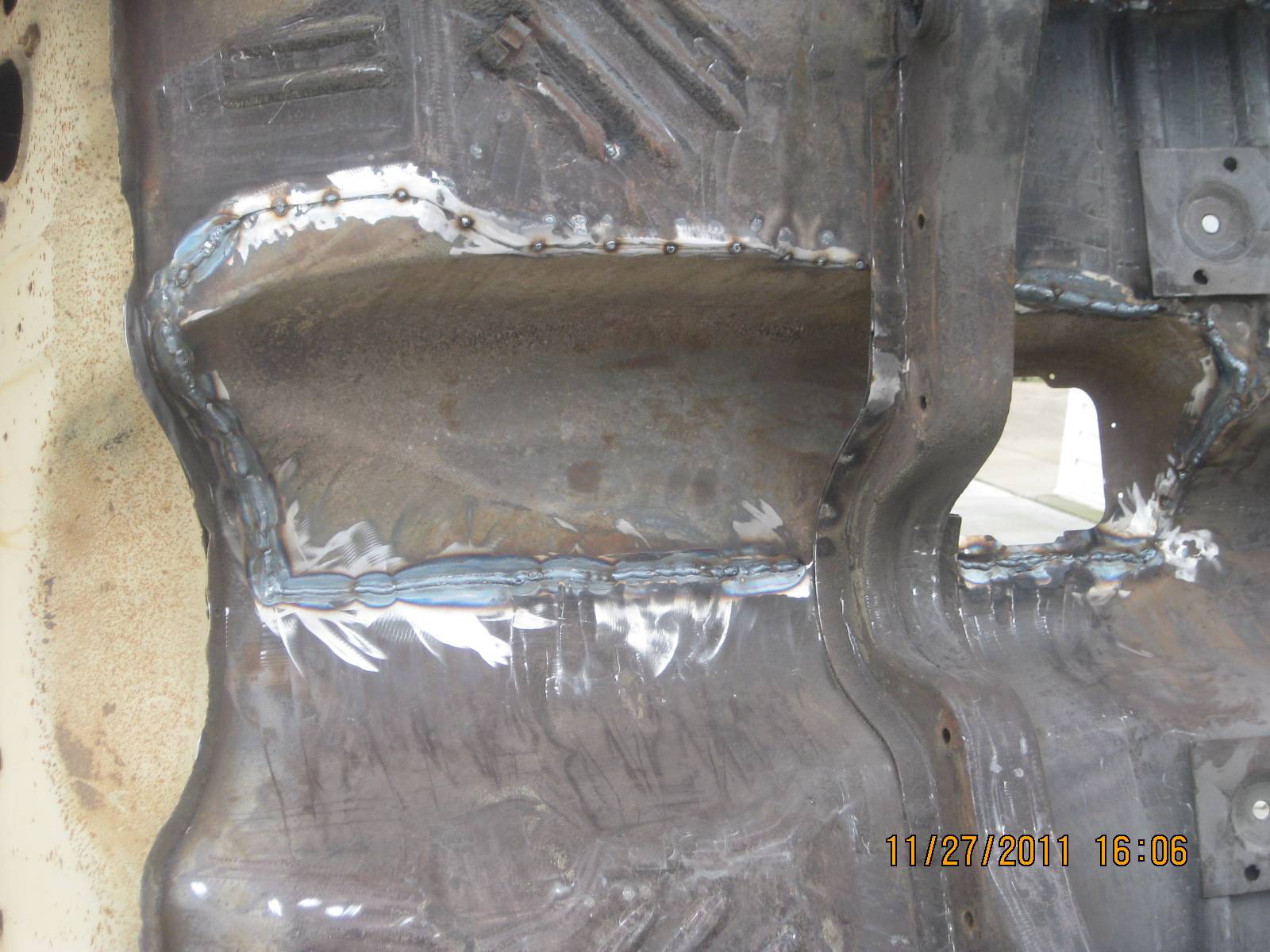

Here is some pictures from mine. The hump self aligns with grooves in the pan. I traced it, then offset the trace by the width of the flange, then cut. Kept the piece of the floor at the cross member to keep it sealed from road debris.
Mine is all factory and the hole in the original floor is actually quite large. Similar to the pics provided by Larry.
The Hurst shifter rods run along the side of the gearbox so the floor needs to be removed to clear them.
Cut the floor right away like Larry has done otherwise work/assembly on the shift mechanism will be hard.
The hole in the original floor is very neat so I assume the factory had a different floor stamping for a 4 speed car than an automatic one.
Then as described earlier the 4 speed hump is welded over the top.
