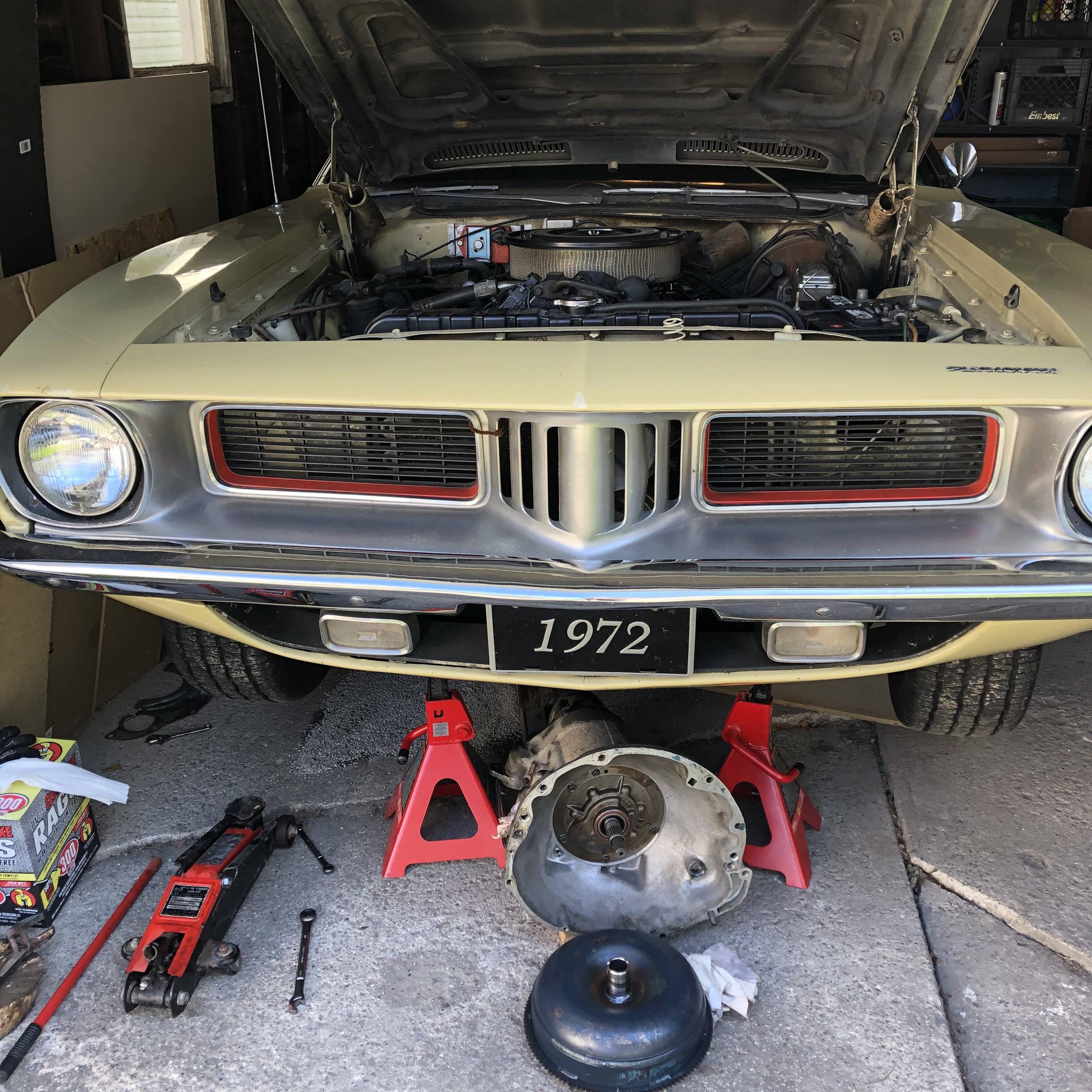

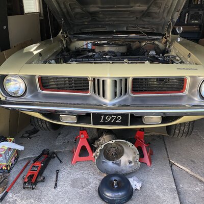

Managed to yank the trans last weekend. Tiny garage be damned!
No obvious damage to the front seal or tc, but it can’t be leaking from too many places. If I change the seals myself is there anything I need to watch out for? Or am I better off tossing it at a shop?
Swapping in a 500 would be ideal, but unfortunately that’s a bigger project than I currently have resources for. I think I’m going to prioritize just getting it back on the road for now.

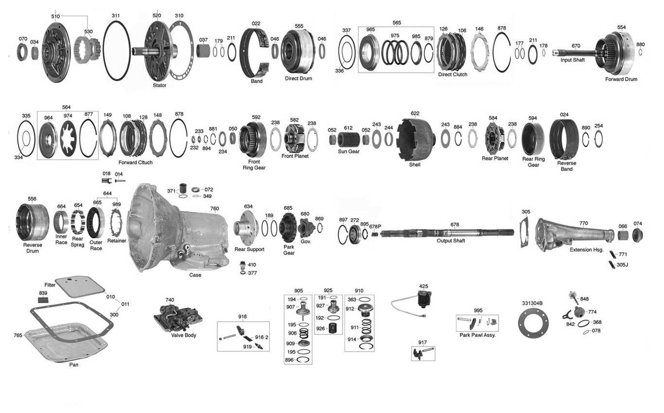

As you probably know. Remember to fill toque converter before installing.and pump notches line up so it goes in the whole way. Do you have an inch pound wrench? By chance did you check on parts available? Does the converter pump drive show where? I want to say it's part 311 gone bad.Fluid seepage out of the vent tube can sometimes be normal, but can also be caused by overfilling
or bad vent. Transmission seals can blow, or fail, for a variety of reasons. If a gasket has aged, and has not been serviced consistently, it can crack or break completely in certain areas, allowing fluid to escape. To worsen the situation of a worn gasket, the torque converter's pressure on the transmission fluid can blow out the seals as well, especially if the torque converter is malfunctioning. A faulty torque converter can prevent transmission fluid from being pressurized and propelled throughout a vehicle's transmission, a condition that can prevent transmission operation and function. //Pump leaks can only be repaired with the transmission out. Once it is out, it would be a good time to pull the pump and inspect the friction material in the front and rear clutch drums. Special slide hammers are needed for this operation but they are relatively inexpensive. Check the bushing that the converter hub rides on for excessive wear and replace the steel sealing rings on the reaction shaft support and the input shaft. The extension housing seal, speedometer gear seal, dipstick 0-ring and pan gasket are all relatively simple and inexpensive to repair even with the transmission still installed. Just some thoughts. you might not have any other problems.
