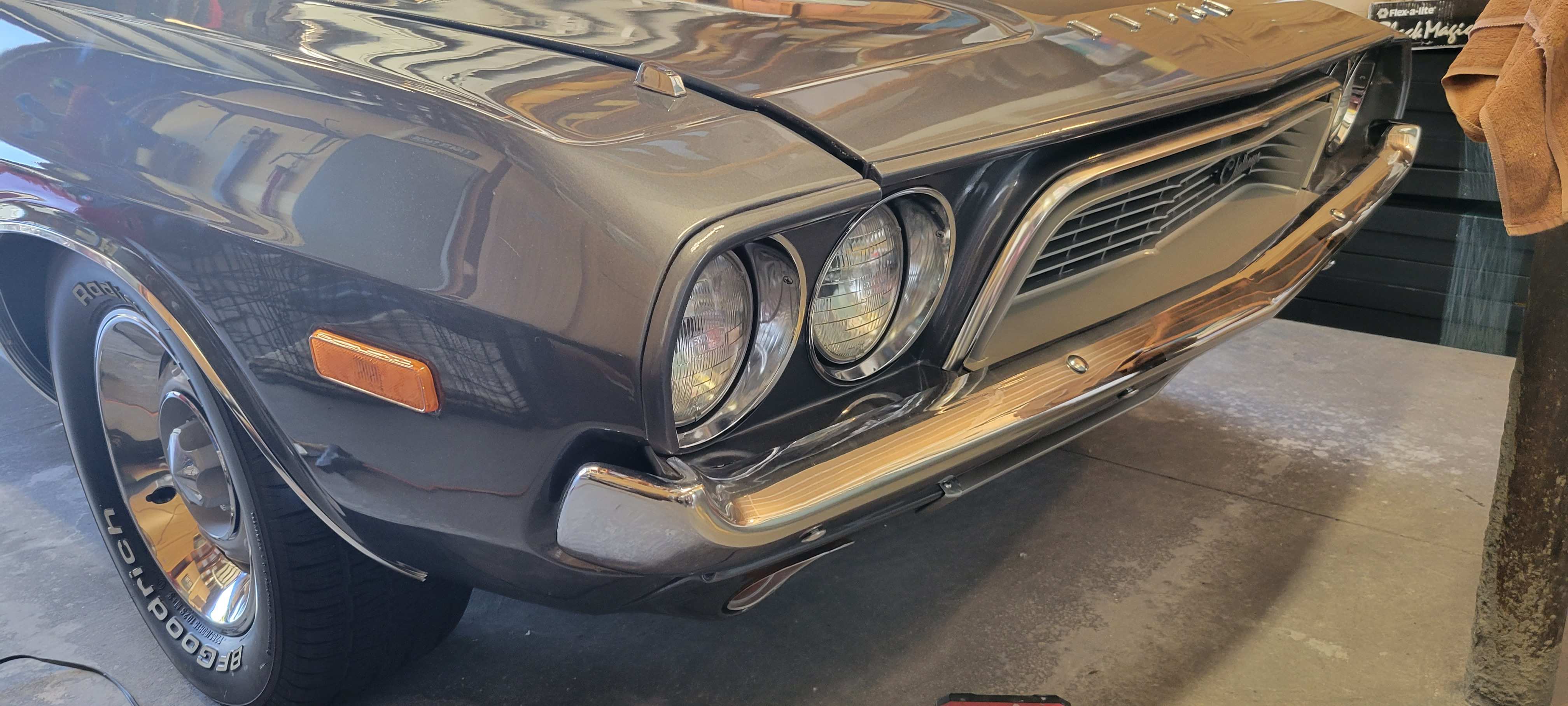

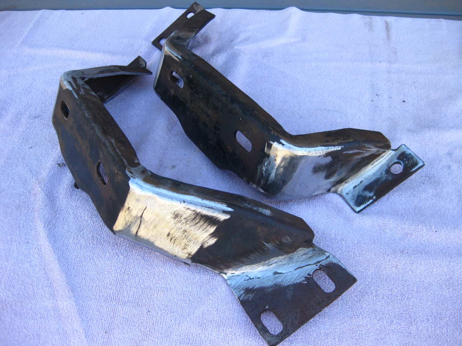

I snugged mine up using all original 73 pieces. I shifted it back using the front two holes in the bumper brackets and without the reinforcement bar. I can't remember if I had to hog out one of the holes a little bit in the brackets, but it pushed it back about 3" inches.20230522_122217.jpg

For the back, I did some mods to the original 73 bumper brackets to get the snug fit. Couldn't find the early brackets at the time, so I went with what I had. For the front bumper, I filled the holes with bolts if they connected to anything or not. It's been awhile and don't remember how that all came together. I know the reinforcement bar(s) where not installed. I still have those, the fillers, and the bumperettes in case I ever sell it and someone wants to go back to the original look. Good luck!
