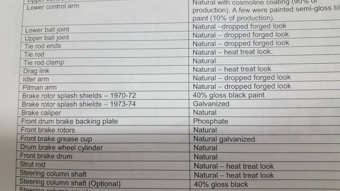

As a sidebar note:
Should the shields be painted black?
I have seen stock restorations where this was the case,m and others where they are silver.
My original shields have the remnants of black paint on them.

As a sidebar note:
Good point! According to the ICCA judging/restoration guide, the finish on the dust shields for 1970-72 E-Body should be 40% gloss black paint and 1973-74 should be galvanized (see photo.) Like anything else Mopar though, take it for what it's worth...
The shields on my T/A were definitely black.
