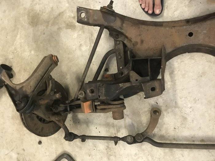

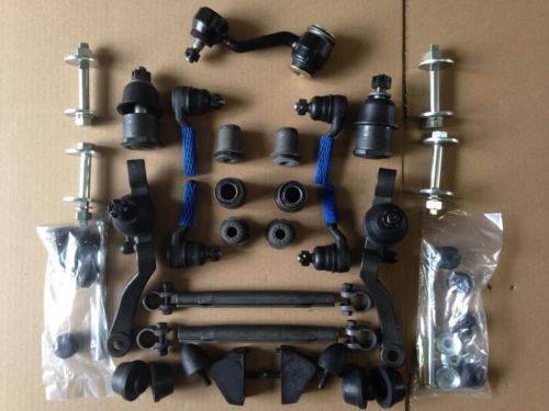

i have been breaking down my 70 rt k frame and have some questions(my first time btw) so I'm down to the last metal bars that go in the k frame and have little metal(safety pins I guess) on the ends of them. How do I remove those so I can get the nut off and remove it. And will suspension rebuild kits come with those circle rubber grommets or do I need to specify that I needs those as well??? I will include a pic of the little pin that goes through the rod. Now I need recommendations for front end rebuild kits, I'm gonna put a pic of a $490 kit up off eBay and let me know if pst or other company offers a better kit. I think these are polyeurethane.

This is the pic of the k frame, i had a closer pic but it said too large To load, when this pic is with the same camera. Anyways it's the rod by my foot in the pic, I have everything else broke down. Thanks

I just soaked the pin with a rust buster, tapped it down with a mechanic's hammer and pulled the pin out with needle nose vice grips.
Use American made vice grips, the new Chinese made ones flexed too much at the tip.
Worked, they came out easy. New pins and nuts are available and sometimes come w the rebuild kits.
The rod is a stabilizer bar that has bushings in the k frame side of the bar. There is an improved version of the bushing that can be purchased from Moog that is one piece.
I purchased all Moog parts separately from Summit at a good price. I preferred to know what I was buying.
Check out my resto thread here on FEBO, I posted a list of the Moog front end rebuild part numbers w prices from about a year ago.
Hope it helps!

The bushings for those stabilizer bars (actually called strut rods) are included in your kit picture. They are the two piece bushings in the bottom row on a each end of the row. I also buy individual Moog parts when I rebuild the suspension rather than buying a kit. Some of those kits have Chinese parts in them and I have never had any problems with Moog parts. Ditto what paharamia said on removing the strut rod pins. They are standard roll pins, 1/8" if I recall right.

I like the polyurethane bushings, rubber doesn't last very long in comparison. Also, I recommend the lower control arm reinforcement plates...they are only about $20. And now is the time to upgrade your torsion bars... There are lots of good threads on this site.
