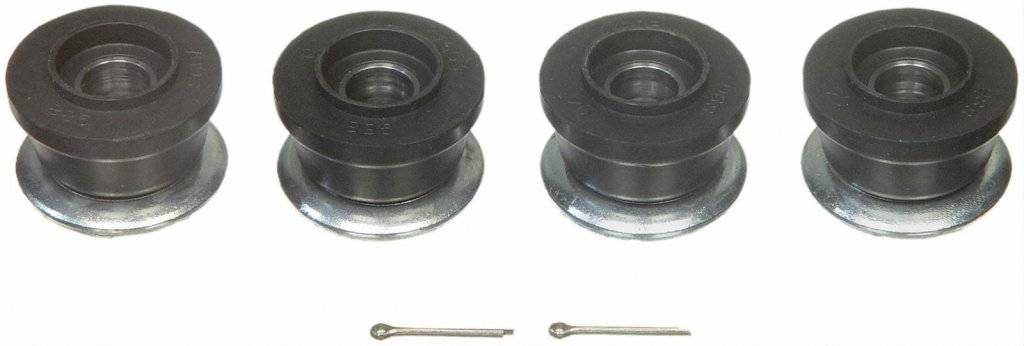

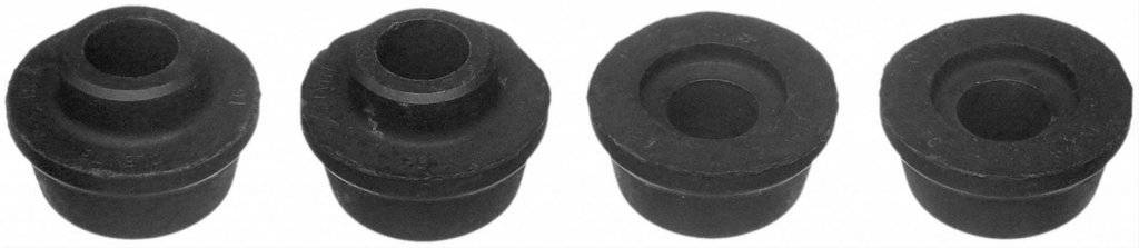

Rebuilding the front suspension on the A66 Challenger.
Using Moog parts from Summit.
What is the difference between K7026 and K 7016A on the Strut Rod Bushings?
Both are listed for the 70 Challenger. They look identical but the 7026 has a metal sleeve. Are these more heavy duty, or is the sleeve a normal part connected to the strut bushings?
Comments appreciated.
Strut Rod Kit (Improved Design) K-7026 (Std Design) K-7016A
