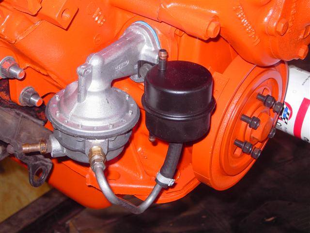

I have a Challenger RT with a 440. Can someone tell me where the fuel filter/vapor separator mounts? Thanks

Vapor separator mounts next to the washer bottle to the right of the radiator. The fuel filter is located on a 4 bbl between the carb and the distributor cap. The factory lines will show you exactly where they go.

Thanks for the reply Leo. Are you talking about a gas vapor separator that is attached to a line from the fuel tank? That mounts next to the radiator?

There is a charcoal vapor separator with lines connecting to the carb and a line running back to the fuel tank. And this also that mounts to the fuel pump.

Perfect. That's what I was looking for. Thanks Leo.
