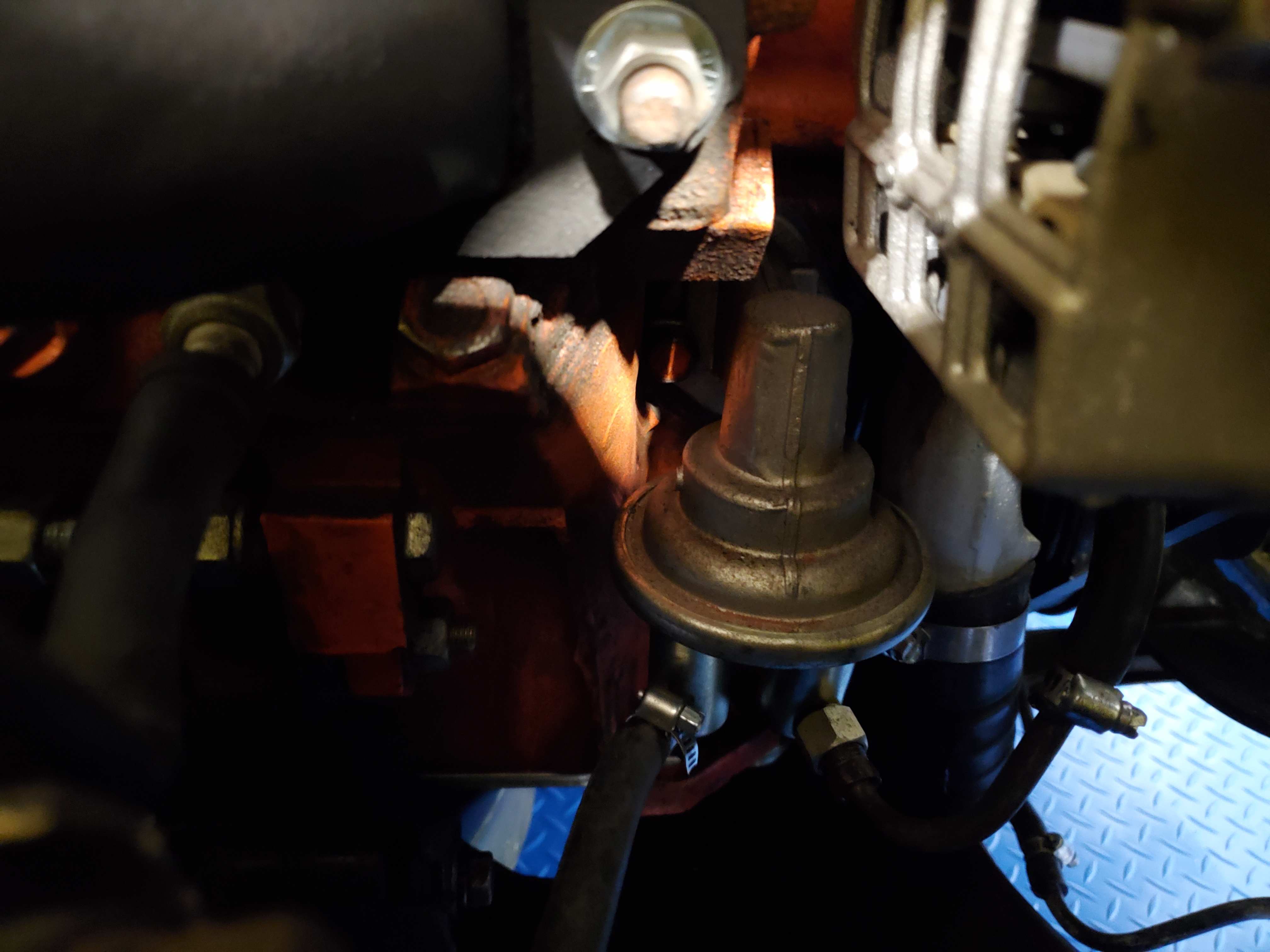

Finally got the cuda back from shop but when driving home it had like a spray paint can rattle when giving it gas not at idle plus there was a huge fuel smell which looks like the pump because it had fuel on top of the pump , its in the garage right now to cold and too much snow to take it back , the rattle I read could be a couple things and what is a good pump nowadays , Im guessing the Carter.

A little more background might be helpful, but I agree, for a mechanical fuel pump, just buying one new, a Carter would be my first choice. This often matches the OEM fuel pump pretty well.
What year, model, and engine are we talking about? Although, a picture of the wet fuel pump and engine bay would answer most questions.

It's a 1969 383 , not original, was a 318 from birth , the pump had fuel or moisture on top of the pump , I have dried it because the smell of fuel and its in my garage .

it seems odd, if the pump were leaking, there would be fuel on its top. below it, sure, but on top?
when it's warm enough for you, maybe start it and let it idle in the garage (with the door up, of course) and watch to see if you can figure out where the fuel is coming from.

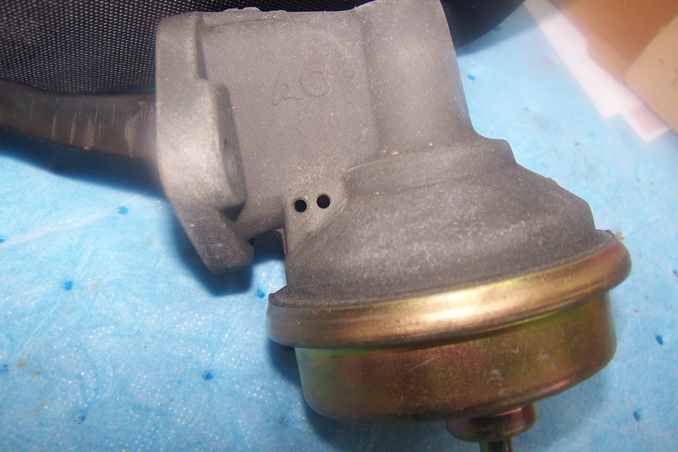

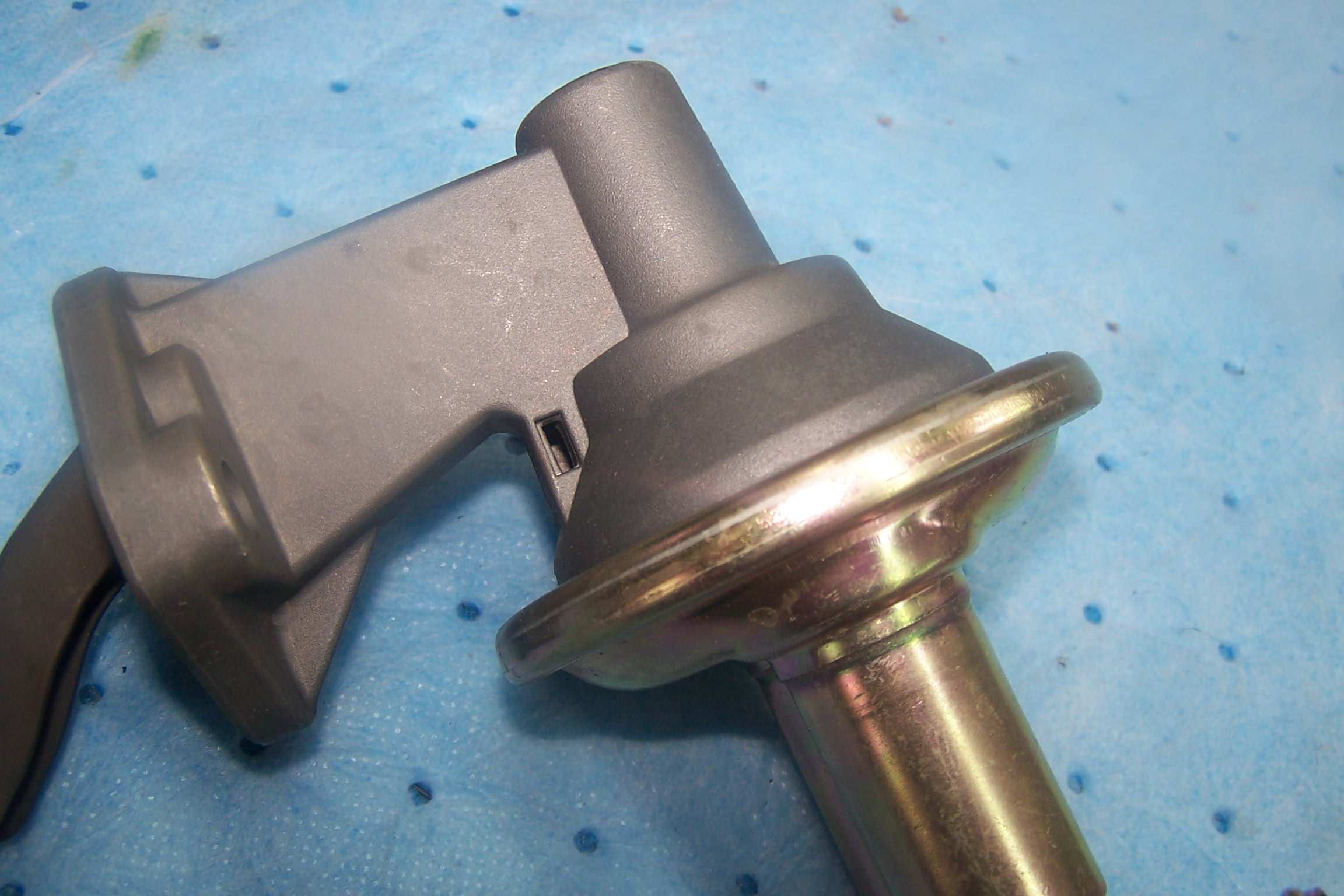

Fuel pumps have at least on hole on the upper part of the pump. Some have two holes but they are there to tell you the diaphragm has failed. The fuel will squirt out those holes instead of pumping fuel into the crank case. If the diaphragm is bad this is where the fuel will leak out. Here are a couple pics. The one on the left is a big block AC pump and the one on the right is a small block AC pump.

When it gets warm enough for you, start the car briefly and inspect the fuel pump while it idles. If @sixpactogo is right, and I think he is, the car need only run for 30 seconds to confirm if fuel is weeping from those holes. If so, you've got a worn/failing fuel pump to replace.

Truth is, you don't even need to start it. If the diaphragm is bad, it will squirt gas out those holes just by turning it over a few times. Pull the coil wire and hit the starter for a bit.
