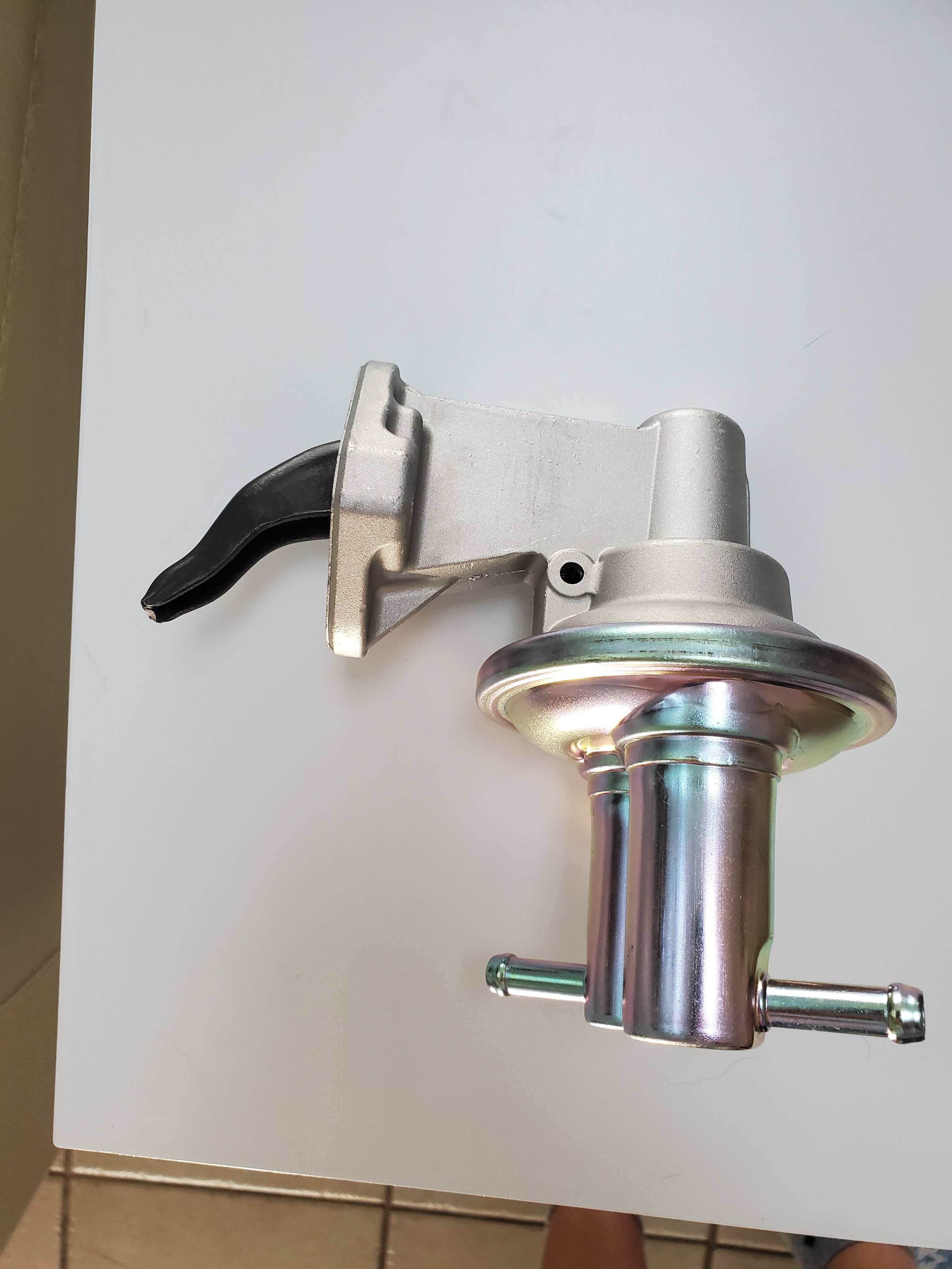

So this is the pump I ordered , Made in China , that's not cool . Is there one better.
Oops, sorry I miss spoke. I meant the other way around like 340challconvert said.
I guess the Carter for a 383 have push in hose connectors , can I take out the 5/16 hose lines and replace with 3/8 line without any reducing fittings , will the 3/8 hose fit on the Carter push on .
You can use that fuel pump. All are made in China these days unforntuately. 🙁 I would run as much steel line as possible and use shirt rubber lines to connect everything up. Personally, I like to bend my own lines, but that's because I bent small tubing for a couple years.
