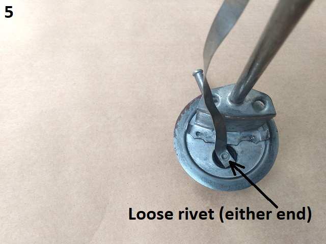

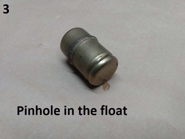

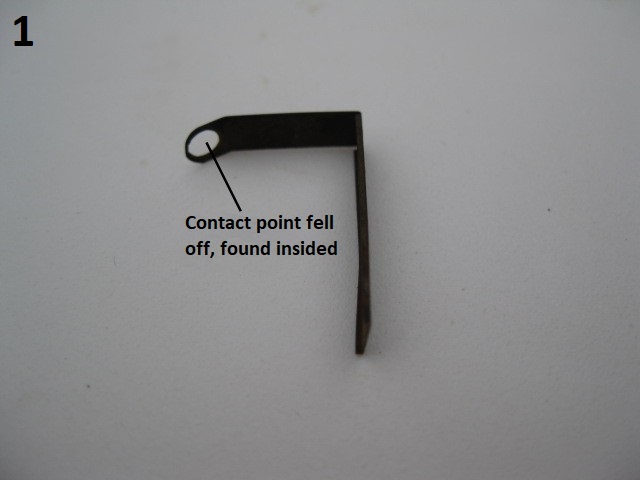

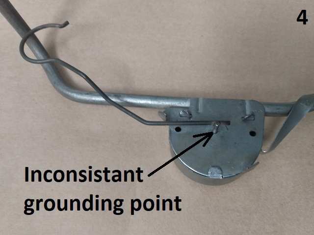

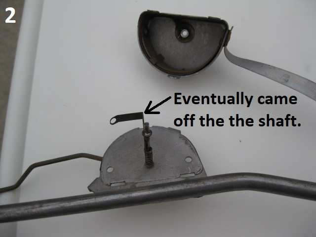

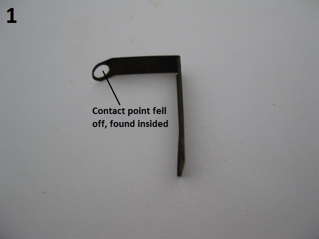

I decided to compile (w/pictures) a list of fuel sending unit issues I've personally encountered and dealt with. Some of these resulted in either an empty reading on the gauge or an erratic, all over the place, reading.

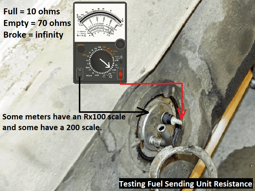

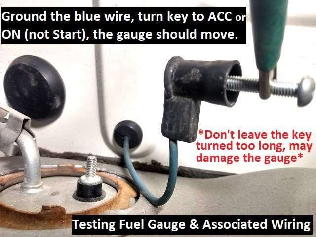

Thought I'd add these pictures into this thread.
