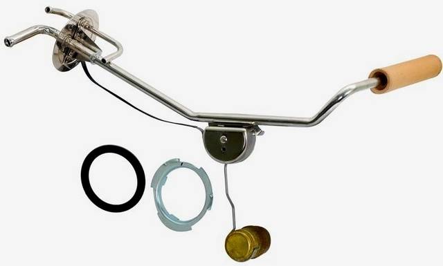

There is a 3/8" sending unit and a carter 3/8 high volume fuel pump.Don't recall were I got them.that's what I installed on mine. and a 3/8" fuel filter from napa I think. reducer 3/8" to 5/16" after fuel filter. I'll look and if I find the pump part number I'll posts it.I think the fuel filter was listed for Chrysler Cordoba.
Restoration Parts Source (RPS)​
Carter M6270 Mechanical Fuel Pump is for a LA block​

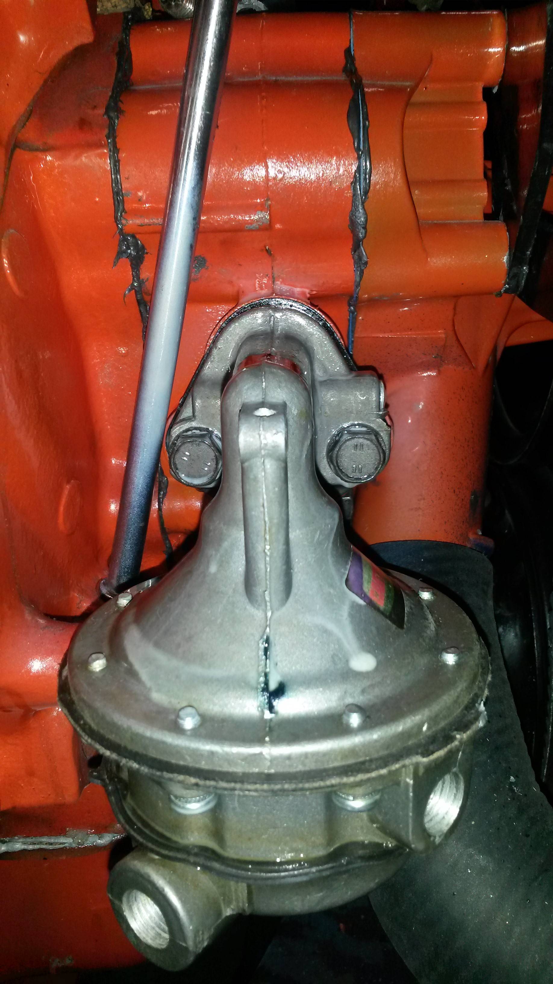

I have run into starvation issues in the past , especially with 500 " stroker builds , I pay a lot of attn to the whole fuel system making sure everything is 3/8 id , I have drilled out the body of fuel pumps where the fittings enter & exit & opened up fittings as well , often the inside of the fittings will drop to 1/4 " , any restriction can hurt fuel flow .

Remember that 3/8" fuel line tubing is 3/8" Outside Diameter (O.D.) which is approximately 5/16" Inside Diameter (I.D.). 3/8" fuel line hose is 3/8" I.D. which makes sense as it is meant to slip over 3/8" fuel line tubing and hose fittings. Many mechanical fuel pumps, even the Carter M6903 for the hemi, have 1/4" NPT ports as Chryco Psycho said.

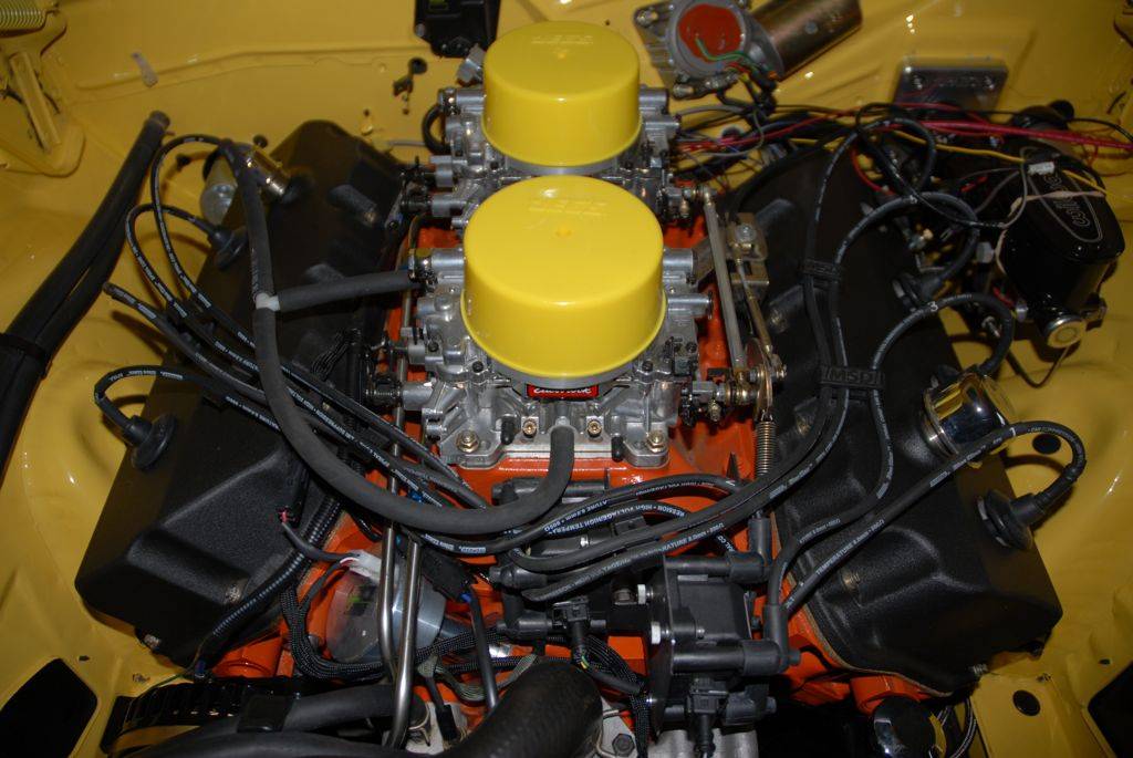

try the 5/16 and see - rule of thumb for carbureted is 5/16 to 400 hp -- 3/8 runs out at about 500hp. This is based on WOT and 1/4 mile or more..

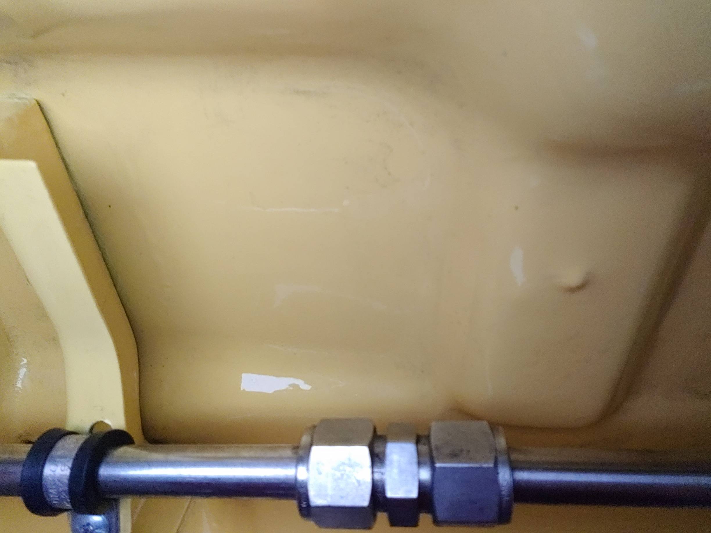

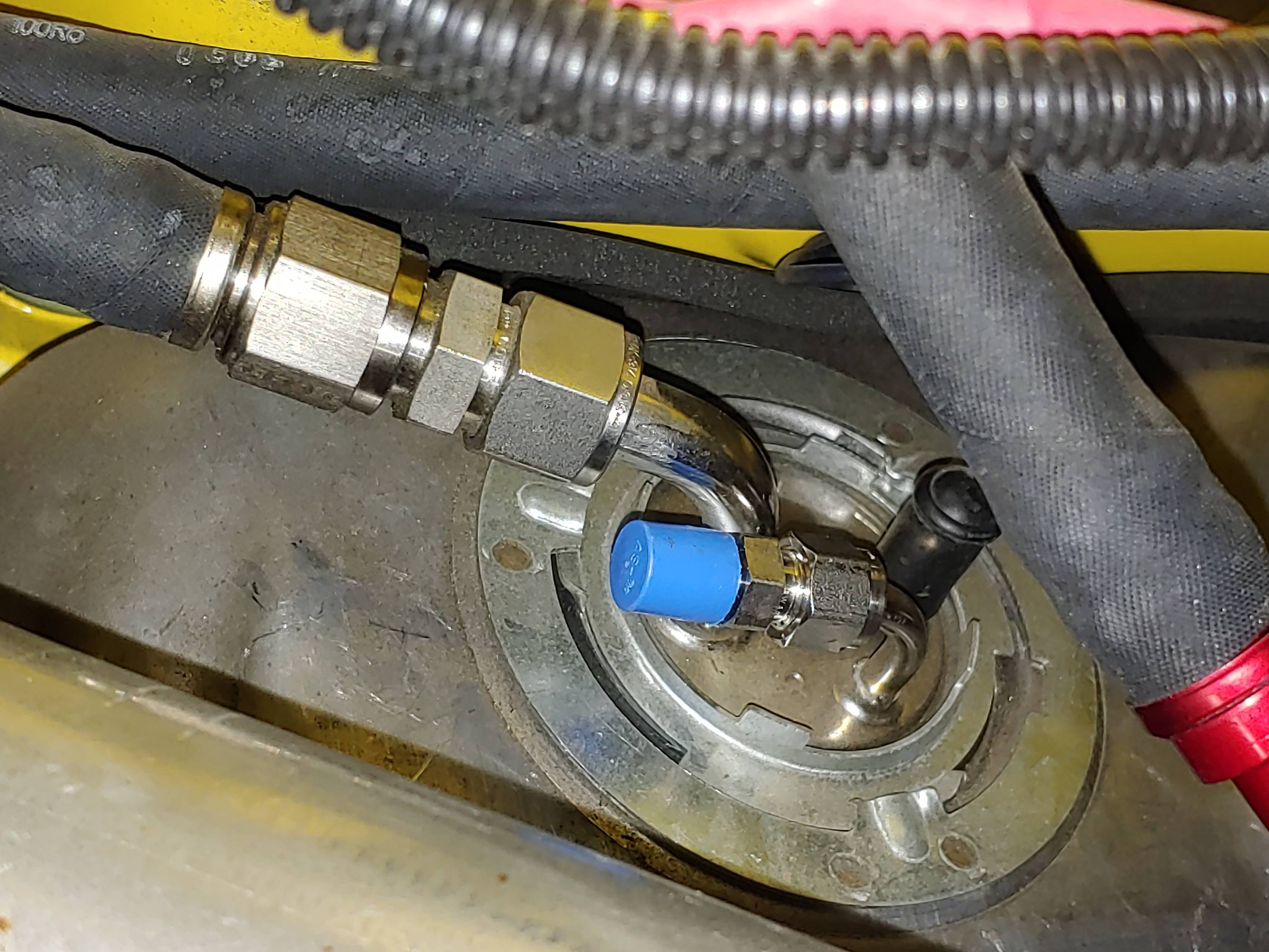

Many variables to consider but as Chryco says a big inch motor can quickly require fuel beyond the 3/8 line (and mechanical pump) limitations. The pump volume and pressure output are obviously a big part of the equation, as are fittings and filters. But even powerful pumps run into fluid flow restrictions that need more line cross-section. Its not hard to run 1/2 SS tubing in an E body. There are 1/2 inch pickup/sending units with 1/2 inch sock.
I cut the tube flares off the pickup and replaced with Swagelok tube-to-AN adapter. AN-8 is 1/2 inch equivalent but even in -8 fittings you can see the restriction.
I run an Edelbrock pump with 1/2 npt ports to a Fram post filter with 3/8 npt. 3/8 npt to -8 are common and the Fram ports are same size as -8 fitting passages. The pump requires an external regulator which I custom bracketed to the mech fuel pump blockoff plate. From there regular 2 separate -6 hardlines go to each AVS carb.
I also put a Swagelok union in the underseat area so the 1/2 SS main line can be installed removed as 2 pieces.
