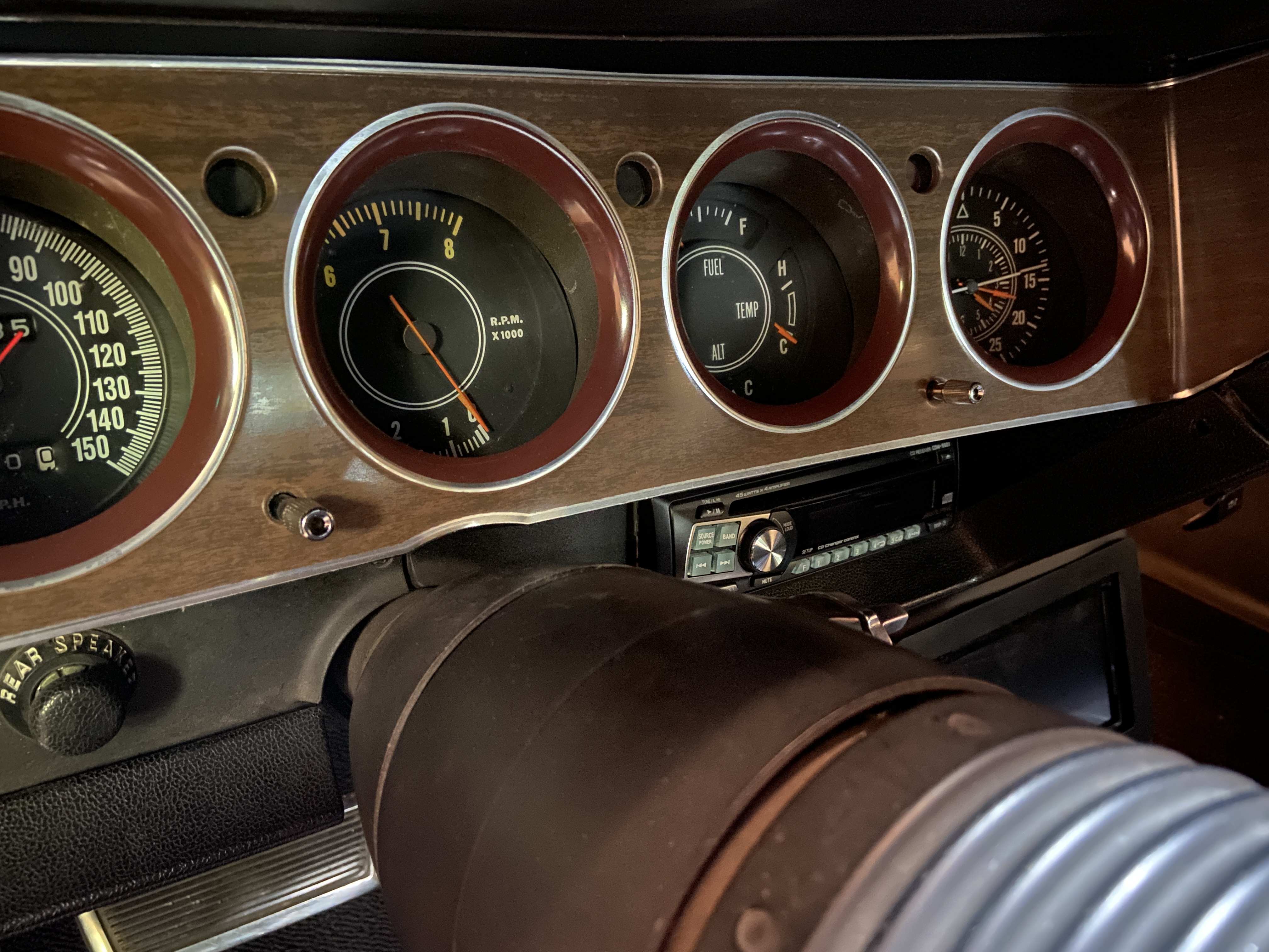

Can anyone recommend a gauge restoration company? The only thing I found online was lists of companies that do restoration, but I did not see anything on forums on whether they were any good. My friend used a well known company and said he had a terrible time with them. I don't want to send my cluster to someone and wonder if and when I will get it back. I have a rally cluster from a 1970 'Cuda. The speedometer needle is snaped off and the stub that is left bounces up and down. The clock also stopped working. But it's just kinda ugly from age. I already replaced the "simulated wood grain."

Thank you. The tach is good. I had it refurbished back in the 90s. My problem is neither the clock or the speedometer work. Another of my hobbies is antique furniture, including clocks. While I have only repaired 19th century mechanical clocks, I may be able to figure out this clock, but I don’t know about the speedometer. I bought a reproduction for $400 and it looks great, but it broke after about a month: same needle jumping up and down issue. But, I have the needle from it. That is what is in the picture. Notice the needle is a slightly different color.
But, I changed the cluster myself back in the 80s after my mechanic said it couldn’t be done. Maybe I am better off trying it myself. It might be fun. Maybe just send out the original speedometer to get fixed.
