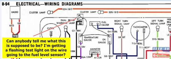

In a rally dash, the instrument panel voltage limiter is only connected to the fuel, temp, and oil pressure gauges, so it makes sense that these were the only ones affected and that they were all responding similarly.
