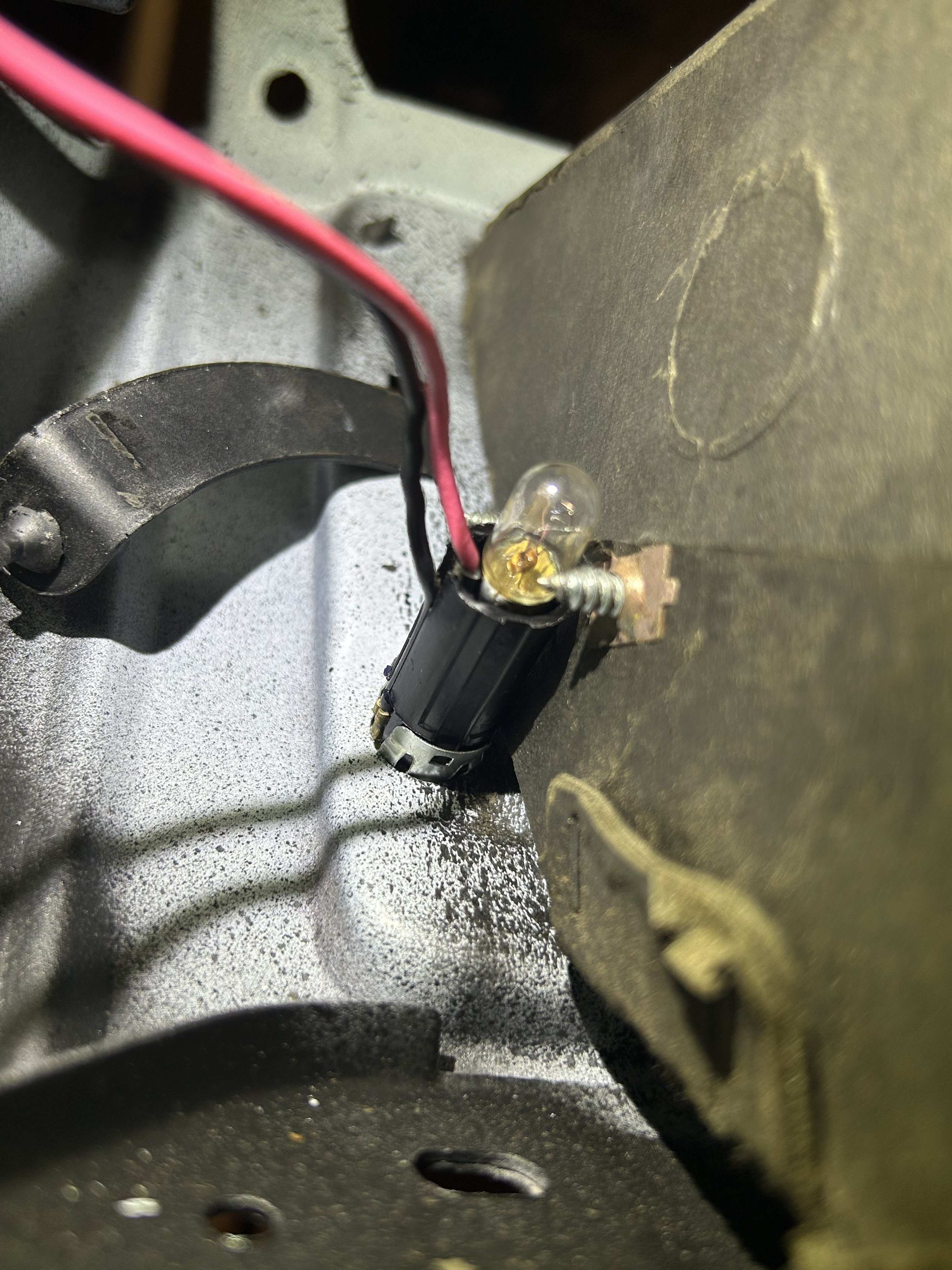

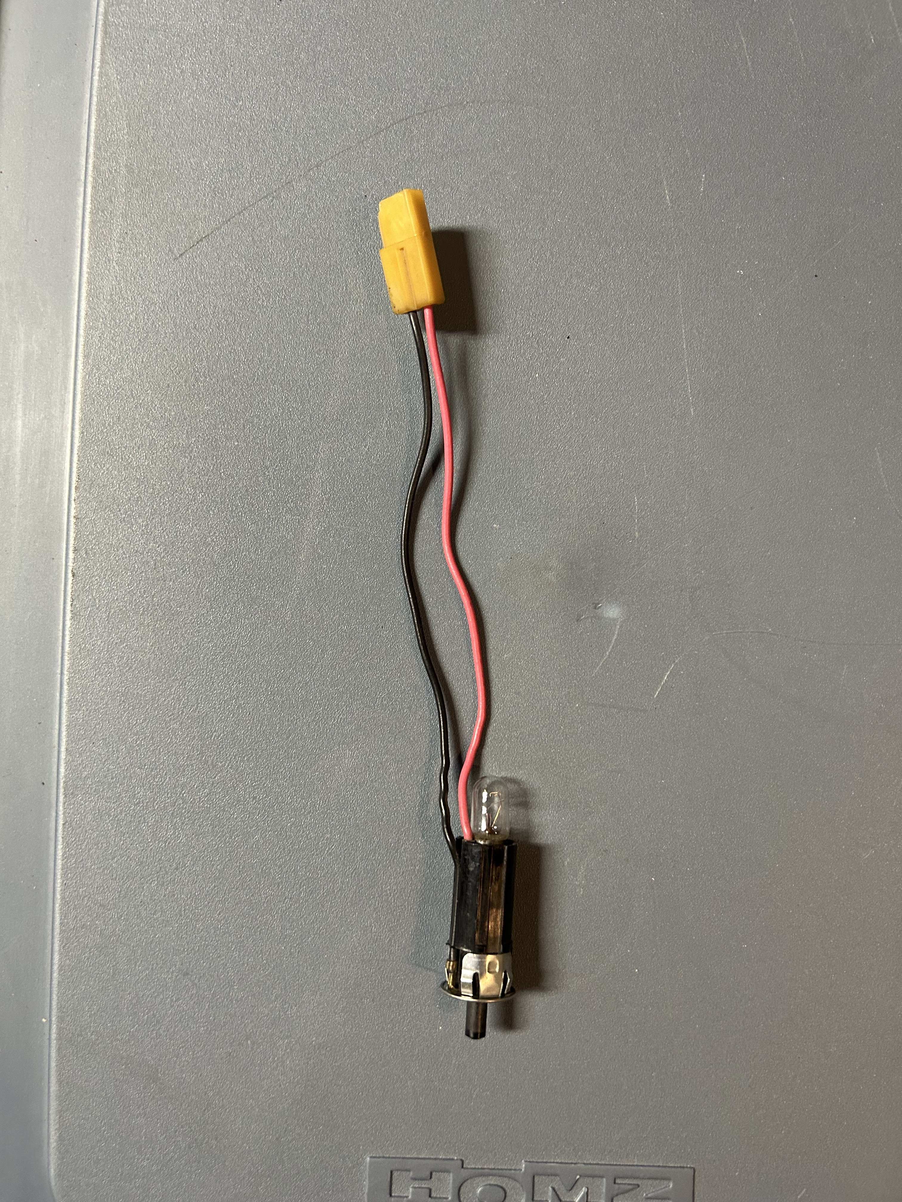

I’ve had this glove box light from the previous owner. Is this correct for a Challenger? Seems to be a tight fit in the hole and the light is short of the knock out for the glove compartment.

Pretty sure that's not the correct 1 for 70.
Should only have 1 wire for power, and a bullet connector to plug into the female bullet hub that has 3 spots.
Ground is provided by the bulb socket to dash frame
They switched to a 2 wire connector on the later years.
Having typed all that, it will work fine.
