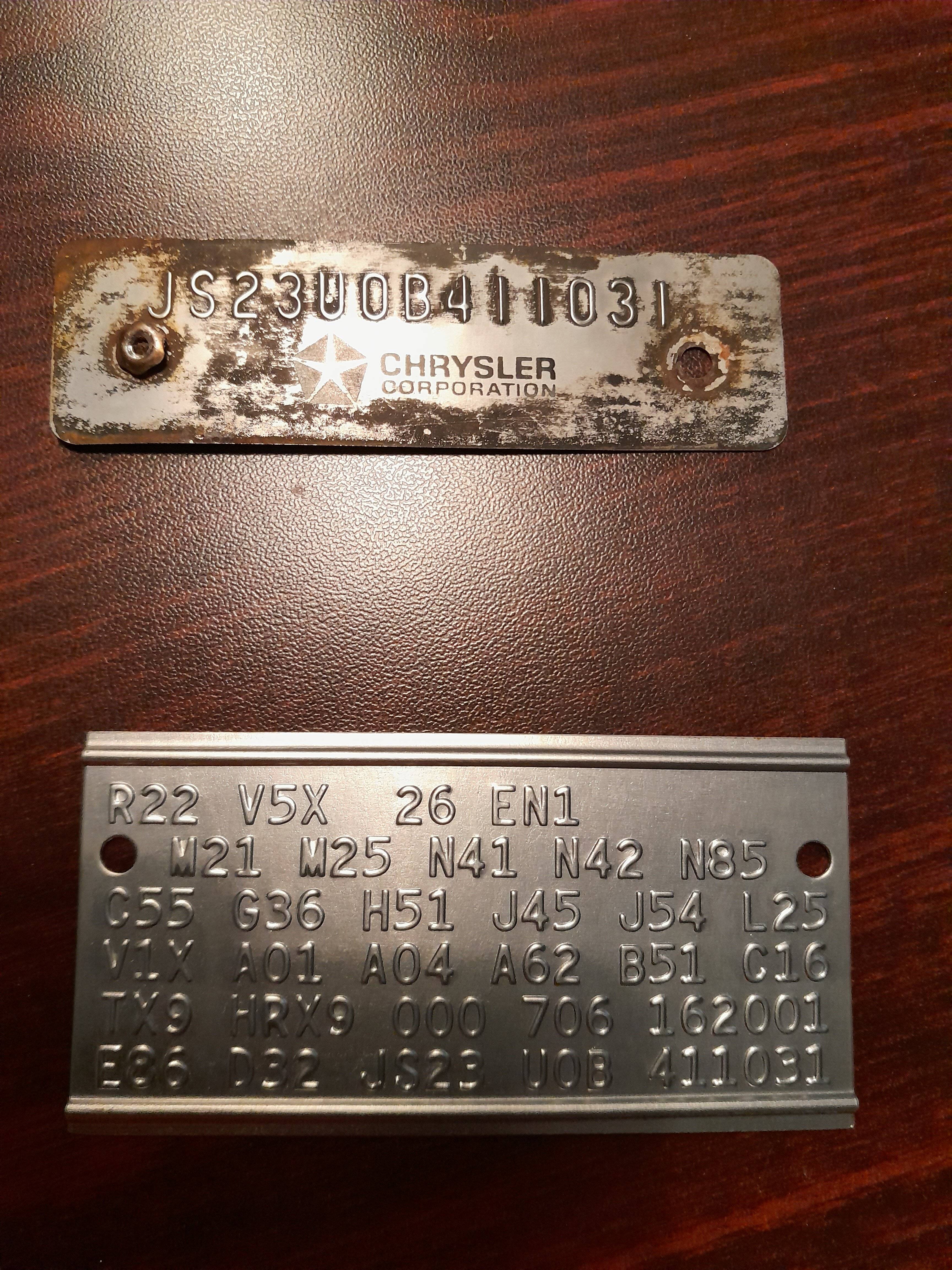

Now it seems, it was an original column shift car, it has no hole for the shifter mechanism, no any signs for any spot welds for center console, and there is a bracket in frame for gear mechanism. But in fender tag, there is C16 code, meaning "center console"?
C55, bucket seats, says fender tag too..
Now i´m little confused, the fender tag is new, it is not attached to the car. Is is made later, i think in USA, by some previous owner. I have original build sheet, exellent condition.
Could there be a fault code in fender tag?

Welcome Could be the fender tag was recreated or the body of the car is not the correct body for that VIN meaning the cowl or rad supprot could have been from another car .

The fender tag looks too perfect. No indication it was ever mounted. No deformation around screw holes etc...And by the description of the rest of the cars condition, highly suspect.
I would ask if the fender tag affected the price you paid.

FYI, the broadcast sheet looks like a column shift car, to me. And the broadcast sheet calls for the 22-inch radiator. But the repop of the fender tag has added the 26-inch radiator. If I'm right, this is very sneaky. Fraudulent and sneaky.
I recommend you post the name and address of the seller here, on this post, for future folks reading it. What this person is trying to do will concern many people. It may be good to know who this is.

The broadcast sheet shows 61 on RAD, so it is a 26" radiator, this is correct for a AC (H51) car. The C16 console on the fender tag is not correct
