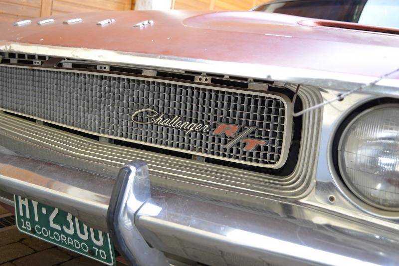

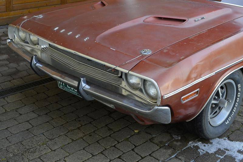

I just started to work on a 1970 Challenger R/T, the car is a survivor, no rust and very original as far as I can see.
But one thing I don`t understand. The grille surounding and the headlight bezels on this car are silver or just polished. Not black or grey as they were on the R/Ts as you can read in all the e-body books. Does anybody know if it is possible that this is original, was it maybe a orderoption? I have seen some R/Ts on the internet that look exactly the same, but I don´t know if they are original. Maybe on my car somebody changed all the parts a long time ago.
I attach a picture of the car and I am thankfull for every information. The car is a factory R/T, I have the fender tags. Thx

Welcome to the site from the Motor City! Looks like a great car but first off, what are the first 5 digits of the vin? That would be a grille that would have come on a JH car(non R/T). Could an R/T have left the factory with an argent grille? Anything is possible. I don't think it could have been possible to order the car that way though. Does it have a fender tag and or a build sheet?

Thanks for your reply! Yes the VIN starts with JS23NOE and the fender tag says the car has a A63 molding group, could it be that?
Thank you, best regards

somebody along the way just stripped the black paint off the grill and head lamp buckets.
All R/T's were blacked out and all nonR/T cars were painted in argent silver.
The black paint was a little bit less shinny than a semi-gloss.
I believe (not 100% sure) that the paint is available.
Hope this helps some.

A63 didn't specify anything about the grille so I dont think that had anything to do with it. It was likely as stated above, somebody stripped the black off for one reason or another. 45 years is a long time for these cars to be messed with by who knows how many people. I have a lot of unanswerable questions about all of my cars and I wish they could talk.

It was very common, when the cars were just used cars (1980's), for people to strip the paint off to make a chrome looking grille. That is what was done to your car. I have seen a few R/T's with argent silver grilles. Oddly enough, they were all Sherwood Green cars.

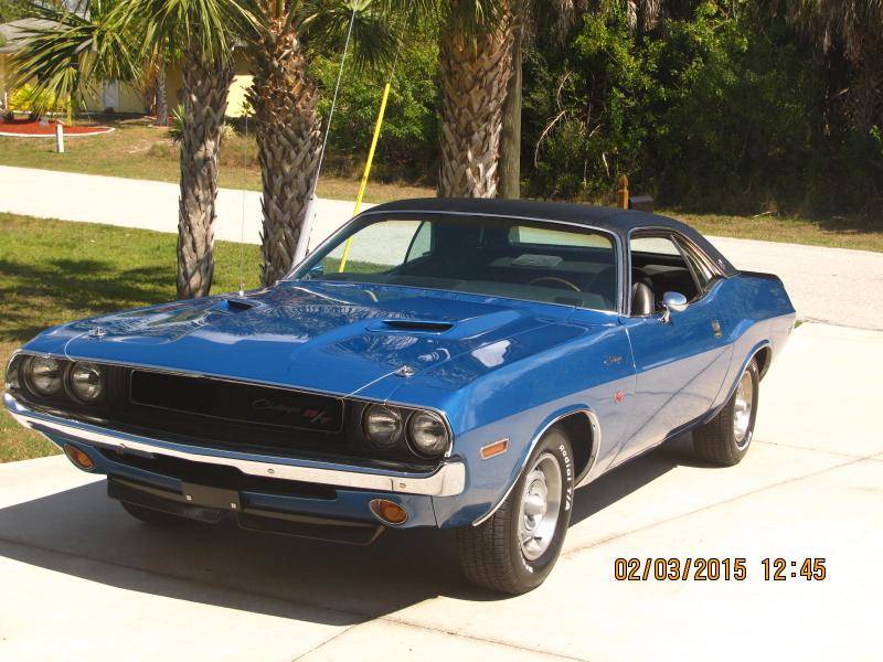

My grill is the original one. The build date is August 1969. It's an R/T S/E and the color is argent. The same color as on the rear body panel. I have photos in the Photo Gallery. I have before and after photos. The before photos are original paint.( I don't care for red so much).
