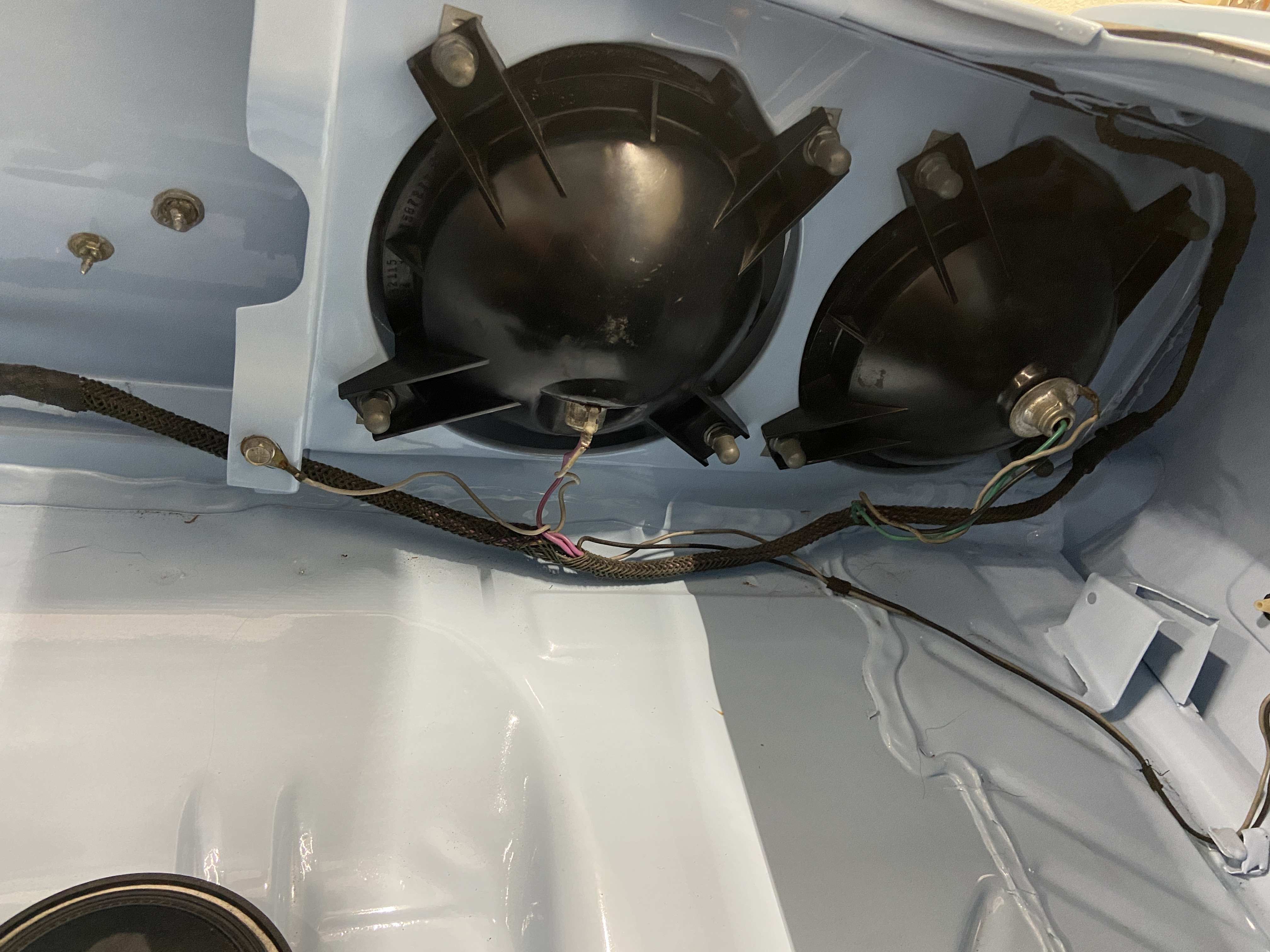

Hi all, can someone please send a photo location of the rear lights, back-ups, etc. ground wire attached to body?

My 1973 Barracuda rear light ground location is next to the drivers side reverse light. It is the grey wire that goes to all of the other lights.
Ronbo73
May 27, 2021
137
49
Dudley, MA
This is the original location of my ground prior to repaint. I just used a belt file to remove paint under the ring terminal and bolt, added some dielectric grease and no issues. I tested the entire rear harness and no issues with a bad ground. I am well aware of grounding issues so I took great care to make sure all of my grounds have good contact with metal.
