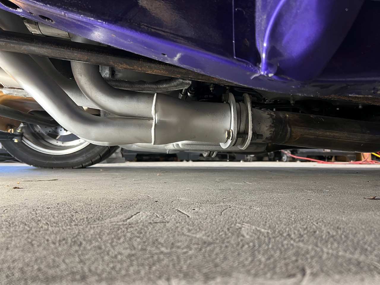

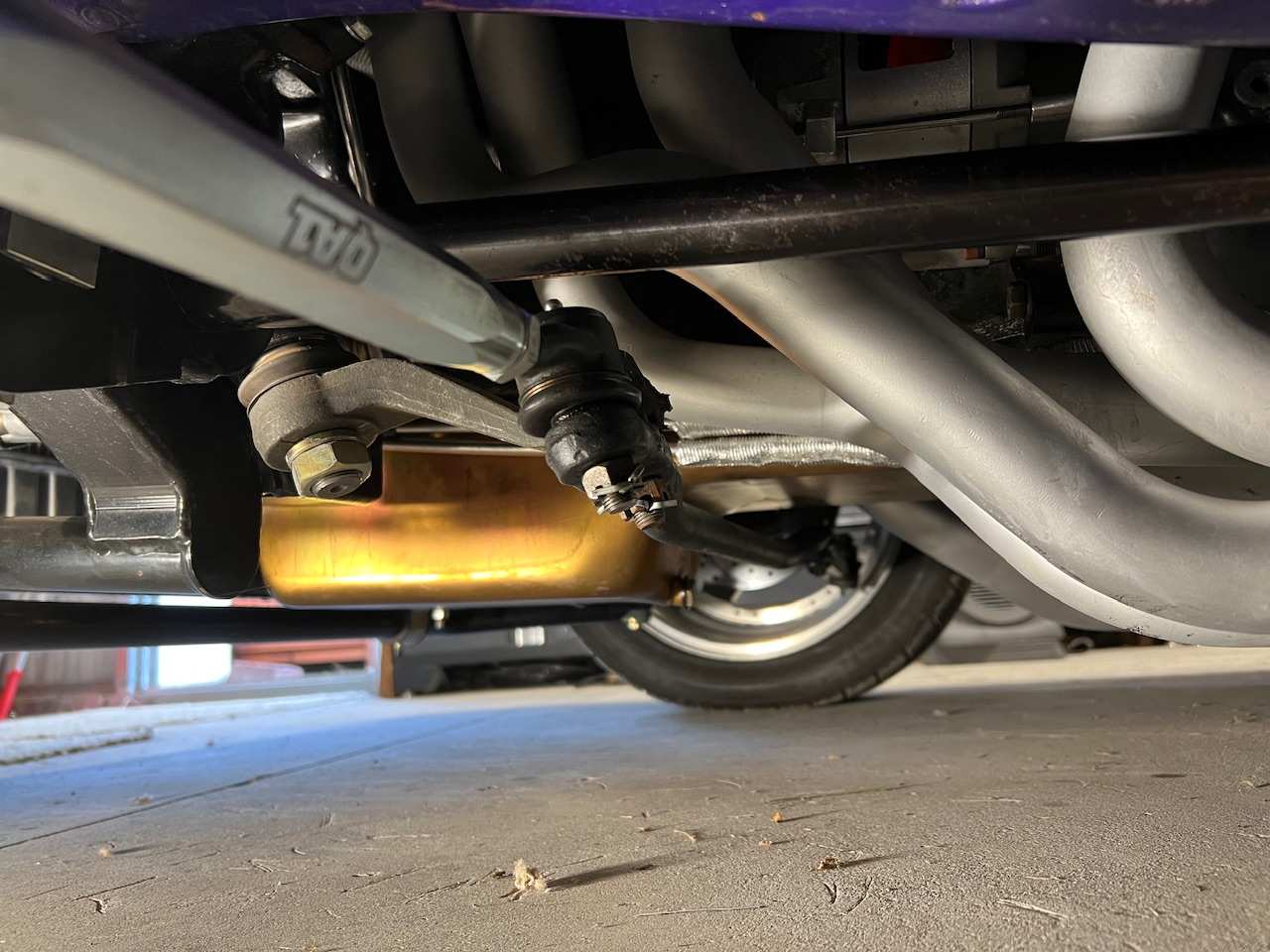

How much clearance can I expect to gain if I switch to a set of TTI’s? Right now there is 3-1/2” between the bottom of the flange the ground.
This is a ‘70 Cuda, 383, 727, QA1 suspension up front. Hedman Elite Series are in it now.
Any advice is greatly appreciated, thanks in advance.

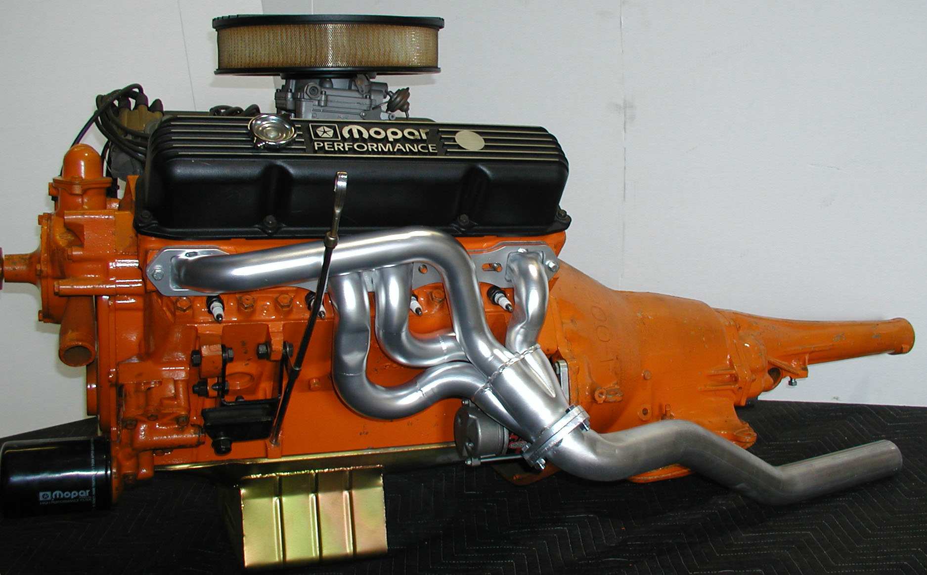

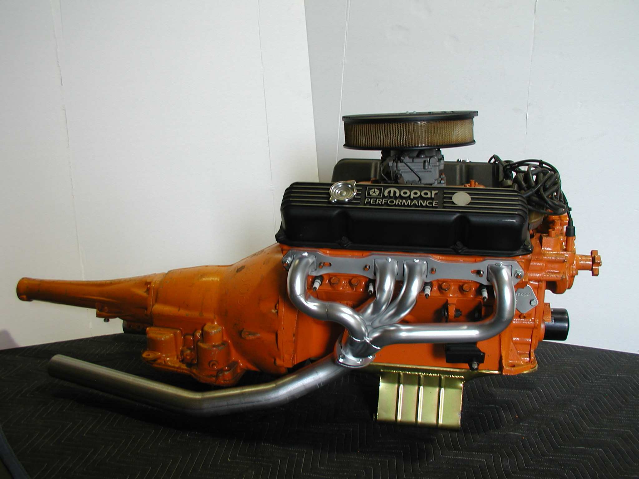

Sam from TTI emailed these photos to me and said I’ll gain about 2” using the shorty’s. For sure, the best way to gain some clearance and stop scraping on things.
