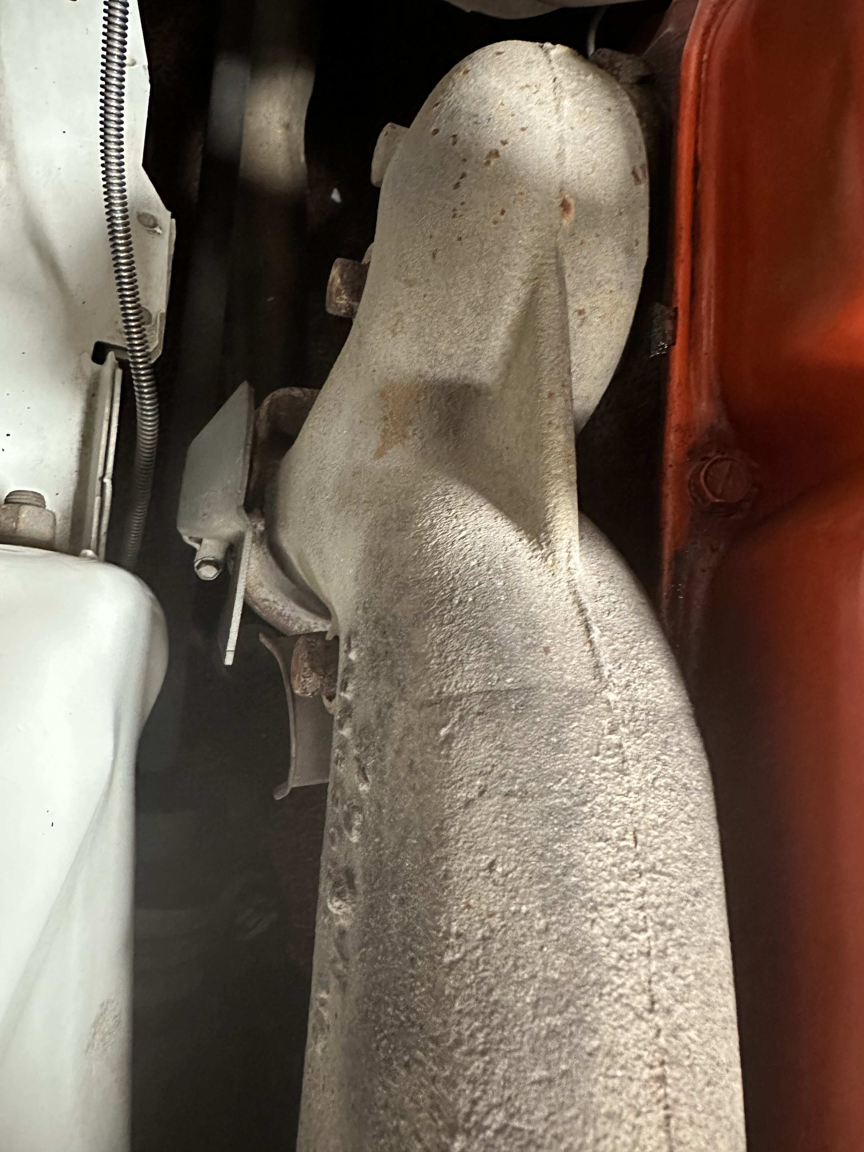

Does anyone have a preferred method or pictures for blocking the heat crossovers on 383/440? I understand the downside of closing these ports when it is cold but here in Phoenix I am having issues with hot starts given this generation of fuel. I see the the Fel-Pro gasket 1215 has them already blocked. Is that enough or could thr exhaust heat burn thru this gasket? Any info here would be appreciated.

Use the gasket and make sure the heat riser is wide open. It can be wired open, the butterfly removed, or the butterfly and shaft removed and the holes tapped and plugged.

Would you happen to have a picture of one wired up? Or suggest the best place to wire it to?

I just cut out the butterfly on an 89 Ramcharger manifold; I was going to drill & tap the manifold but found hardened inserts for the butterfly shaft. It might be possible to drive out the inserts but I just put a 5/16 bolt all the way across (still much less restriction than the butterfly). The butterfly was welded to the shaft so I had to use a dremel to cut the welds down, allowing the shaft to slide out. PITA. I probably should have used my cutting torch.
