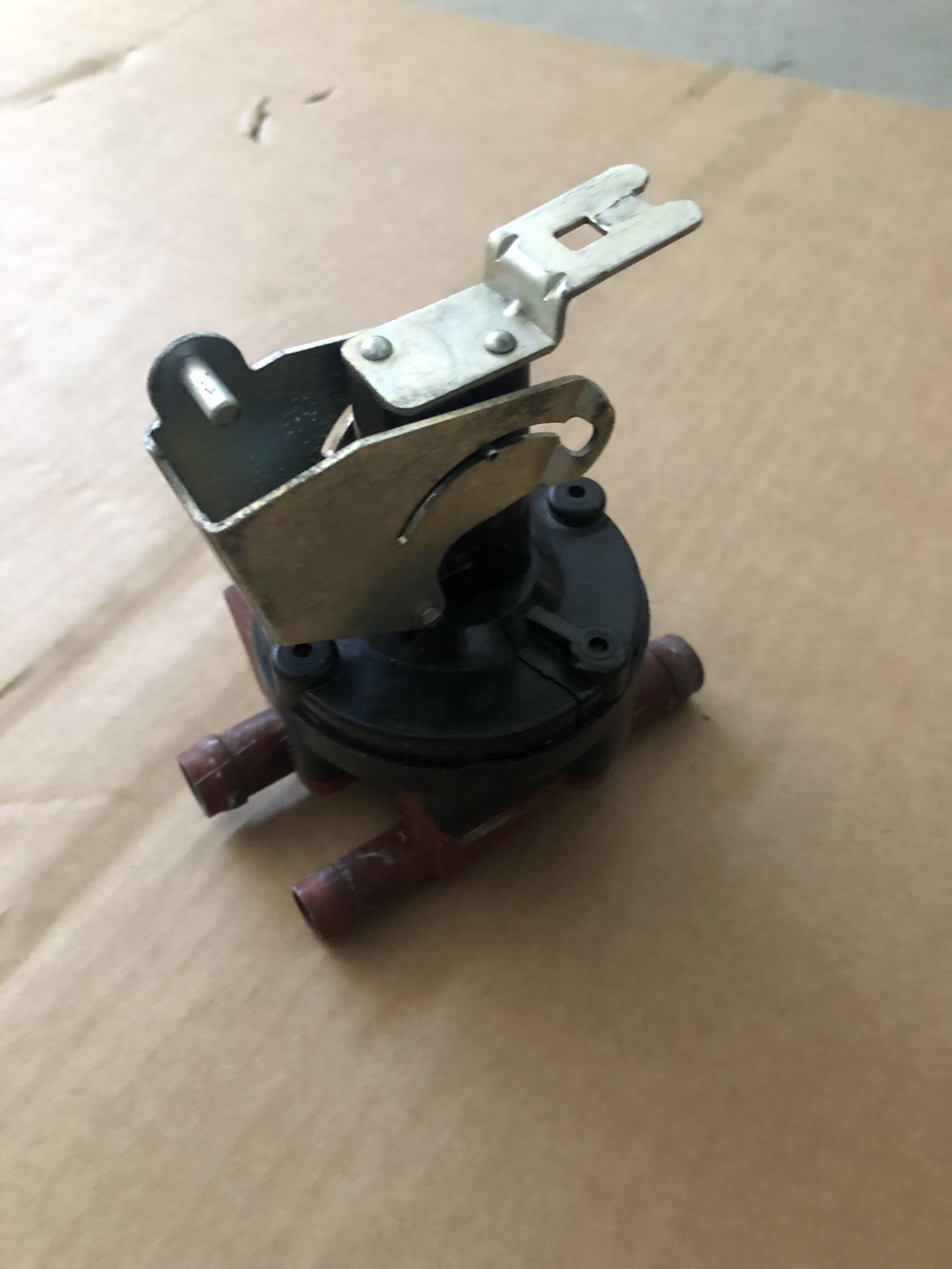

Does anyone know where to get a heater control valve for a 72 that looks like this ???

The original style can be found on ebay-
However those valves are prone to cracking so if using on a car that's going to be driven a fair amount I'd go with a metal one instead, better design.
There are some aftermarket ones available also that should work and cost less, check NAPA, RockAuto, etc.
moparleo
Oct 17, 2011
7,102
1,886
Beware. There are several similar heater control valves but they have different valve ratios. H30-110 is the correct number stamped on the valve.
Just Google #3502346 for sources but make sure the above number is on the valve.

the one I got lasted 3600 miles and split across the top! (and I had a heat shield on it ! :(
so with
went with the later model metal one
