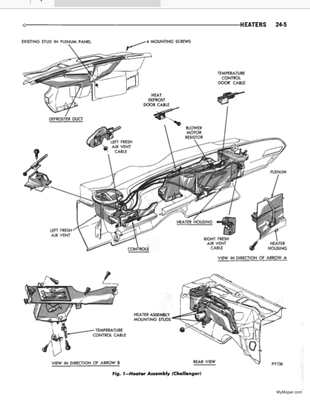

I am looking at replacing the heater core on my 73 Cuda not AC. In reading other posts about it is seems like 3 fan motor bolts 2 vent door
connections and Fan Motor. Has anyone else replace one without AC? it that all there is? Also do you think replacing the air box parts are necessary if you have take one apart? Thanks for any future response.
J hook to vent also. When installing the 3 nuts are the ground.
