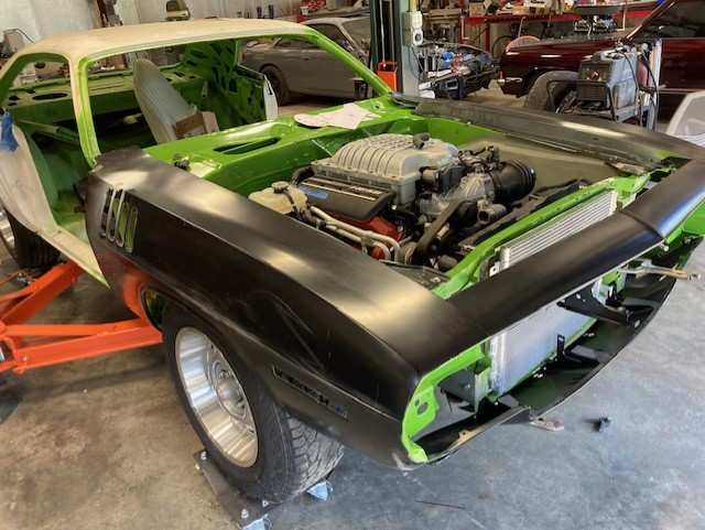

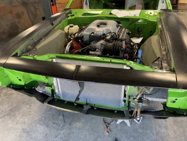

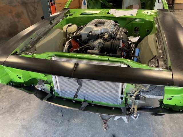

Installing Radiators, AC Condenser, Inter cooler Hoses and tank, AC lines to new Dash (2016 Hellcat) and coolant lines. looks like stock coolant tank too big to fit. Will need custom tank. Intercooler pump and secondary air inter cooler
attached under Left fender. Fenders and front end temporally attached to check fit. Just want to show recent progress.

Looking good! All you lack is finishing up.
No really, that’s going to be a very cool ride. My cousin is doing a similar conversion. Thanks for the update

Installing Radiators, AC Condenser, Inter cooler Hoses and tank, AC lines to new Dash (2016 Hellcat) and coolant lines. looks like stock coolant tank too big to fit. Will need custom tank. Intercooler pump and secondary air inter coolerView attachment 127874View attachment 127875 attached under Left fender. Fenders and front end temporally attached to check fit. Just want to show recent progress.
Looking good! Are you using the stock 2016 radiator, AC Condenser and Inter cooler. They look like it fits very well.

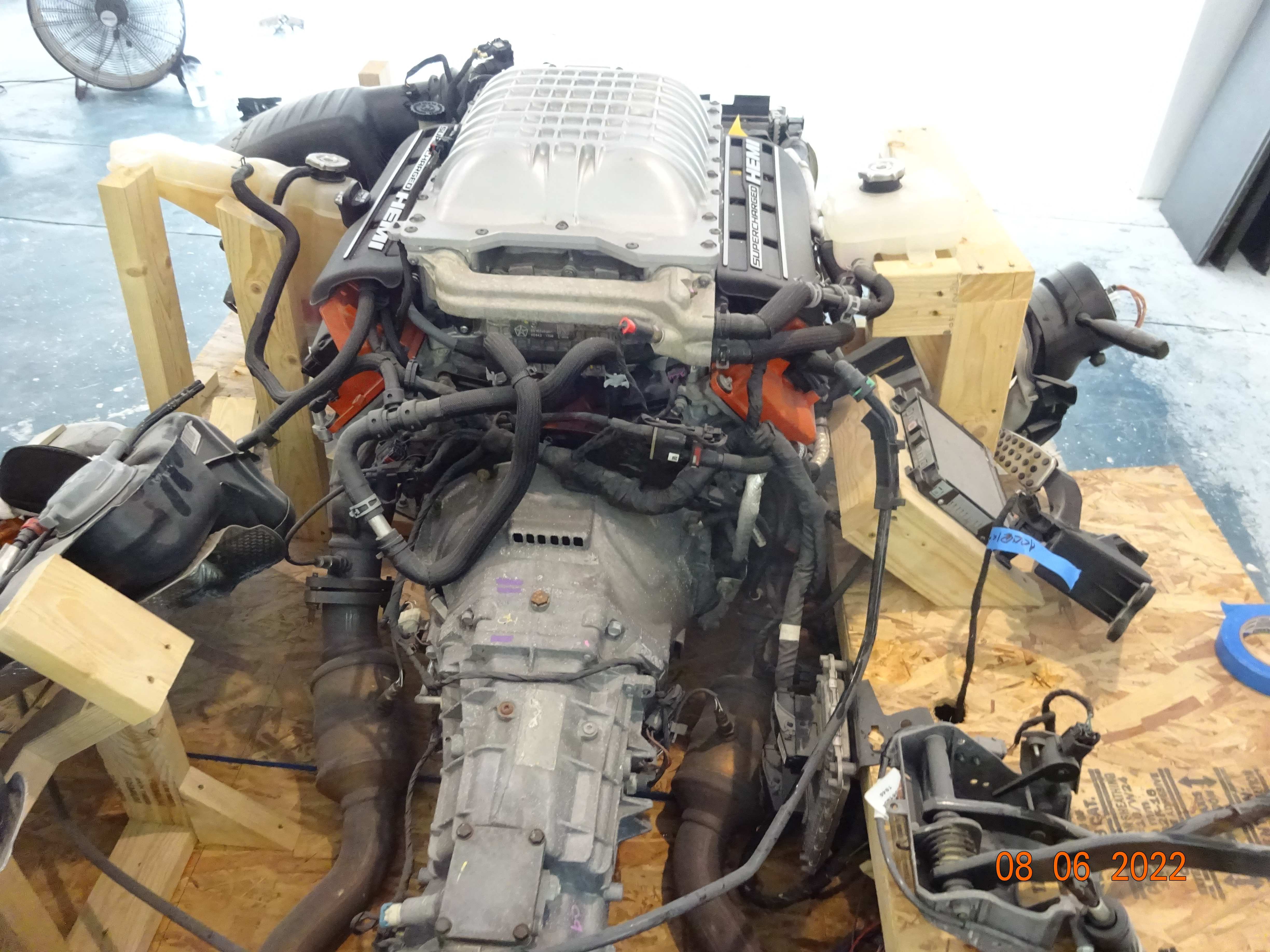

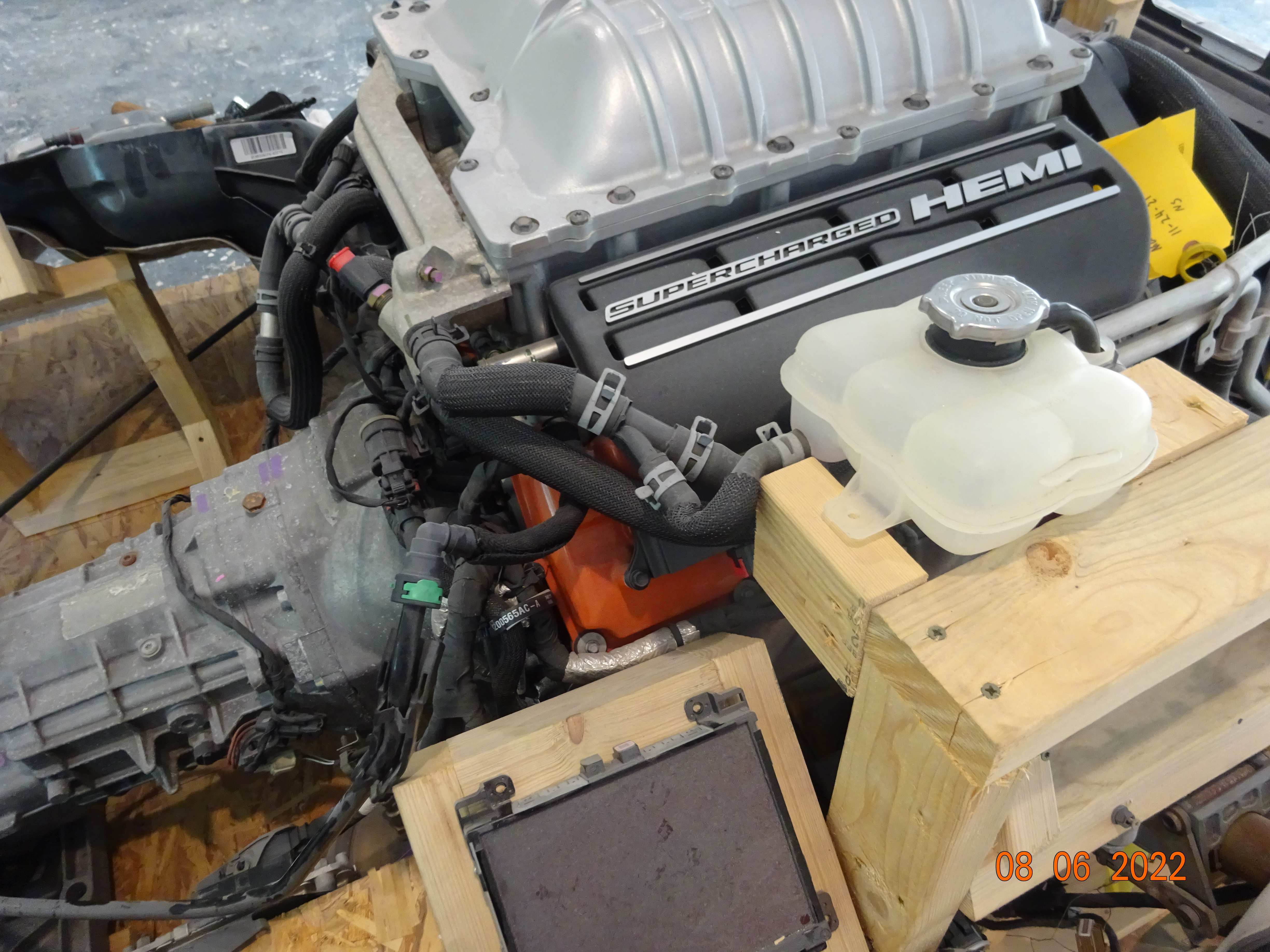

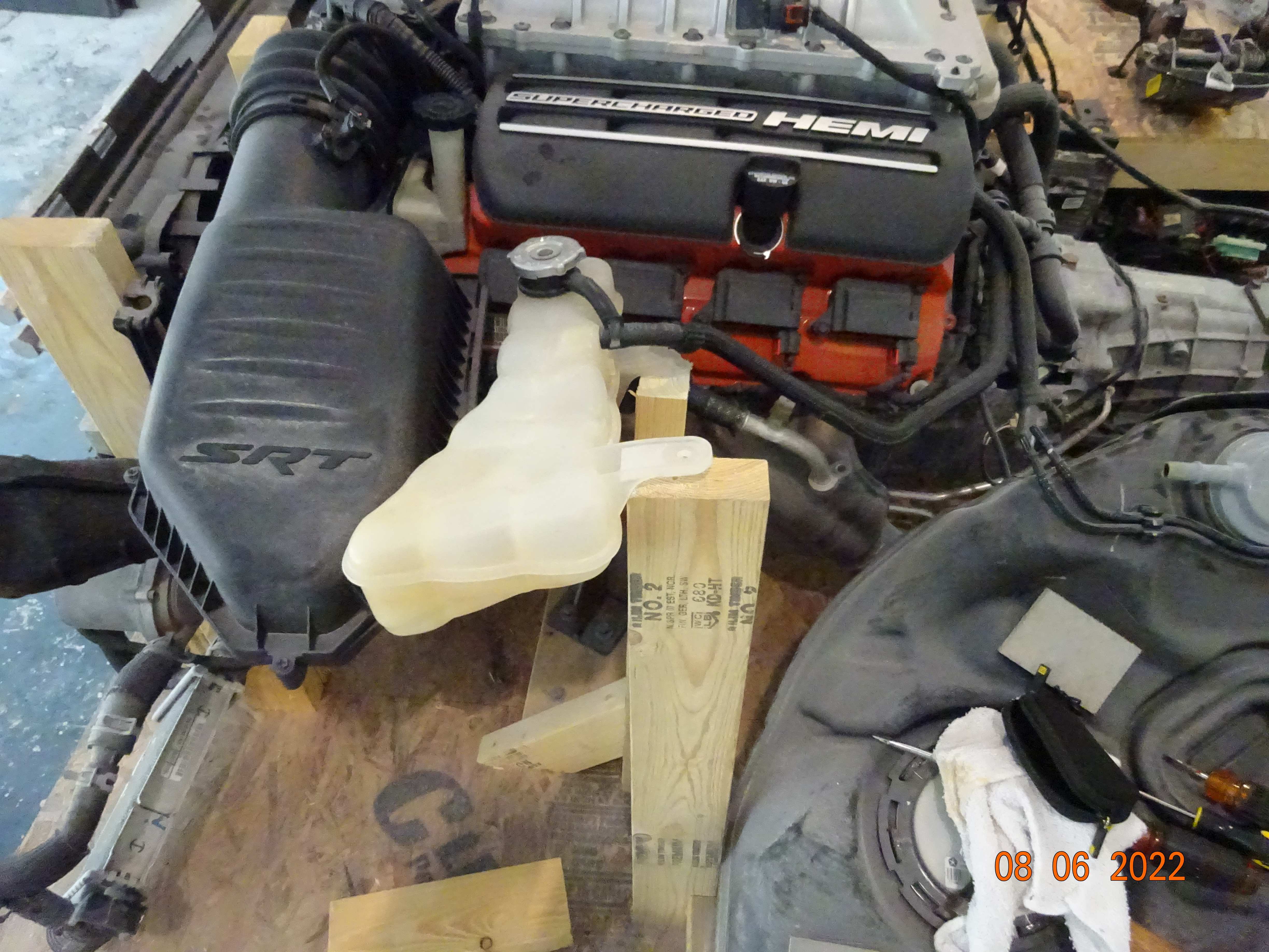

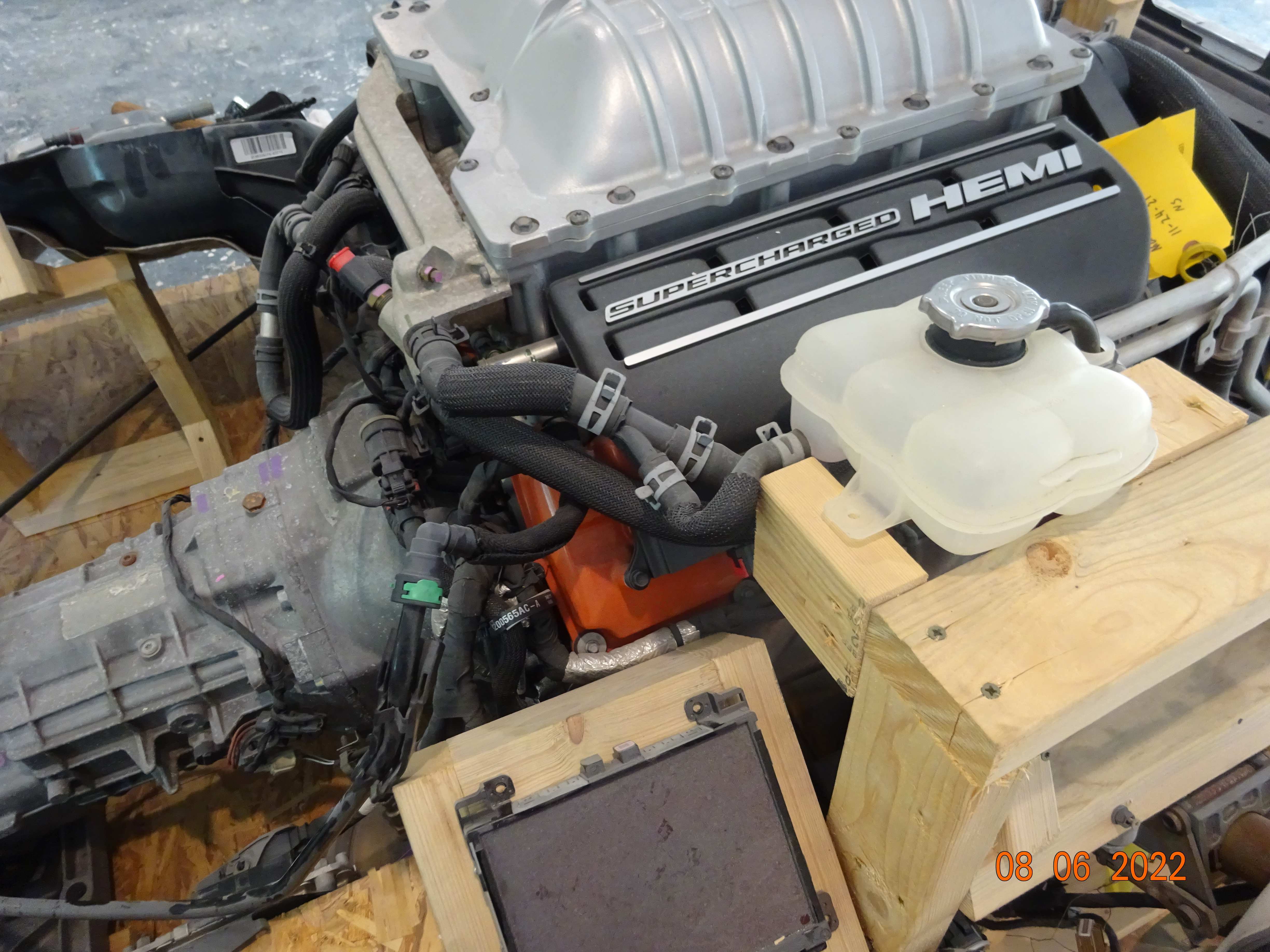

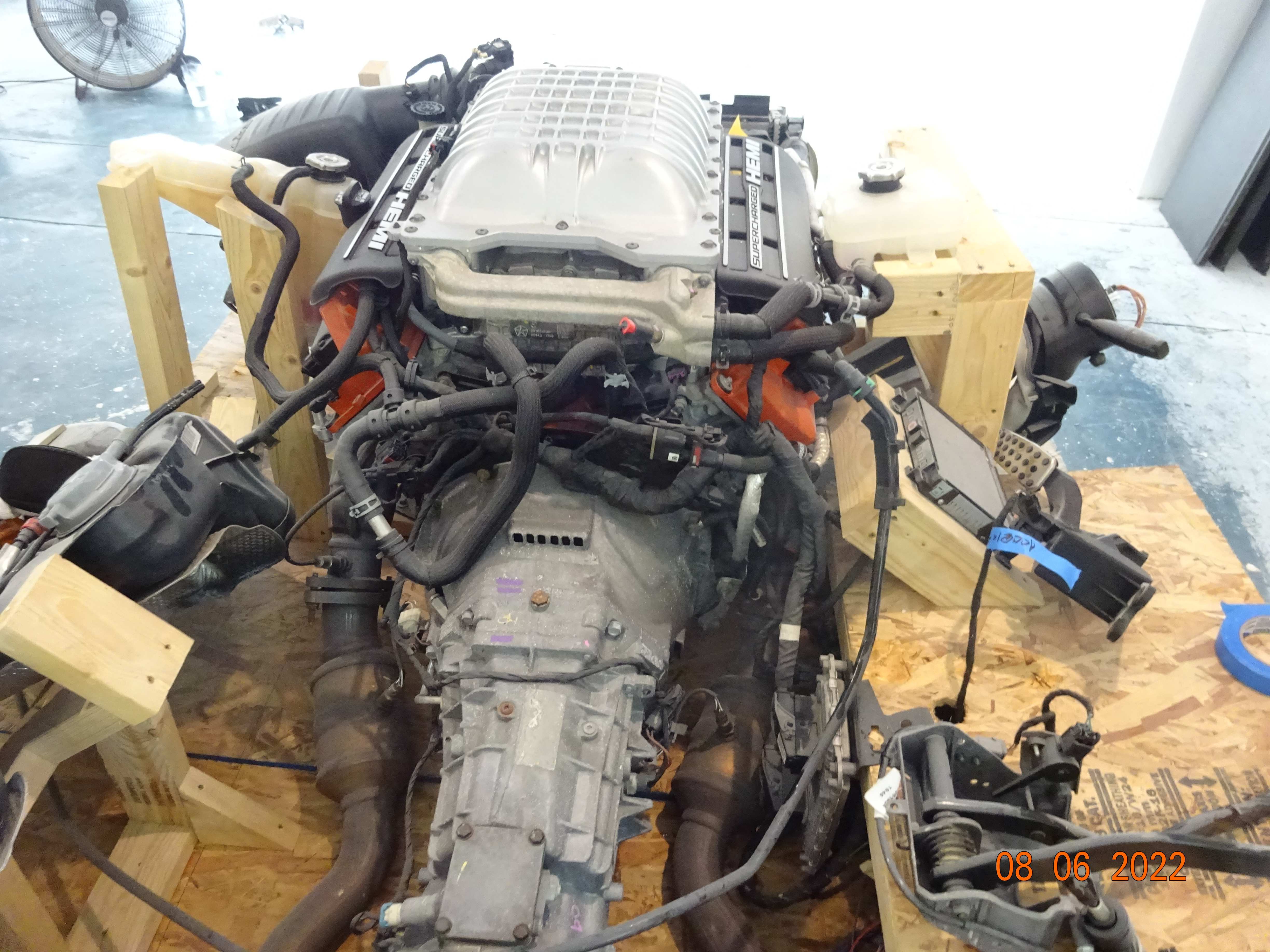

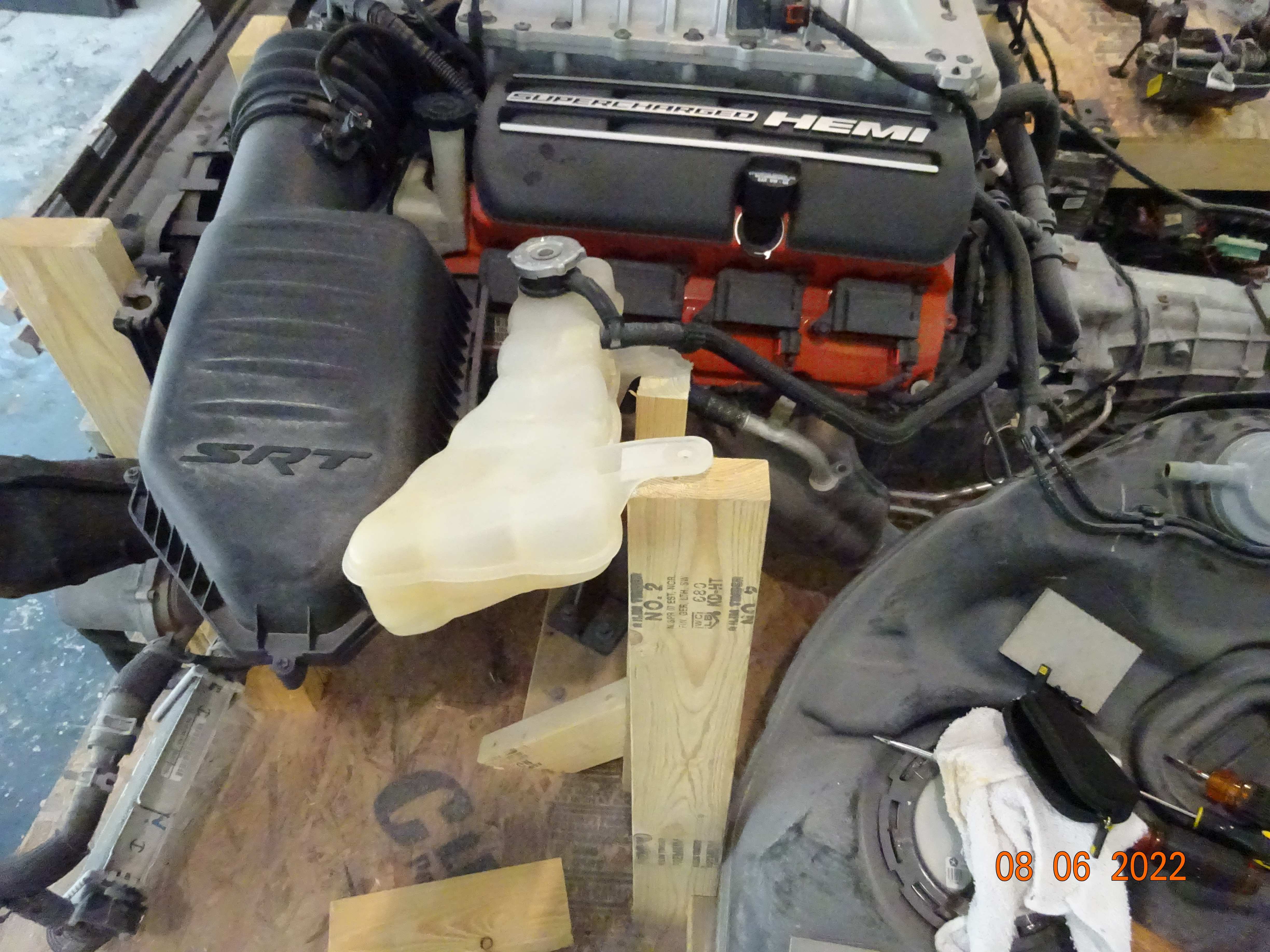

I have the original Hellcat wiring harness the included instruments and steering column 7 steering wheel.Pallet Engine 1.JPGPE2.JPGPE3.JPG
