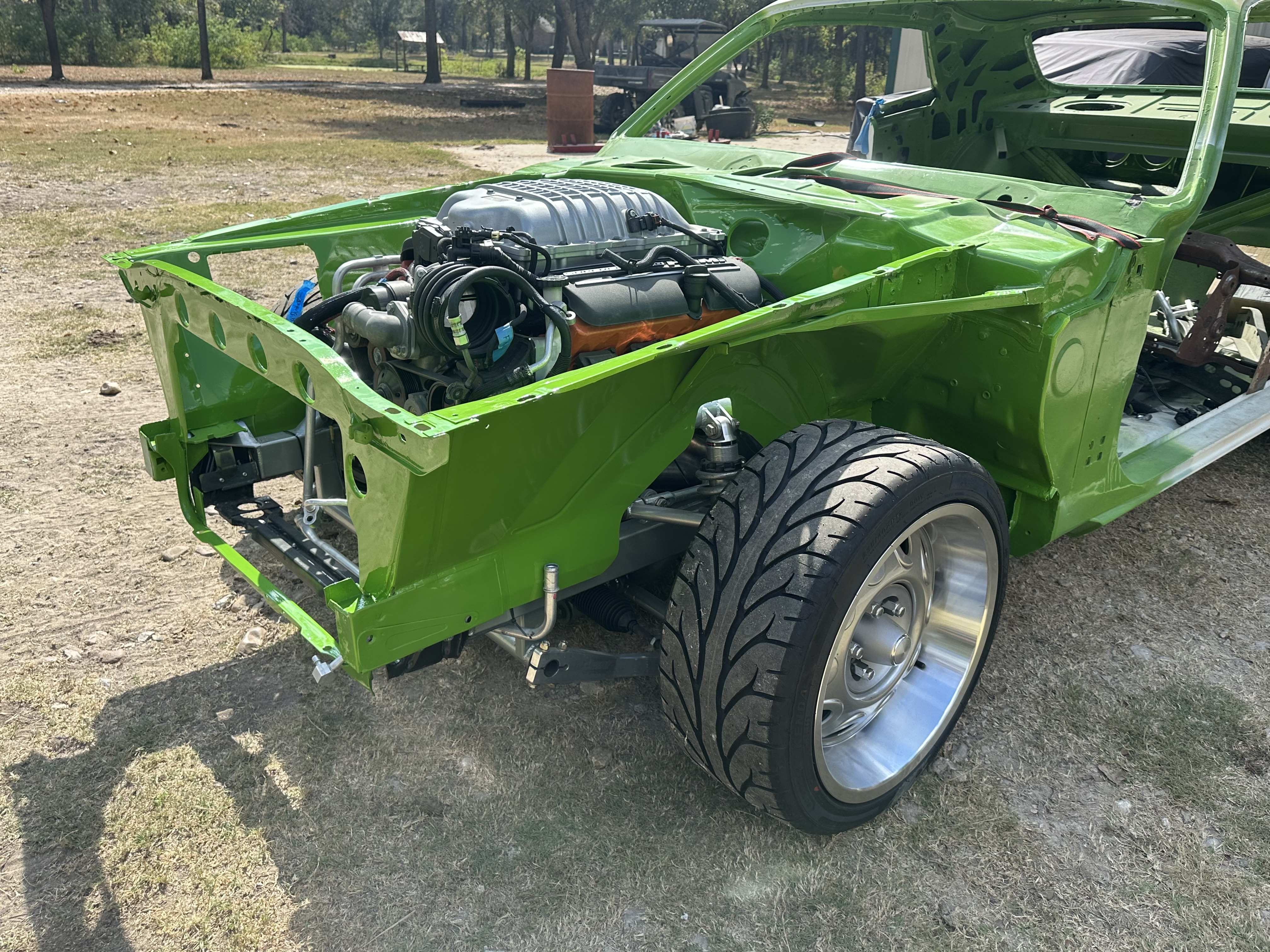

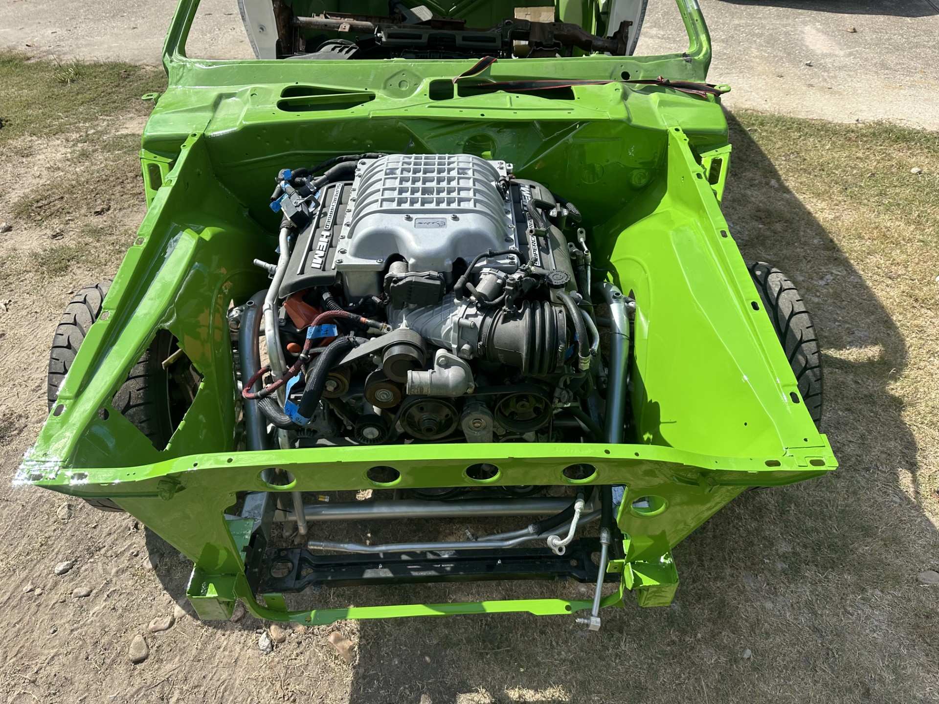

I am in process of the Hellcat install in a Cuda. It has been "a journey" to get it put in car. You have the oil intercooler, 2 water to supercharger intercooler (A small secondary with an independent pump). Costing a fortune to do. Unless you don't mind spending the money, I would recommend the 6.4. Good performance at significant savings.
I don't regret my Hellcat install as I knew up front it was going to be very expensive. I was still surprised.
Look at my posts and you can see the problem with available room in engine bay. You will have to make custom brackets for all the accessories and install extra intercoolers in fender wells.
Whatever the route you go enjoy and good luck.
