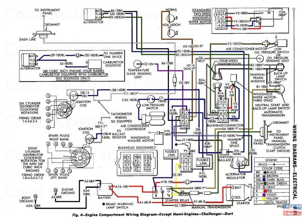

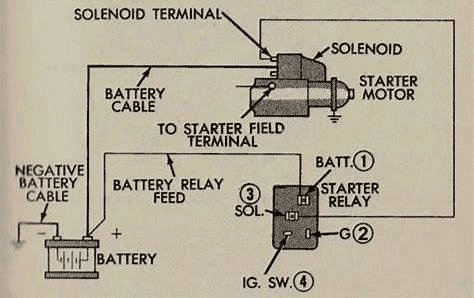

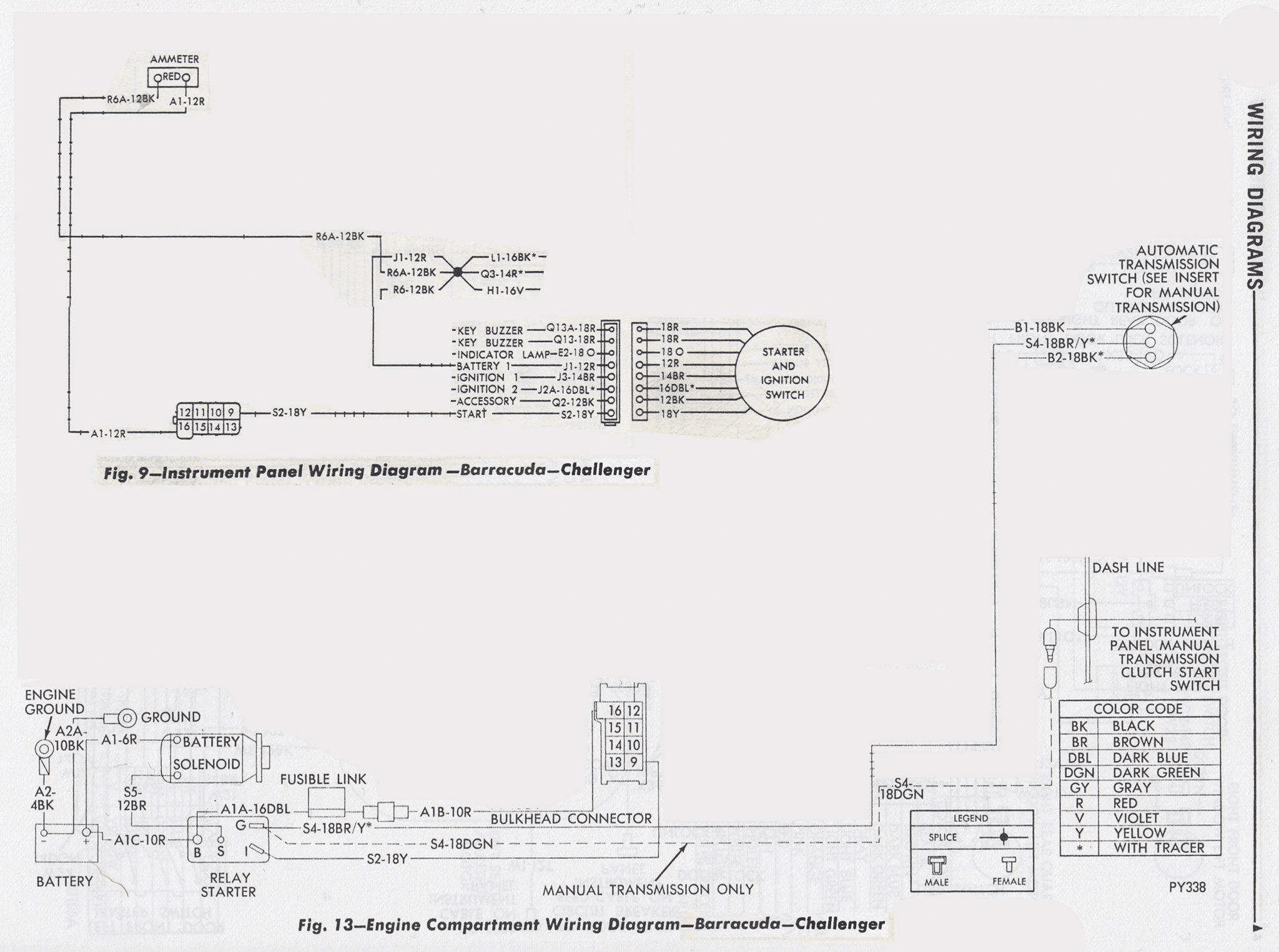

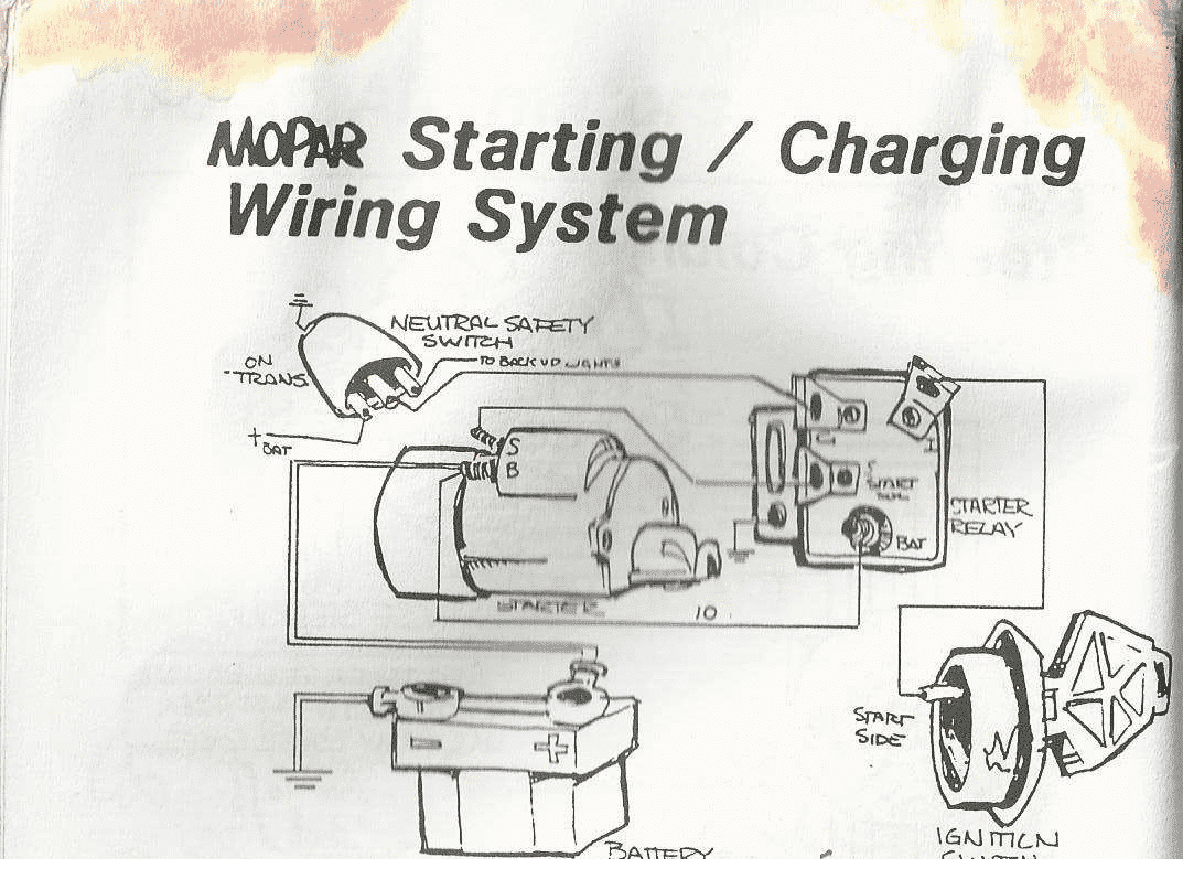

Here you go. The relay has to be grounded. Check battery terminals on battery, starter. Then go from there. The starer relay has to have a ground.
