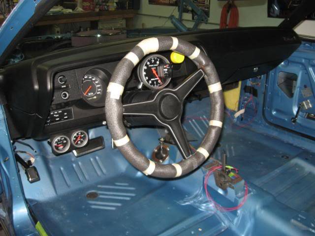

You should not have to farm out the dash install. Get a service manual as suggested. A parts manual has good pictures and comes in handy, too. Get the CD versions.
Assemble the dash on the bench. There are 2 lower bolts by the door jambs. Rest the dash on those and then flip it up into place. Install the top bolts at the base of the windshield in the vent ducts. Slightly easier if the windshield is not in place and a buddy helps. Then hook up the electrics, vent cables, steering column, etc. Not hard.
burdar
Jul 10, 2009
521
30
IOWA
The above post is correct. Once the dash is assembled, the install is very easy. 6 bolts and that's it. Just make sure the two steering column studs are removed first. If the studs are inplace, you won't be able to swing the dash up into place.
