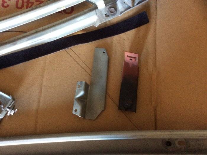

I’m installing the regulators and hardware in my 70 Challenger doors which I didn’t take apart.
These where in the bucket of parts ,and was wondering if they even go in the doors.

The silver piece could be the remote mirror cable support attaches to the driver front edge about halfway up.
The brown part is a support of some sort could be heater control or dash support L/H side

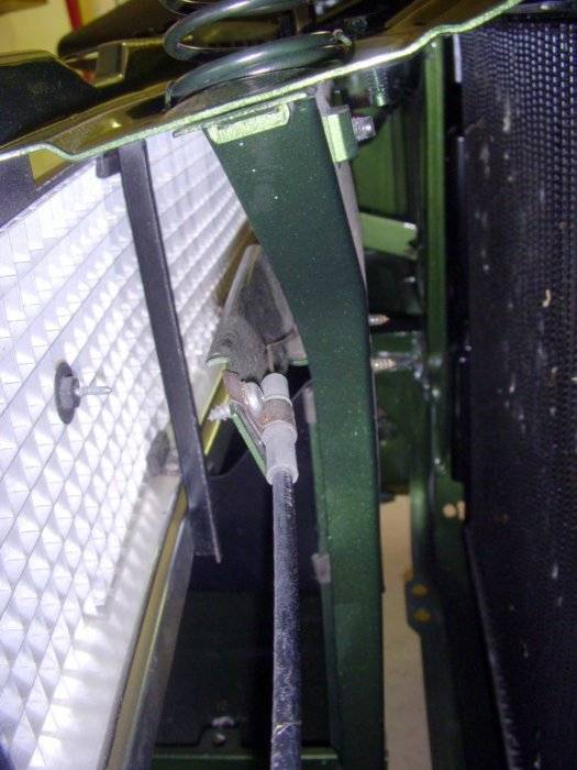

The brown/black one looks just like one of the headlight bucket bracket supports on my 71 Challenger.

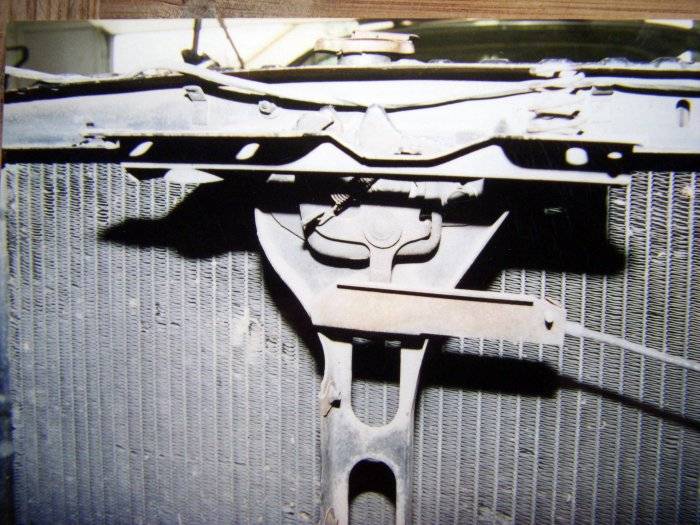

The silver part is for the remote hood latch. It attaches at the latch under the hood. It is a guard to prevent someone from reaching behind the grille and popping the hood latch. The second part goes from the headlight buckets to the radiator support to help support the front of the fender.

The bracket is at the bottom side of the headlight bucket.

I should have gone back and looked at my pictures for the headlight bucket bracket. I knew it was in the front end area somewhere:lol:.
