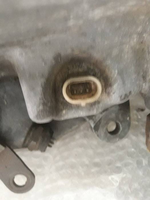

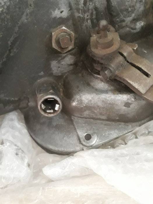

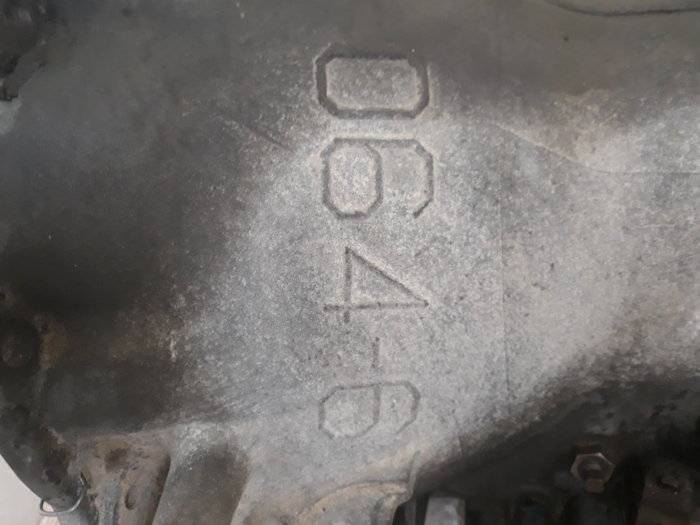

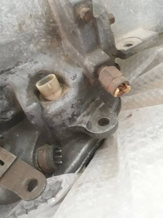

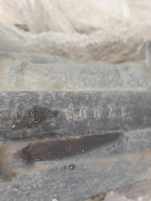

hello guys I just purchased this trans as an a518 to install in my 1970 barracuda I would like to rebuild it but I need to identify it first any help will be appreciated

great do you have an idea what year is it did it come from 318 or 360 magnum cuz im mating this to a 360 magnum is it a lock up or non lock up thank you

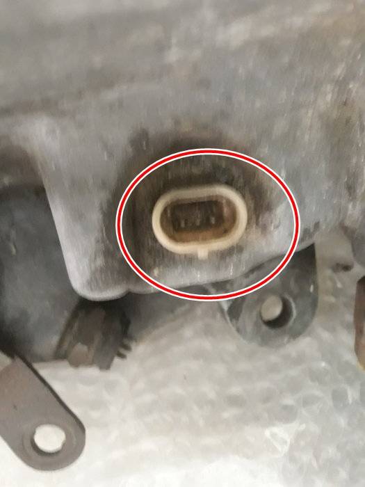

I know patc do the PATC 727 to 518 / 46RH Conversion Kit for this trans but I need to change all the plugs attached to the trans body as they are all damaged
Could it be an RE, either way it’d be the same for 318 or 360.
The 3 pin connector picture identifies it as a RH lock up. The RE has a 5 or 7 pin if I recall correctly.
I thing 318 magnum is differently balanced than 360 magnum
The 318 and 360 are balanced differently, but that has nothing to do with the transmission itself. You just need the correct flexplate for the engine. Also, you need to use only a Magnum 5.9 flexplate, as a LA engine has a different balance weight.

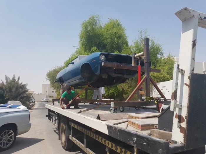

thank you all of you guys here from Qatar 13000 miles away here is Mopar lover going to the paint although her paint is nice but no restoring:) I took the front and back end off and made it as a seckewer for the paint guy while im figuring out what shwartz chassis will be under her looking like?????
fighter
Dec 6, 2011
59
11
qatar
here you go she is going away from me want all the inputs your ideas is appreciated guys really tried to put a video but to long

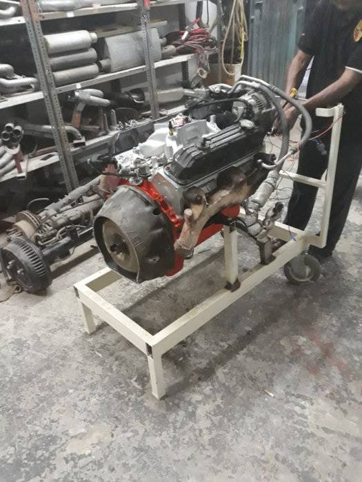

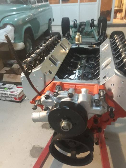

house made rotisserie jacks are more expensive than iron:) here is my little toy 360 magnum aluminium heads and over bored to 020 roller rockers too
fighter
Dec 6, 2011
59
11
qatar
I know I had to cut the bellhousing I was crazy soon to start it
