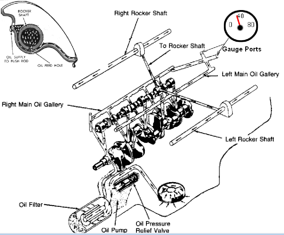

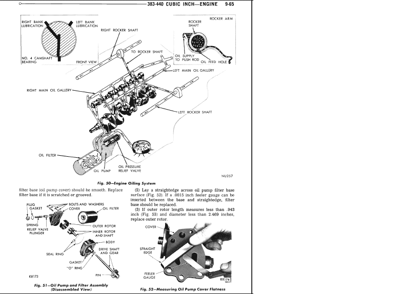

the rocker shafts are pulse fed through the cam so if you rotate the engine slowly while running the drill on the oil pump you may get oil fed up to the rocker shafts , , if the cam brg rotated it can bloc off the flow .
Reading your post It implies you had it running already.Remove rocker shafts As Chryco Psyoco said.The cam has to be in two different positions to feed each side separately. turn crank by hand with some oil pressure until you find them. If you don't get oil there is a blockage.Use an engine cleaning brush or wire to check or clear blockage. Remember if you are probing for cam hole with wire or brush not to shear of a piece with the cam turning.Go slow.The black mark is TDC you can see how far from TDC you will find one of them. Oil filter obstructed?

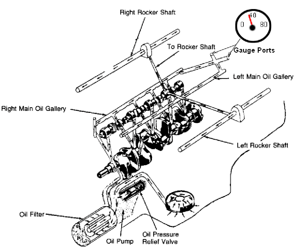

1) Do you have oil pressure at the gauge port?

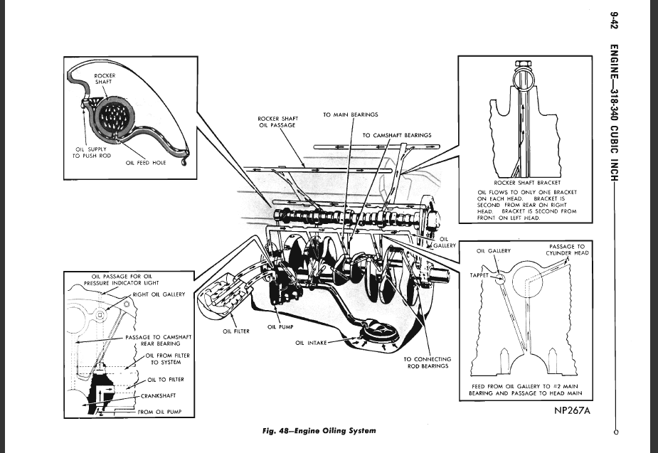

Challenger RTA posted the small block system. BB arteries are a bit different.

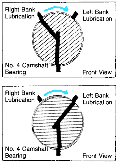

The rocker shafts feed through the #4 cam journal for both sides...........
As Cryco states, the oil feed pulses side to side with the cam rotation..

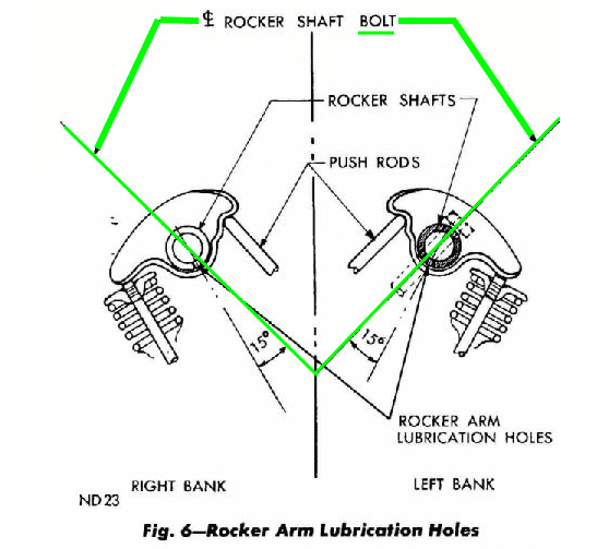

Rocker shaft oil feed.......
Stock rocker shaft oil feed holes for rockers are down and outward from the hold-down bolt CLs........

Thanks the images help a lot. I'll have to check the gauge port to be sure bout I don't think there is pressure there. Yes I had the engine running fine last fall and it was fine when I shut it down, it has a new oil filter. I'll try rotating it tonight while I have the pump going and post back.

I have seen this happen before. Remove rocker shafts and prob with brush or wire.When the engine fires up it pushes anything (oil gunk dirt rust) to the top oil gallery.It's not a straight shot and gets smaller. Drill was running 2-3 seconds before video started. Completely dry oil system. //Remember it has to be clocked correctly to get the oil!
