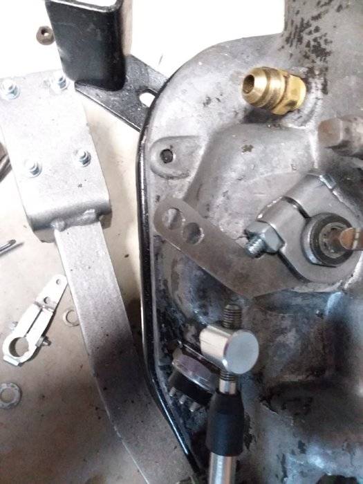

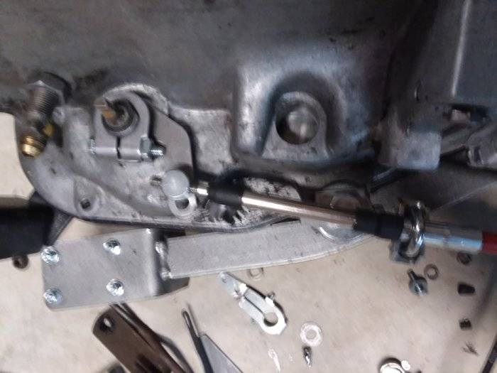

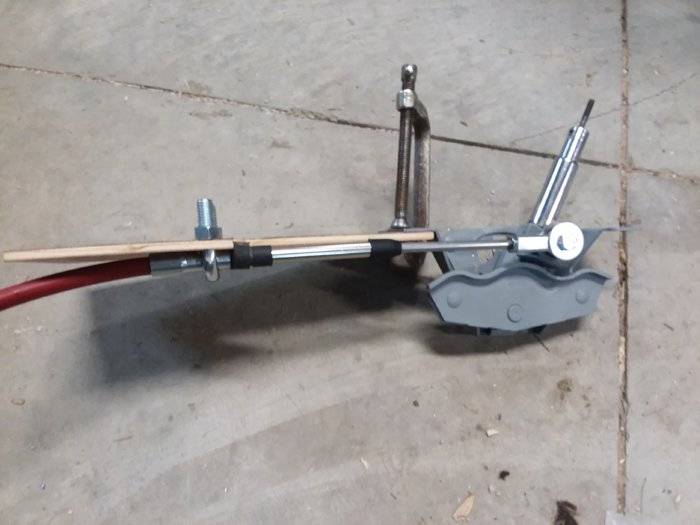

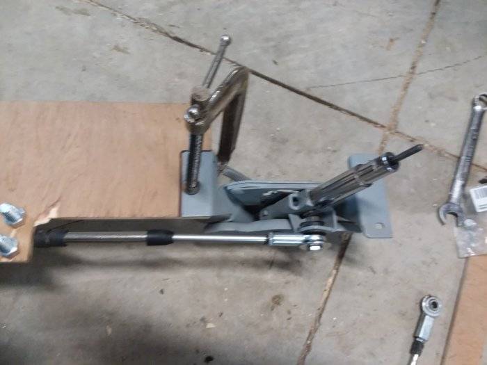

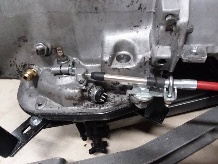

So this is a few pictures of my mock up. The first two are showing the shifter attached to a board to keep things stable while I tested things out. The others are the connection at the transmission. I used a cable and lower hardware kit from Turbo Action, plus a shift lever from B&M. Notice the hole drilled in the shift lever, I had to do that to get the ratio right with the shifter. Everything shifts into the correct detents now, but shifting it out of the park position takes some force.
The connection at the top is just a 1/4 inch heim end at the end of the cable. I still have to figure out how to tie the cable down behind the shifter in the car, but I think I can figure that out. On your application the shifter mount can be used like what I have done, but I have no idea how you are going to mount things at the transmission itself. Best of luck. I hope this helps.
