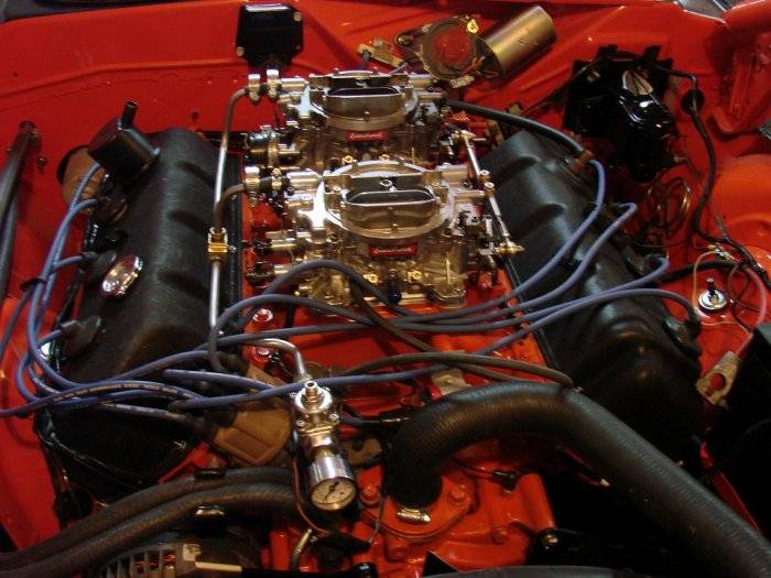

As long as I've got your attention, how did you get your oil cap clocked the right way, are those repop valve covers? Whats the story on the fuel pressure regulator up front? Is that a Stage V or a marine style dual quad intake?

I built the valvecovers myself from 69 covers. It's a Stage V intake. I hated the fuel pressure regulator up there, I changed it a couple of times. I ended up with the gauge coming off a t to the front carb with the gauge facing forward. The regulator kind of where it is but with two outlets (one feeding each carb). The Shaker makes fitting everything in tough. I built my own baseplate for the aircleaner too and that was also a tough job.

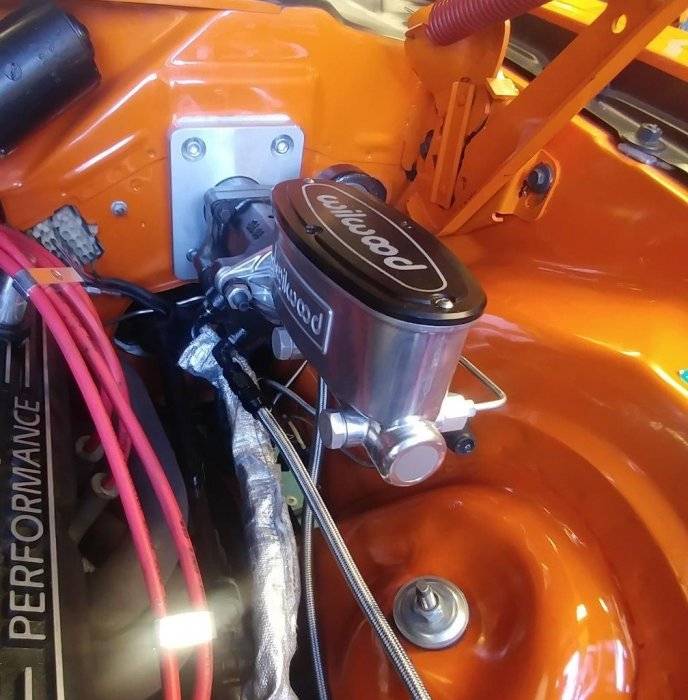

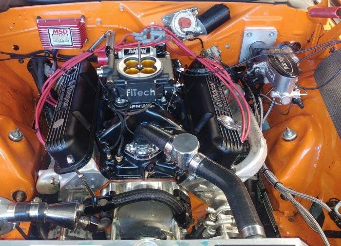

Theres always the hydroboost quite a slim fit running with kelsey front standard disk with 11" finned drum rear
