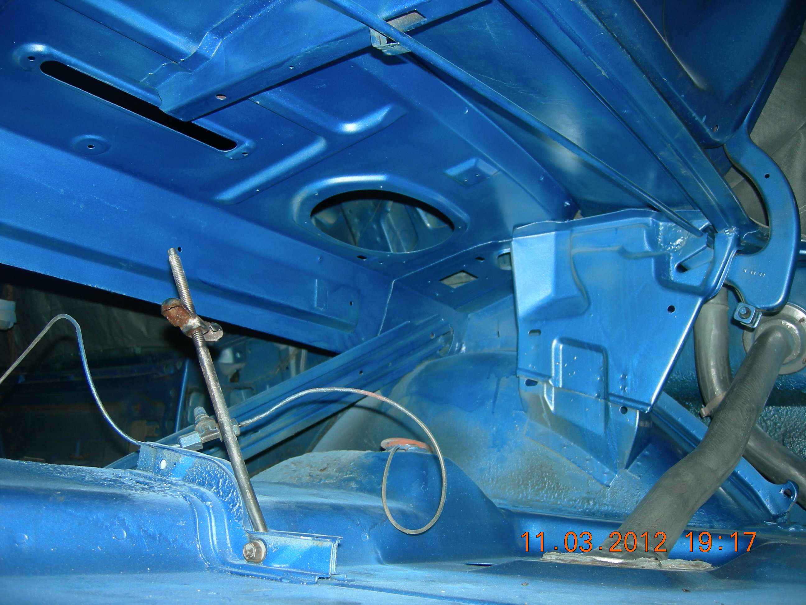

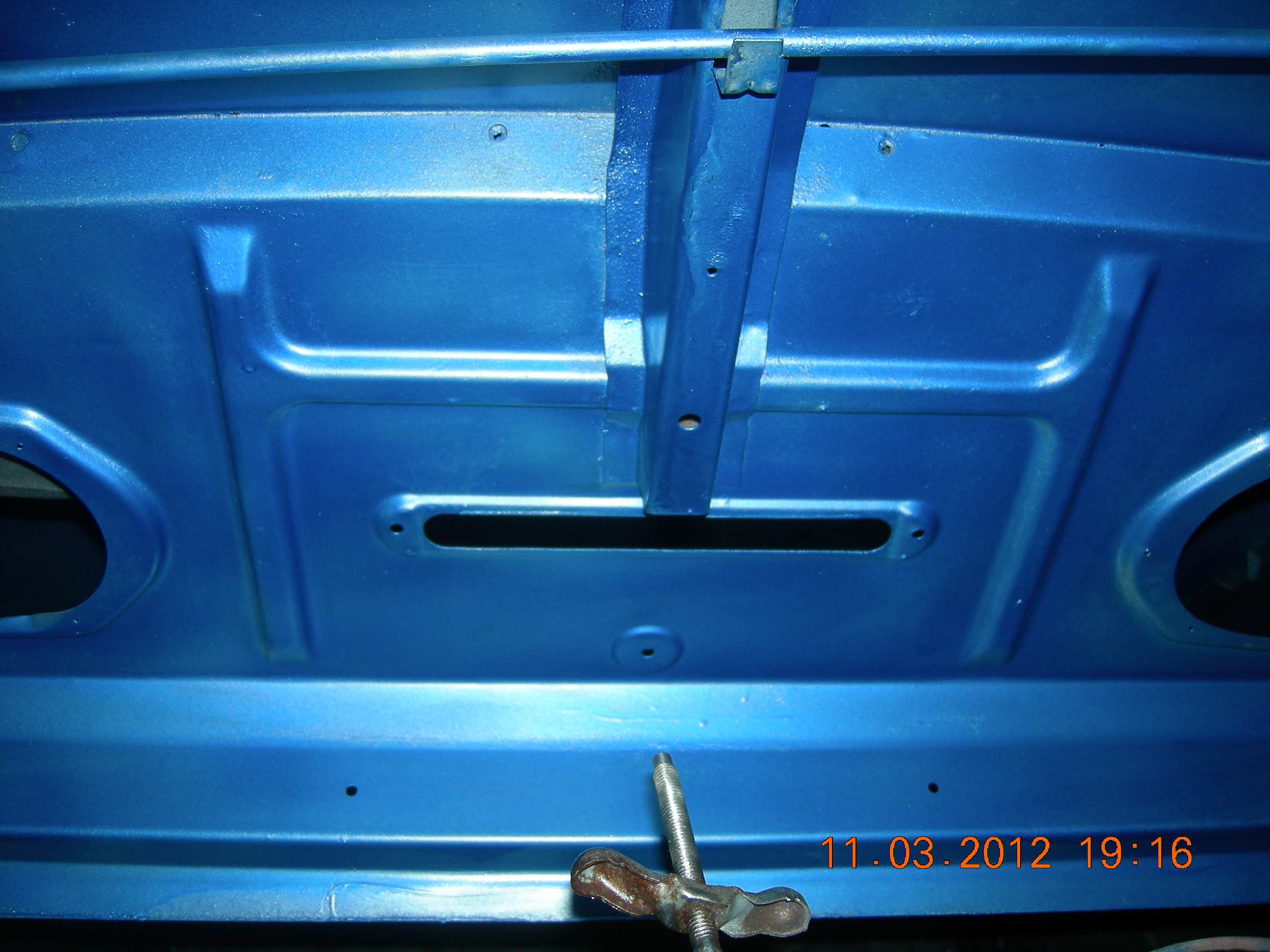

Working on my 71 and repairing a piece of the back flange. I note the rear flange on the package tray which spot welds to the upper trunk filler/dutchman panel has various large and small holes in it. Given that it welds behind the dutchman what are these holes used for? These appear to be factory.

This help. I would take a guess to say, there jig hole to line the piece when stamped or assembled. Not a clue.

The long thin one is for the rear window defroster. The motor fits in a speaker hole. That's how it was done before the electric tape was embeded in the window. The blower defroster was useless till car warmed up.
