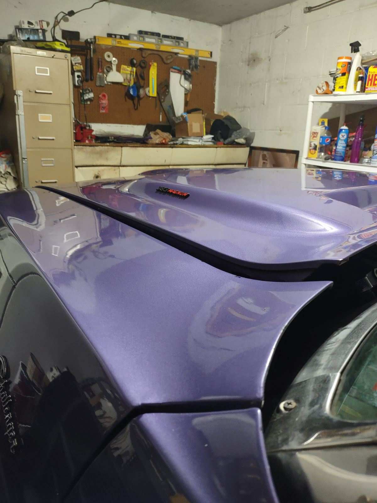

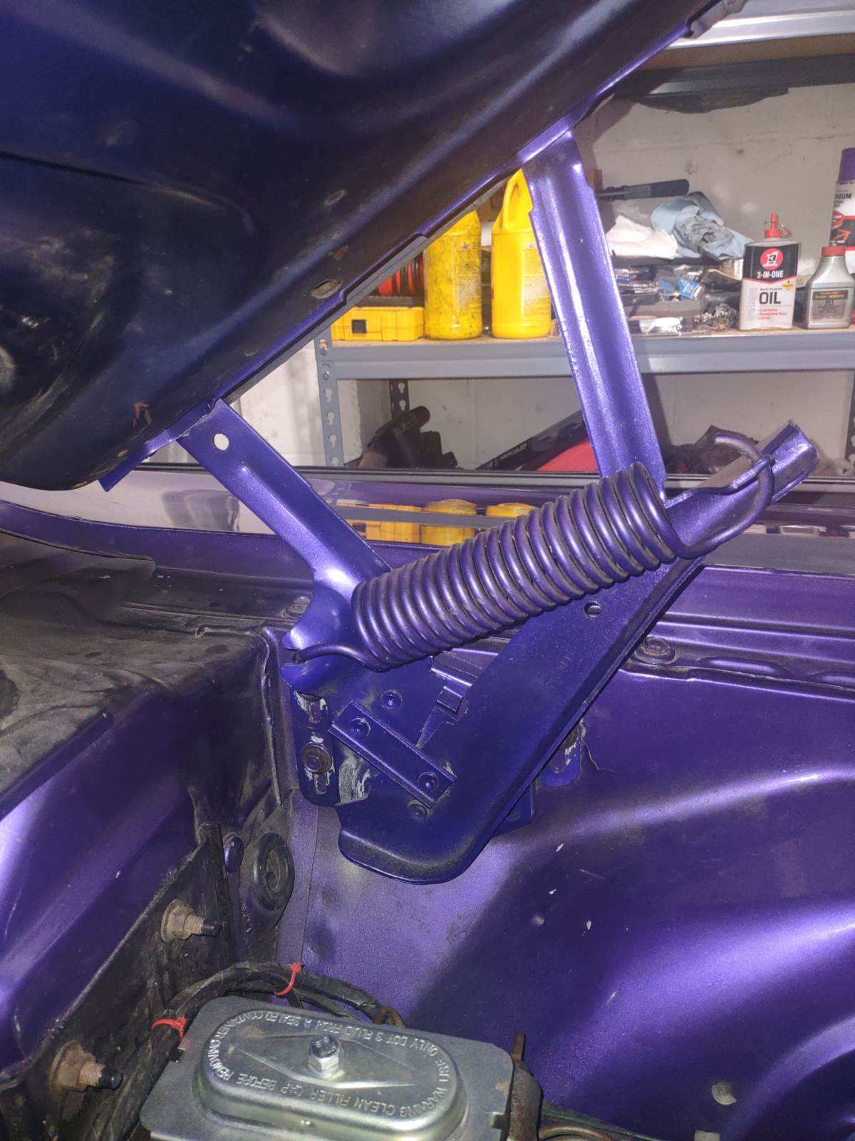

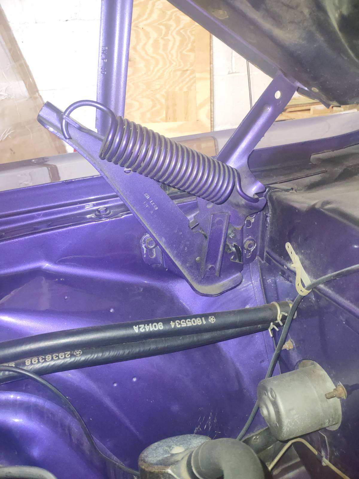

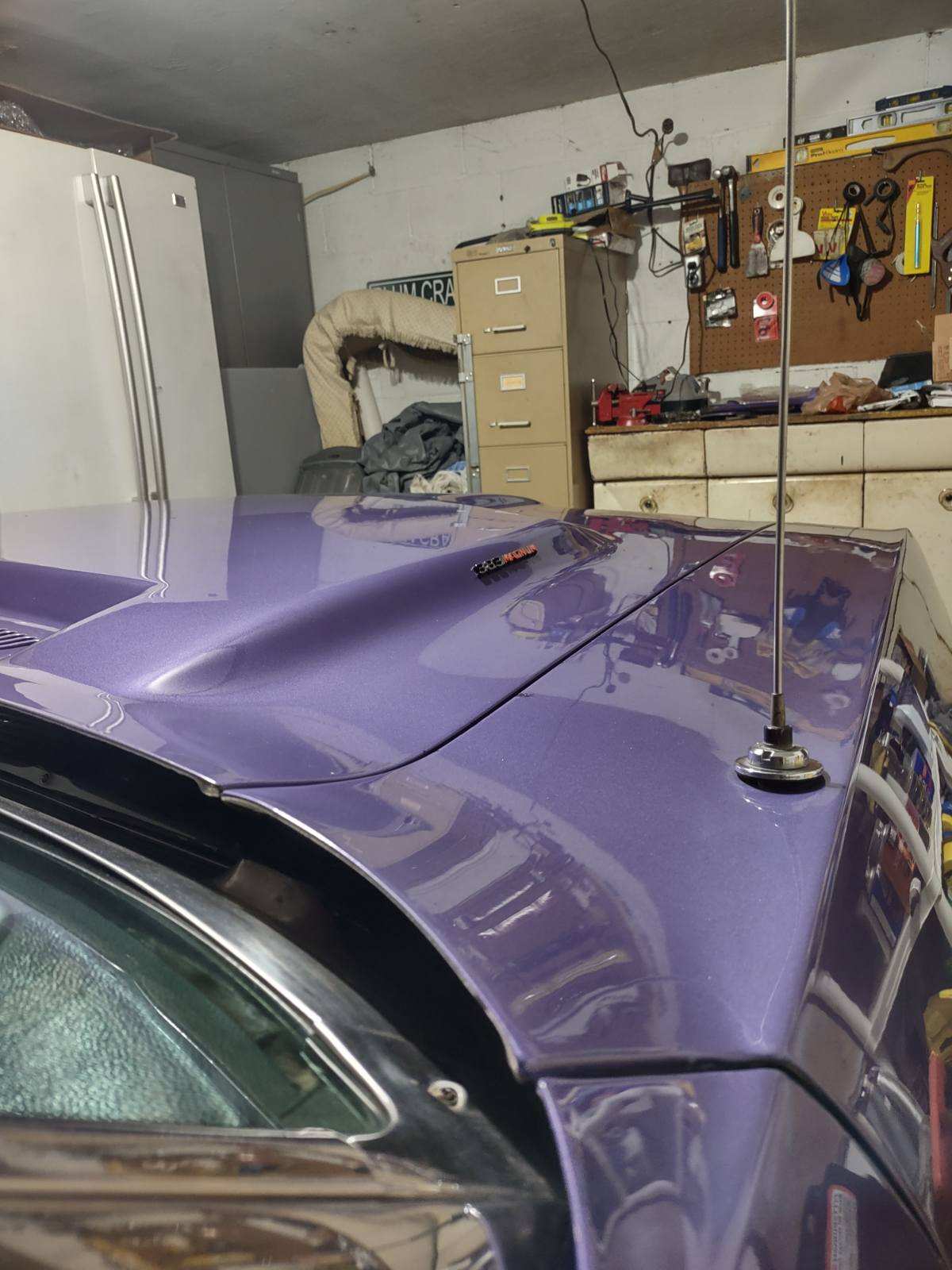

I have an issue with my driver's side sport hood on the rear near the hinge is not flush with the fender when the hood is closed. It's about 3/4" above the fender. I've tried adjusting it and have had no luck. I did notice that the stamped bar riveted in the middle of the driver's hinge is 3" long but the "good closing flush with the fender" passenger hinge has a bar that is 4" long. Not sure if this is why I have the issue on the driver's side. The passenger side of the hood closes flush with the fender and there's no movement when the hood is latched which is perfect. Adversely, the driver's side of the hood in the rear near the hinge stays up about 3/4" above the fender when the hood is closed, and I have to push the rear of the hood down so that it is flush with the fender. When I'm driving and hit a bump, the rear of the hood eventually bumps up to that same 3/4" higher than the fender. It's very annoying. This driver's hinge was NOS when I bought it but I'm thinking it's not for a '70 Challenger sport hood? I've attached pictures of the hinges and of the hood closed from both sides for reference. The passenger side is fine but the driver's side is not. Any info would be helpful, thanks.

Hood hinges are adjusted the opposite of what you think. You raise the hinge to lower the hood. Also it looks like the driver hinge is mouted lower on the hood compared to the passenger side. That will also raise the hood.

Thanks. I tried that and the hood is still up 3/4" when closed. I can grab the rear of the hood on the driver's side and physically push it down flush with the fender and also pull it up to 3/4" above the fender level. When I try that on the passenger side I can't move the hood up or down, which is good. I'm thinking I have an incorrect hinge?

Your drivers hinge looks to be a 73-4 style. My micrometer eye notices that the front bolt flange looks suspiciously like a B body. Find the hinge i.d. chart and confirm.
Raising the front of the hinge only, lowers the rear of the hood.

There are people on this site that are in the opinion that these hinges do not wear out but they are mistaken. E body hoods are long and heavy. I too had the trouble with my hood lifting at the rear always needing to be pushed down after a drive. What really happens is the rivets wear out and enlarge the hole requiring a rebuild after 50 years of opening, closing, and being jostled. After having mine rebuilt, I could no longer push the hood down or pull it up once properly adjusted and closed.
One thing I noticed with your left side hinge is that the short angle bracket appears to be in a different position than the right side does. To me, it looks like someone made an attempt at rebuilding it and messed it up if that is possible. Maybe it is not correct for E body. Either way it does not look correct to me. I sold my Challenger so have nothing to compare it to.
