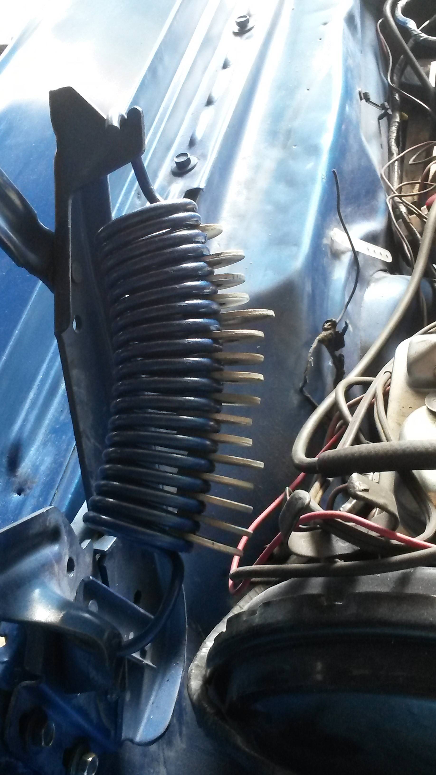

What is the best way to stretch the spring so I can attach if to hinge
Challenger RTA
Oct 28, 2018
4,274
2,311
PA Flood city
floor jack and washers.When you close the hood they all fall out.count them.
Adam
Dec 25, 2012
1,694
758
Washington
I hook the back part of the spring where it belongs, then use a rope, paracord, dog leash, etc to pull the other end towards the front. Might be easier with a friend.
heminut
873
723
Deming, New Mexico
I do the same thing, only I use a pair of vise grips locked TIGHT on the hook. I usually end up with a bruise on the top of my thigh a day or so later from the front edge of the front fender where I prop myself.

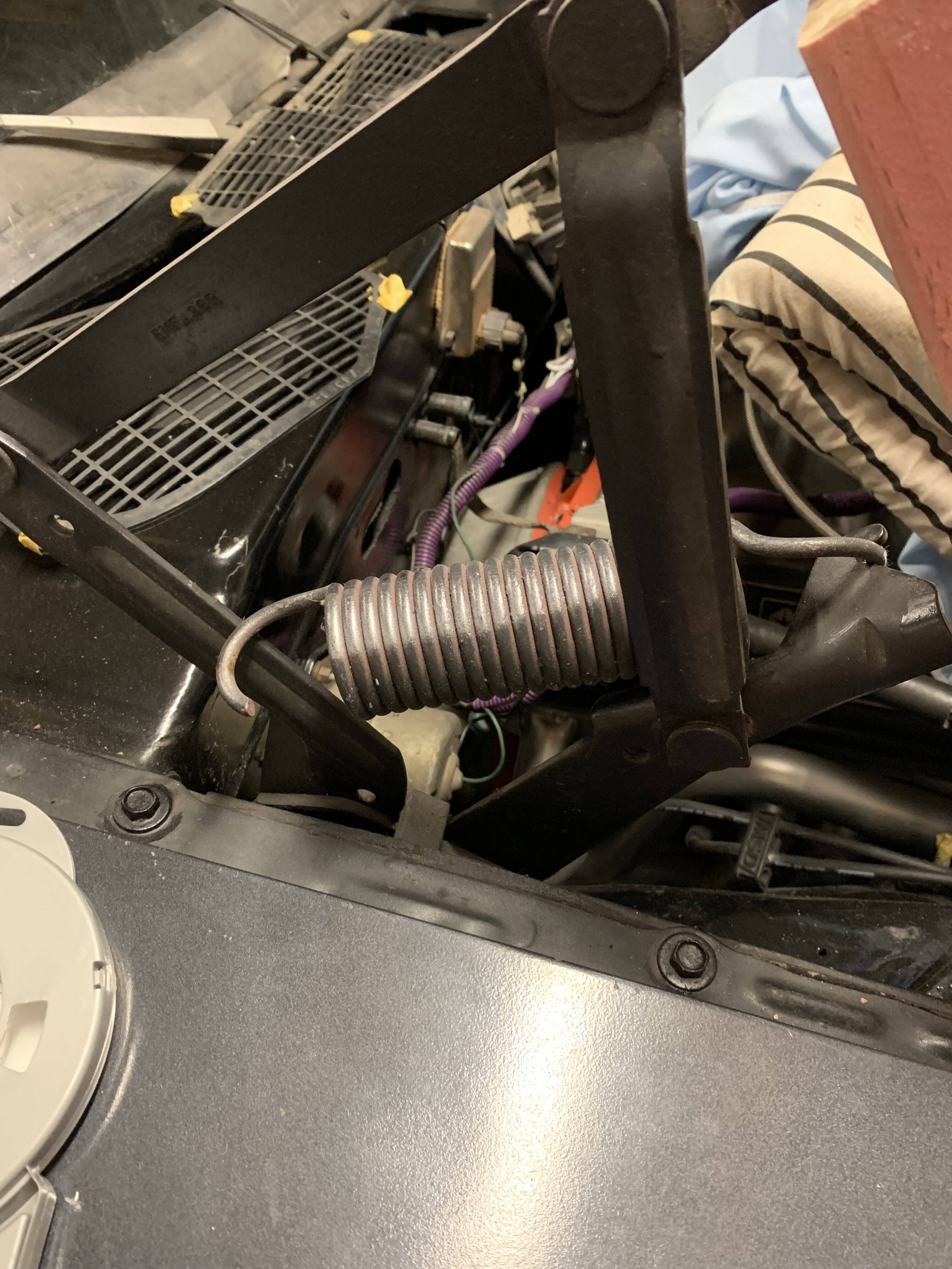

1970RTSE
Mar 18, 2019
21
15
Yes, am going to try it this way. Will wait till I have a helper as it seems a two man job. Only doing it as my challenger had a Fiberglass hood and I have located a mint steel one, I took the springs off with the fiberglass hood as didn’t want to put two much stress on the hood
