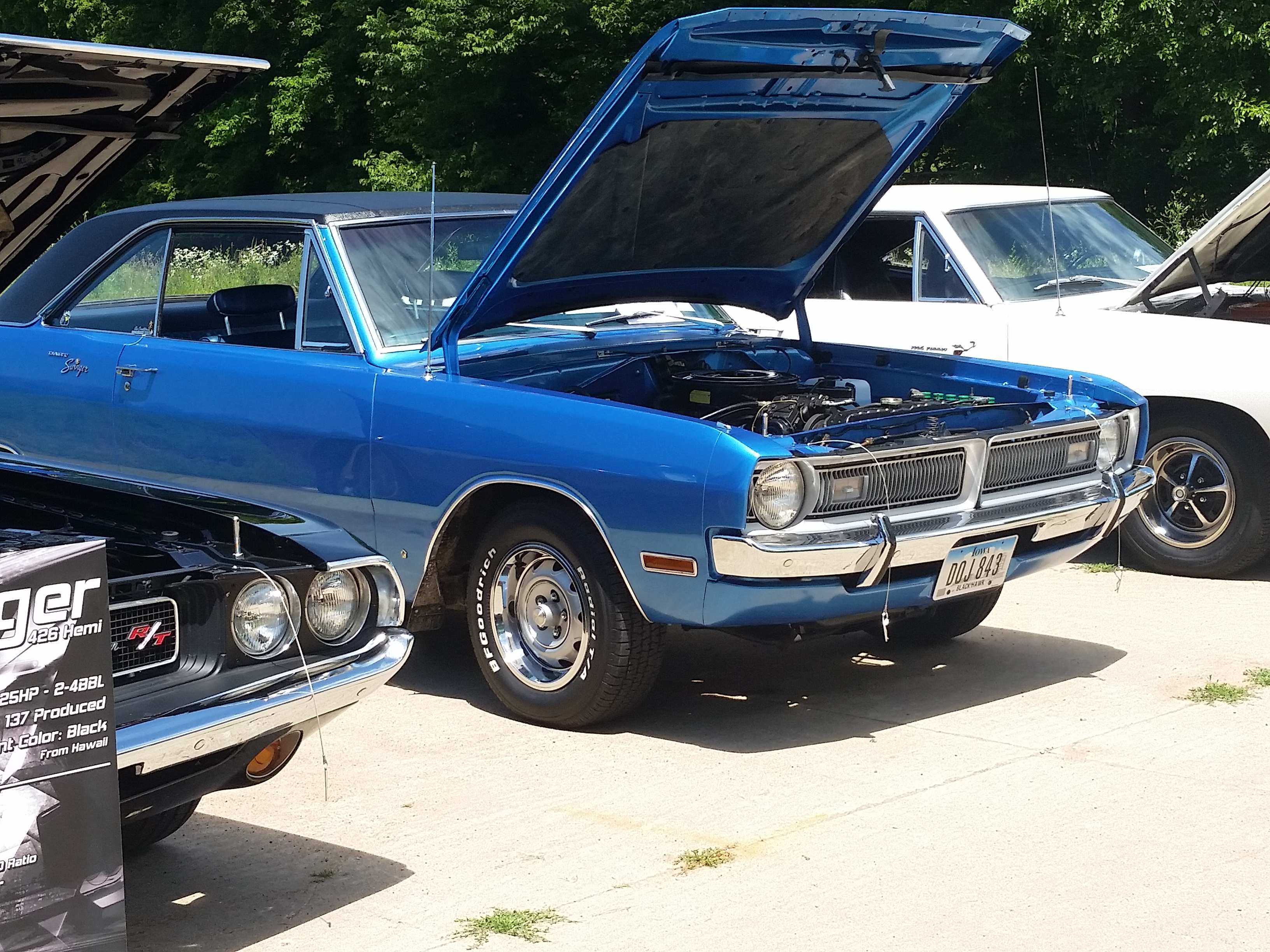

I went to Napa and bought some plastic "Christmas Trees" Mopar numbers of course. Way better than those original style clips that don't fit.

Sorry no. I don't think I ever wrote it down. They have packages on the hooks out front. Most would probably work but I chose the Mopar ones. Just pick out what you think will work.

Exactly what I found out. If your are restoring a 100 point car NOS or excellent used would be the way to go. If you just want to firmly attach and look nice the Christmas trees work and look fine. So many things have been changed on my car that some plastic clips won't hurt.
