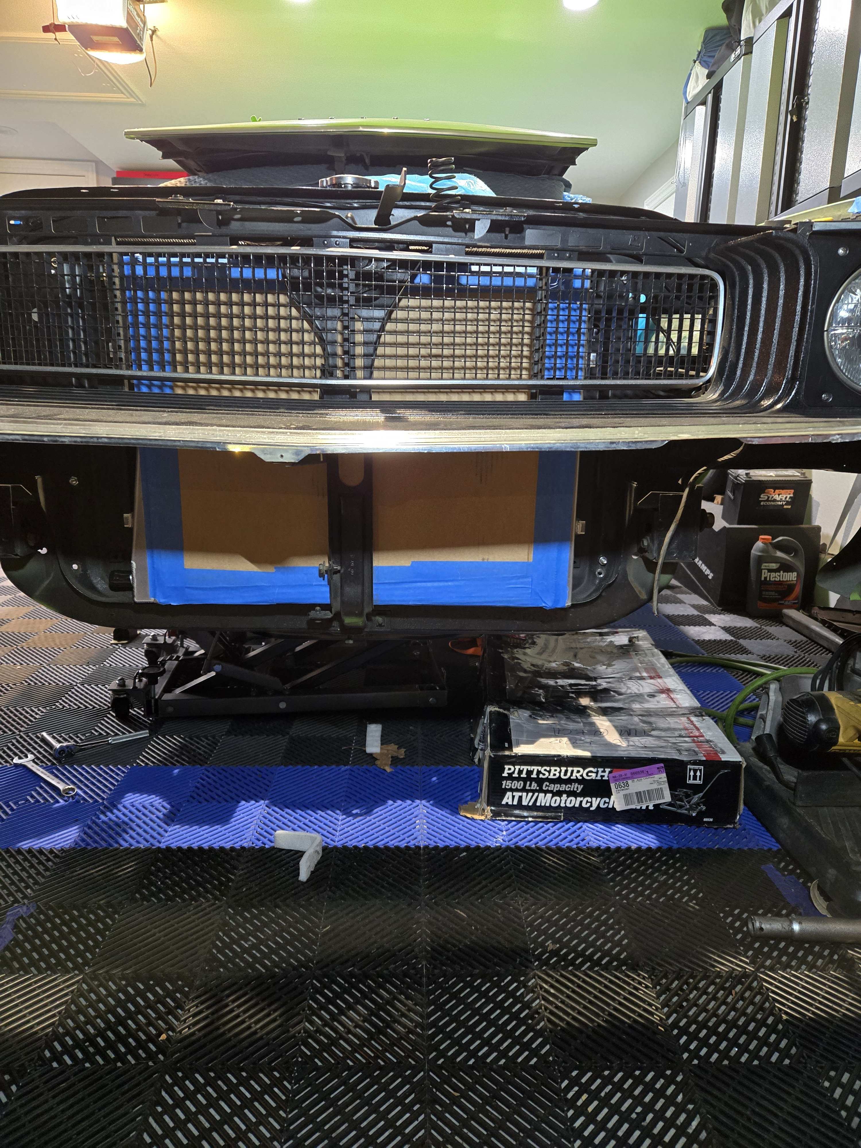

Hey all, is it ok to to use hood pins without a latch? I'm trying to make room for my condenser and heat exchanger for the supercharger. It would give me a lot more room switching to hood pins and no latch. I could remove the center bar behind the grill.
Thanks in advance.

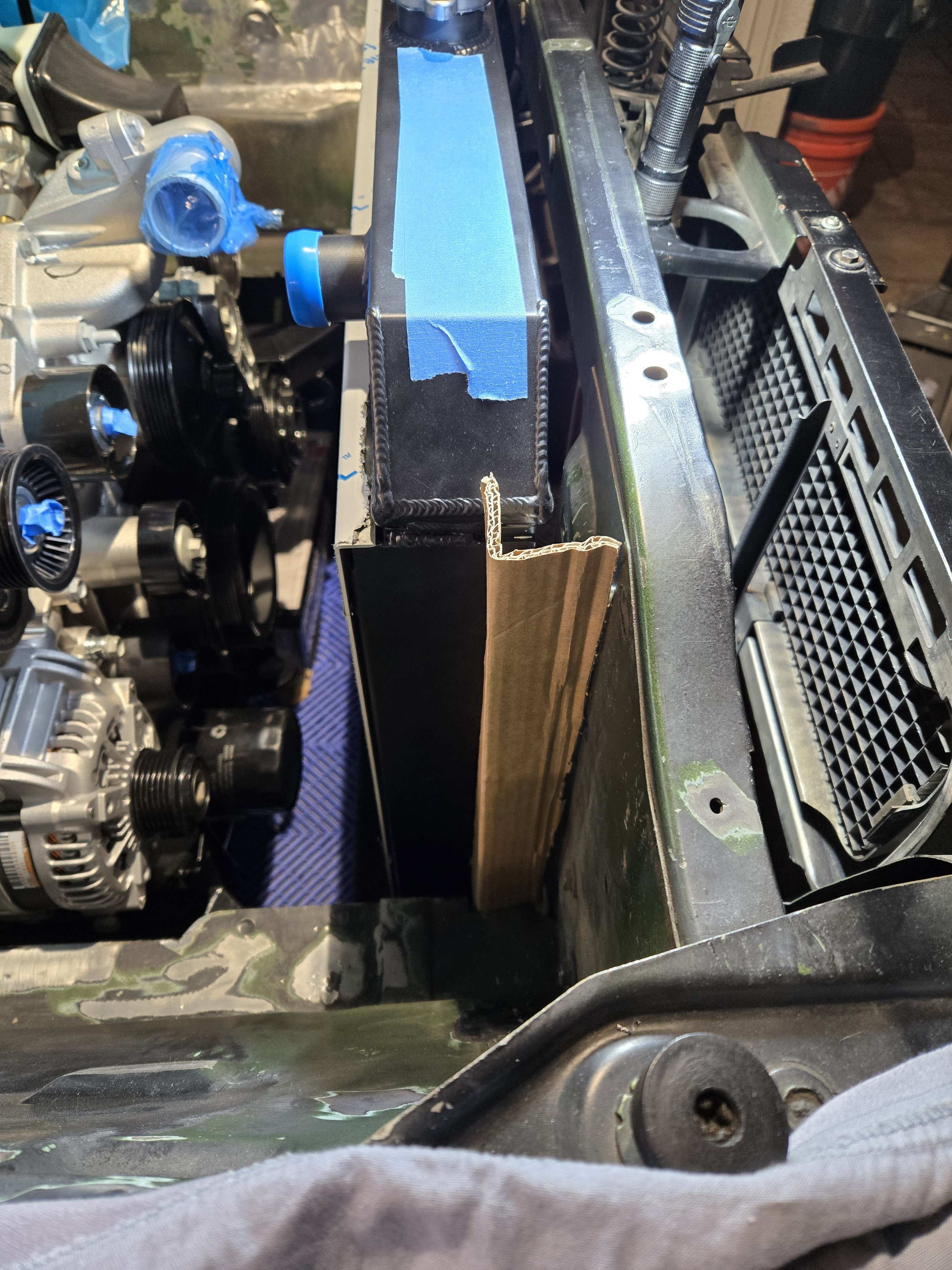

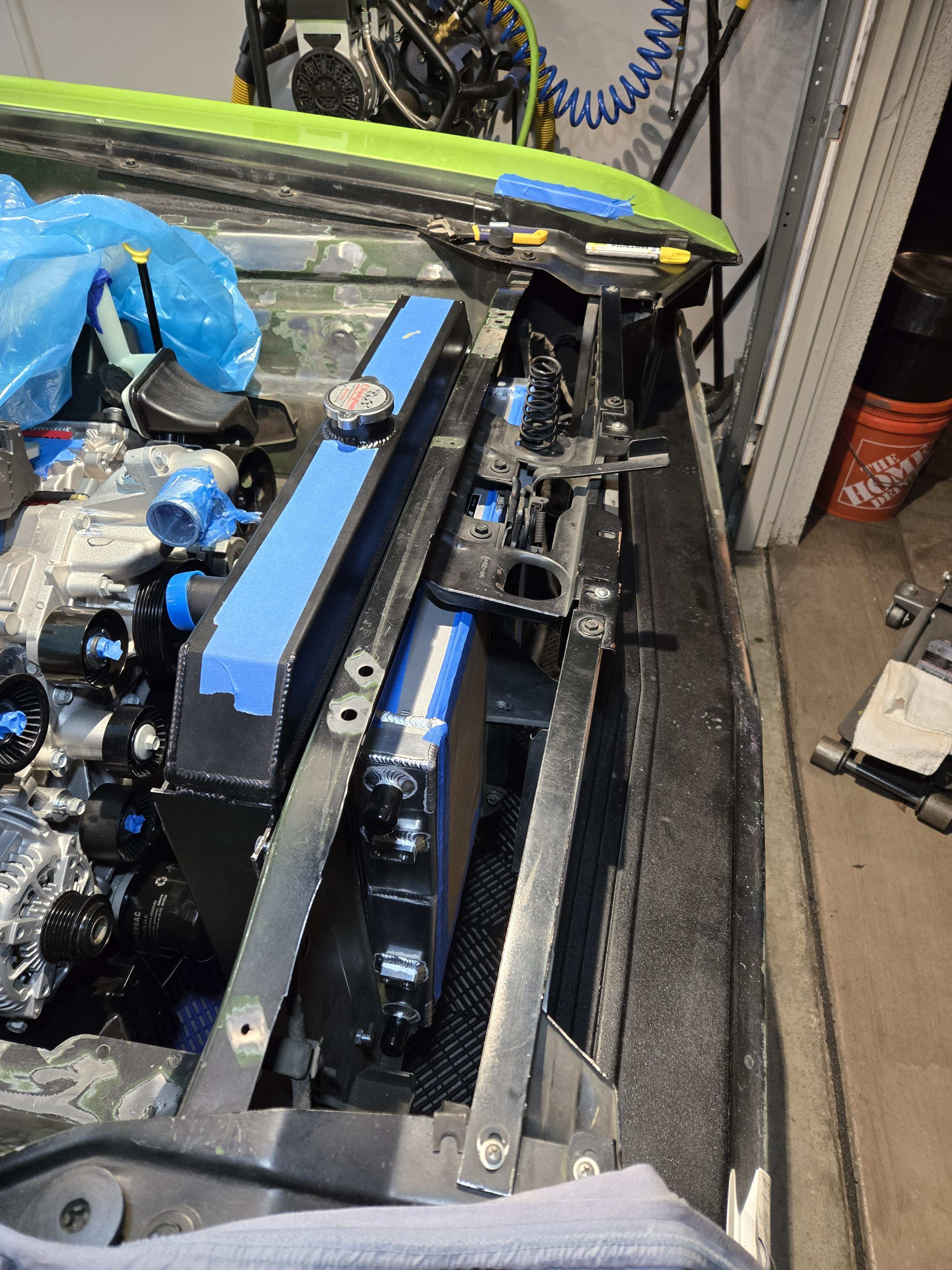

This is what I'm trying to package. With the middle support bar it pushes the radiator too far into the engine bay. I was going to use some angle iron to close the sides and mount the radiator to. But it just doesn't look that great to me. I definitely have the room but think it would look cleaner closer to the core support.

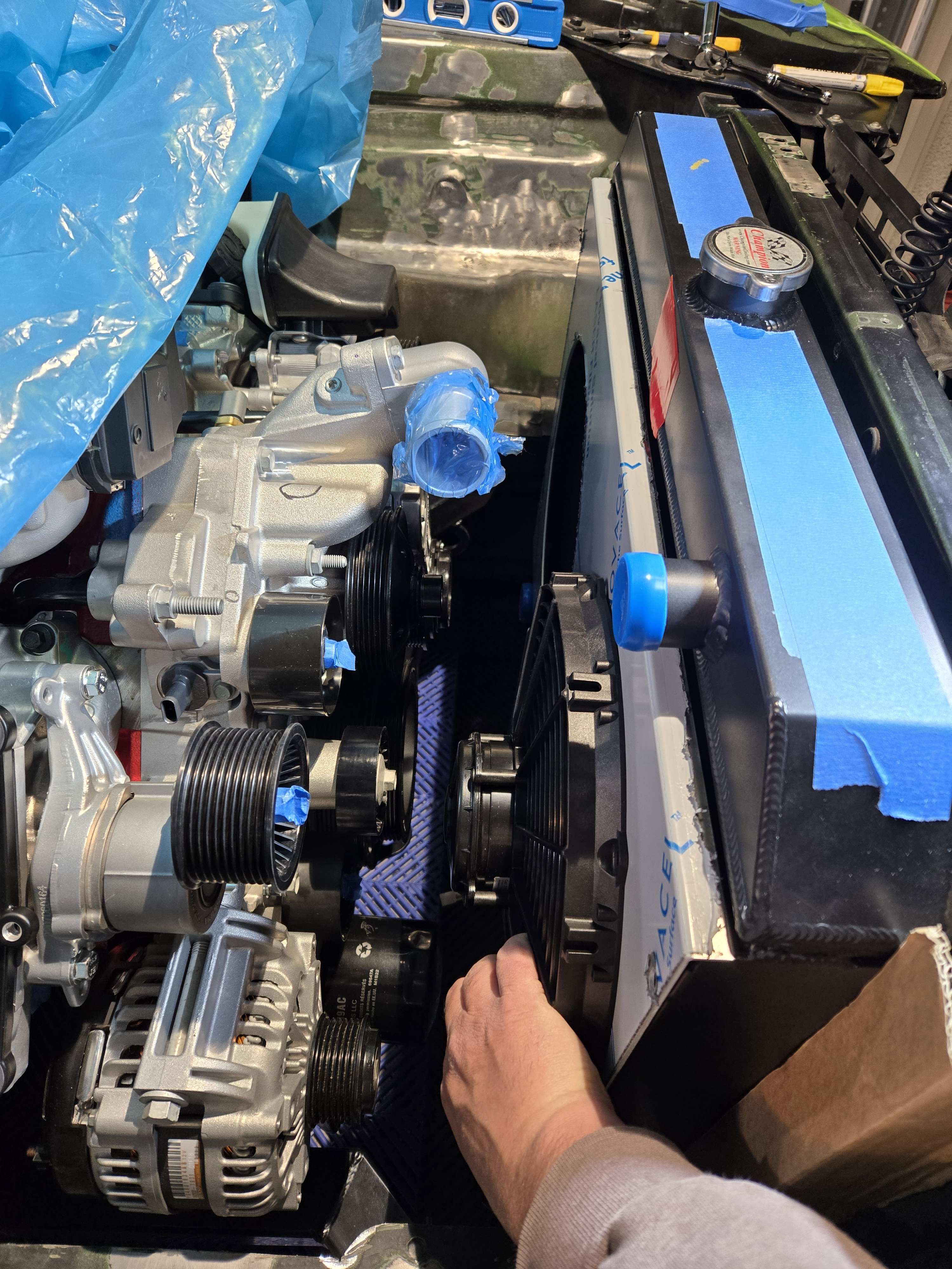

I removed the center support bar & latch after work today. As you can see it looks much nicer up against the core support. It also gives me better clearance for hose routing. I'll try to come up with something to add a little extra support to the front grill area since I had to remove the extension from the support bar.
