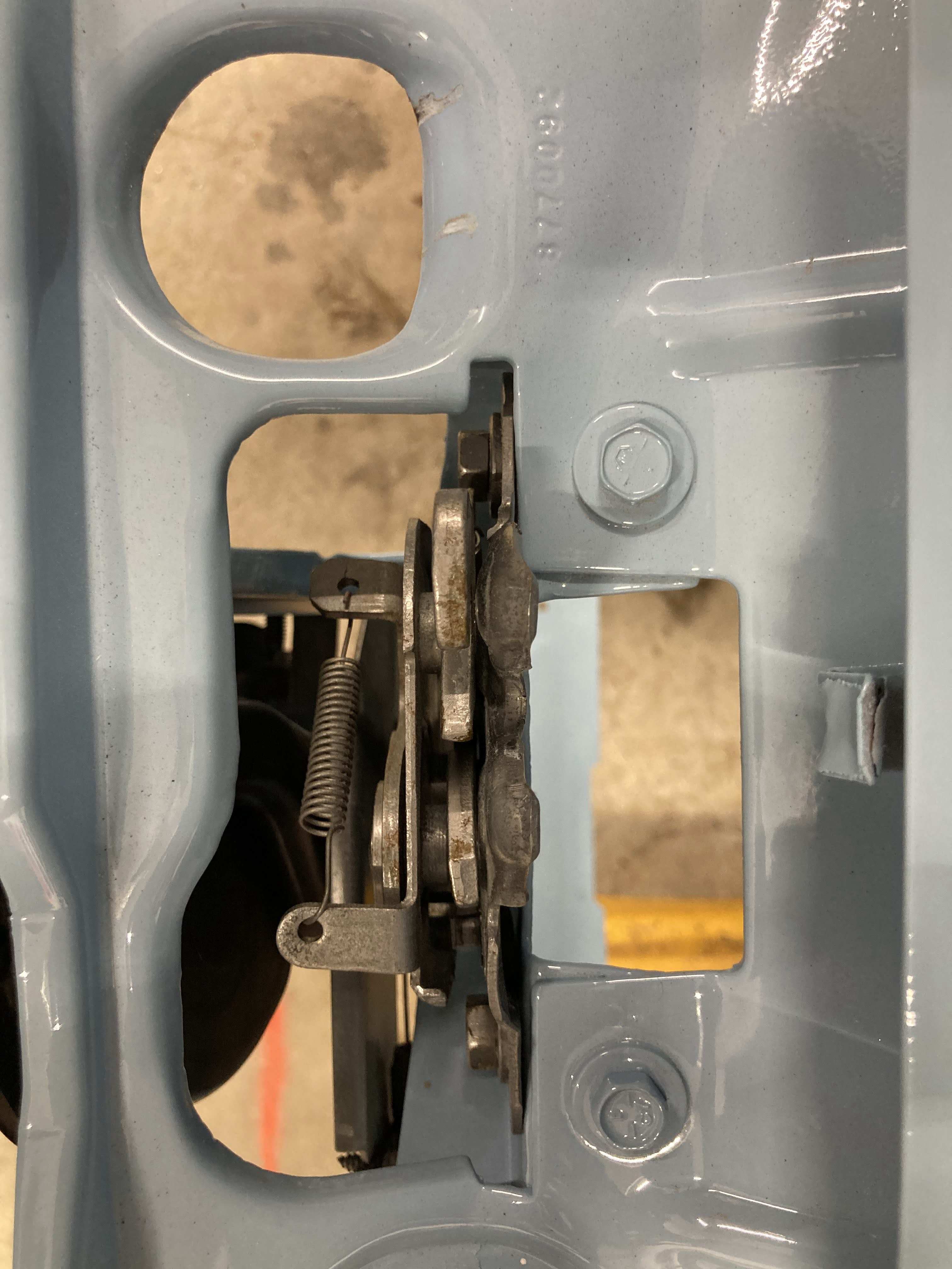

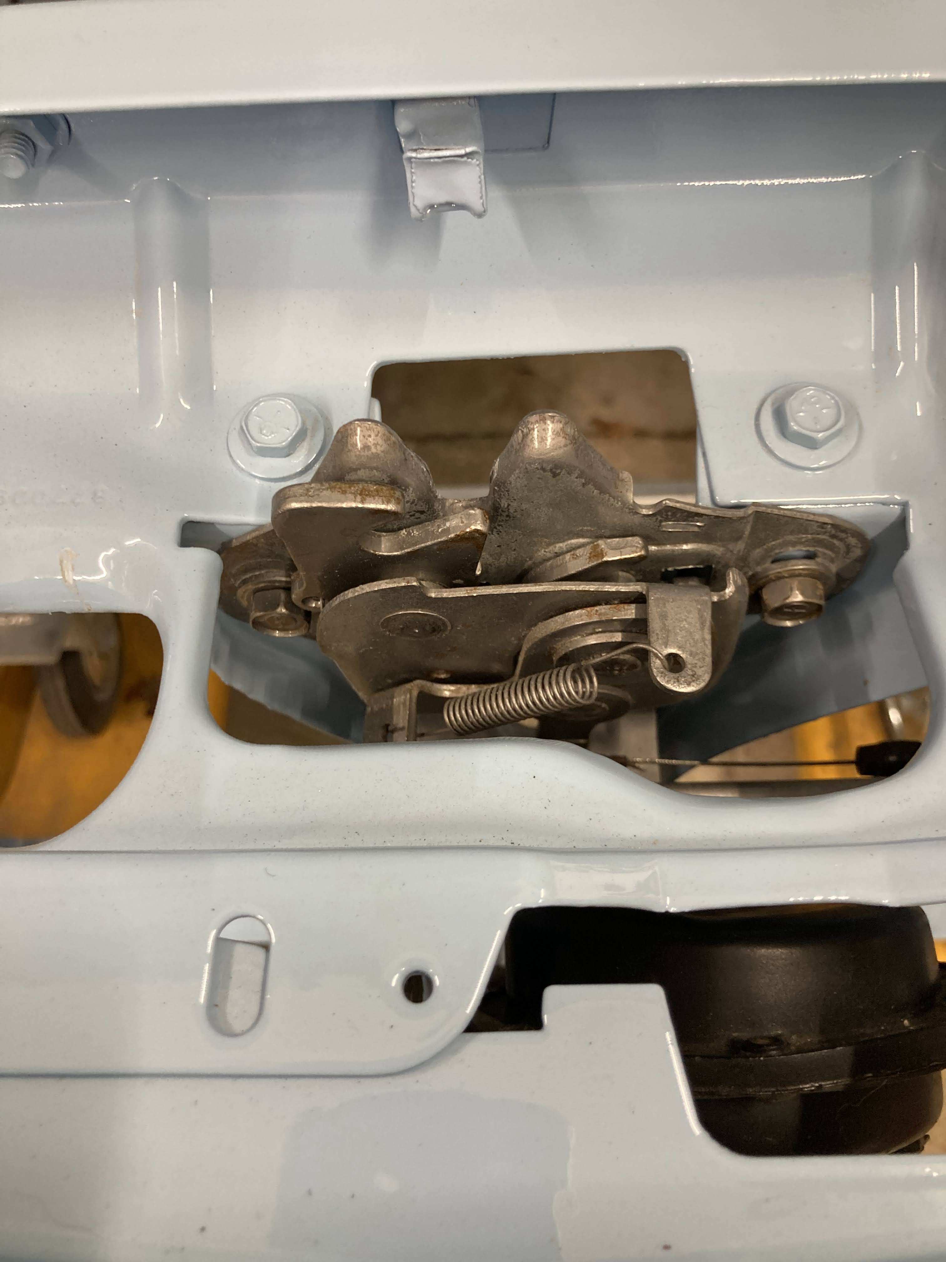

@JKCuda
Do you have the old latch assembly? The new one that you have looks to be a bit different than mine, I have a 73. Have you tried to put the spare striker into the latch to see if it will latch all the way? Is the front portion of the latch, where the spring is mounted, to high so that the striker will not go all the way down to allow the latch to fully close?
Also, like Challenger RTA asked about door gap, if your fenders and hood are back, towards the doors and cowl, the striker on the hood will be back which will put it forward in the latch, like you have. That will be a bit of work to adjust the whole front end sheetmetal but that may be the correct fix.
View attachment 119914View attachment 119915
I think I have the old latch assembly but I’ll have to look. I don’t think the latch is too high, the part that snaps over is hitting the radius but I can try lowering it to see if that gives it a little more room. Good idea.
Moving the hood and fenders forward could help, I will look into that this week.
Appreciate all of your input, truly. Haven’t gotten out to the car for a bit due to wife’s health but the weather is turning here and she’s itching to get in it so hopefully I can wrap some of this up this week.
