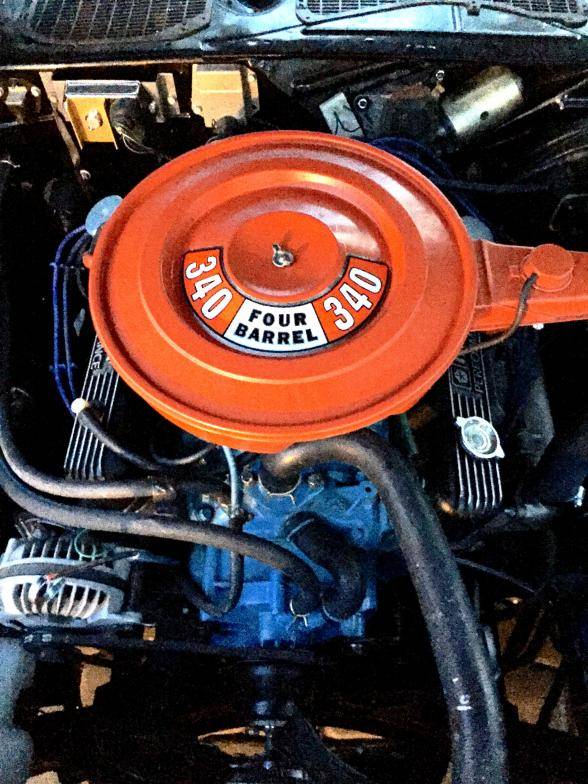

I am, it's got a mild cam, exhaust manifolds w/ a heat riser into the air cleaner... 340.jpg

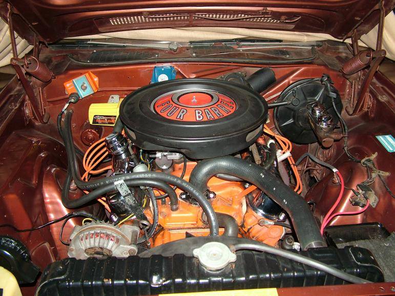

Me too in one of my two '71's. This is a matching numbers 340 auto car, unsilenced air cleaner. Currently under going a full restoration.

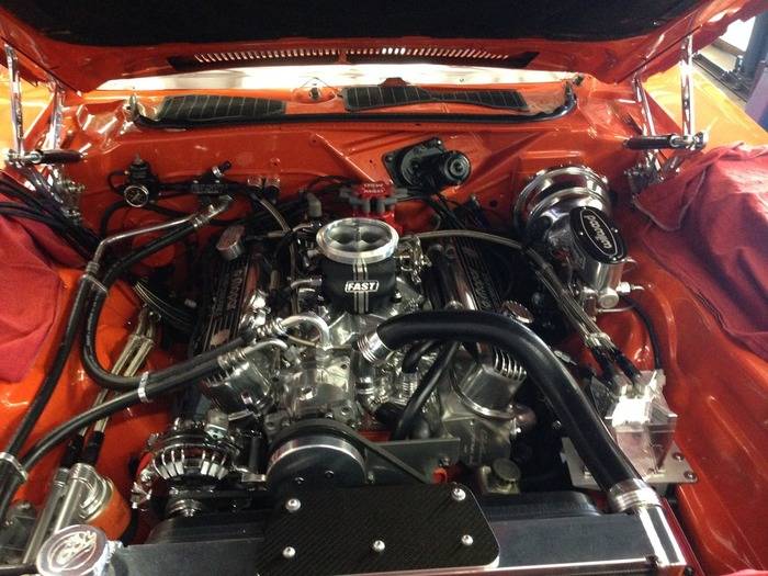

340 Based 408 Stroker....Love It!! Almost done installing the Fast EZ EFI 2.0....Its the perfect drivers car now!

that is a sick air cleaner cover!!! man that engine is clean...that would take me forever to keep shining!

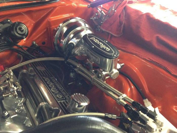

Thanks.....Here's an updated pic...Just about have the Fuel Injection done, Completed are...Electric Fan, HUrst Roll control mounted
on the master, Master/Booster Swap...The rest in in my Thread.

My 71 Challenger engine bay looks close to identical to the one in moparlee's picture. moparlee is yours a GK6 challenger? That's what's I own and mine's a 340/4sp.

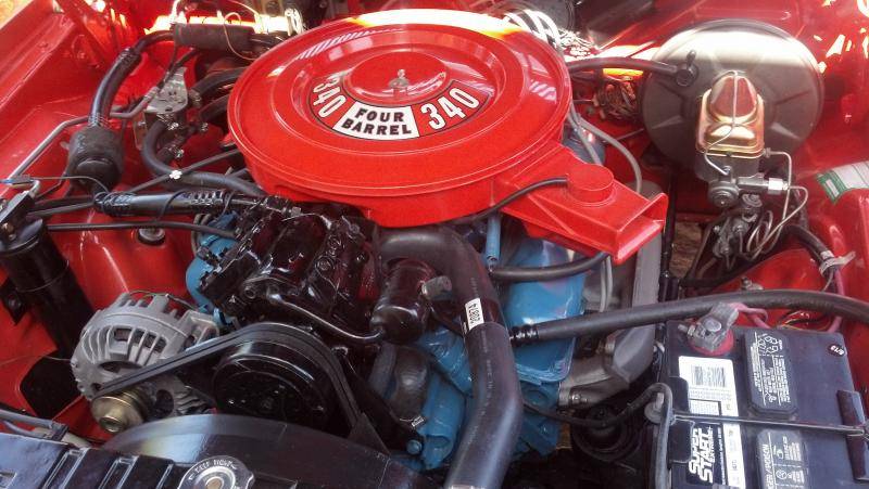

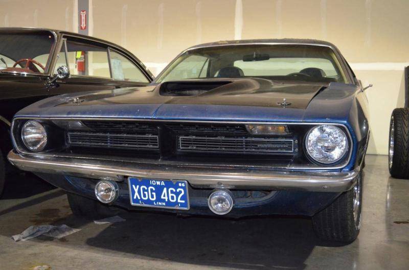

340 Stroked to 355 Ci X block makes over 600hp ALL of my Cuda are using 340's for power. (I am fortunate enough to have 3)
